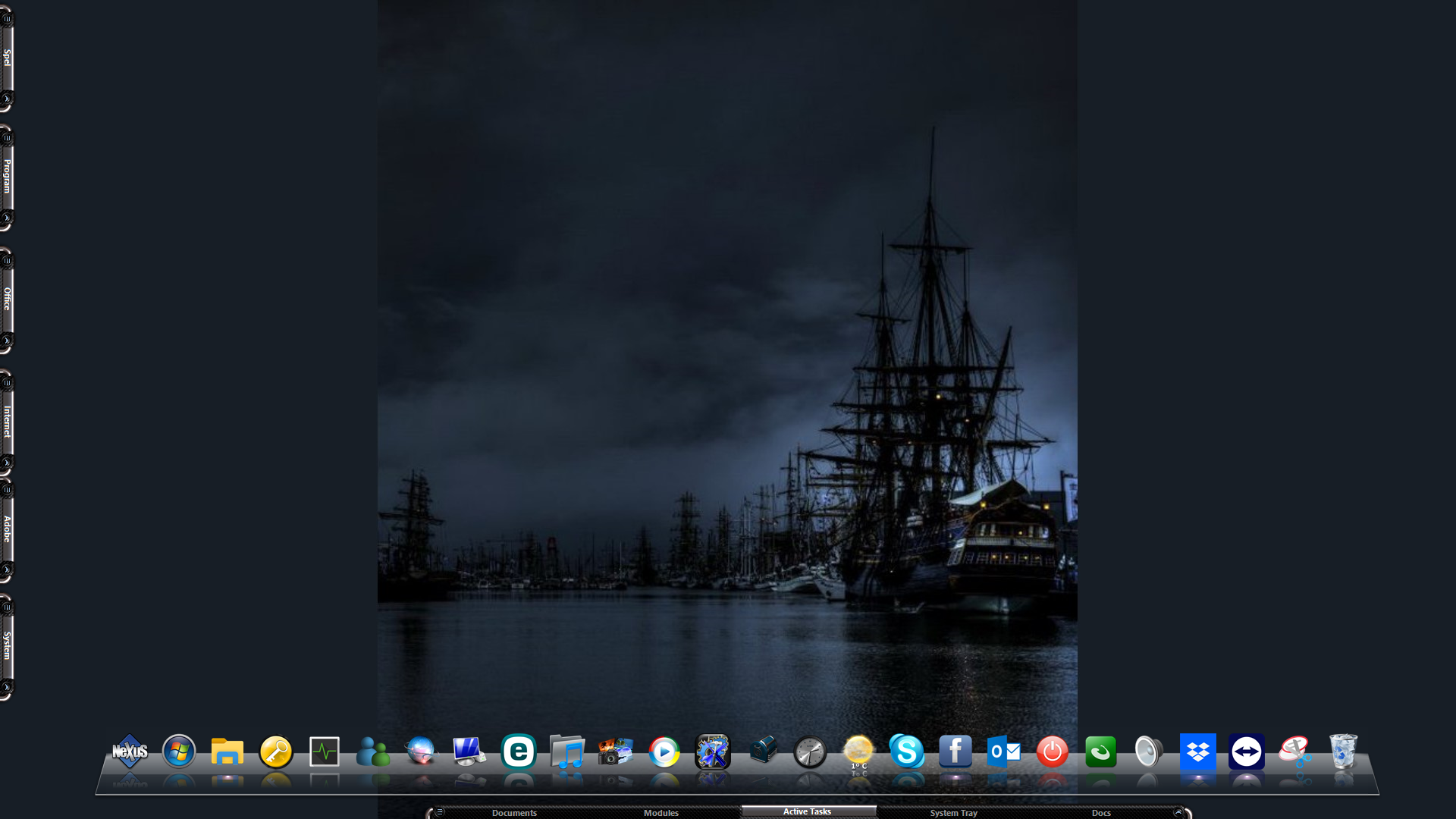

I have attached a pic of my setup at the moment.
bookie56
