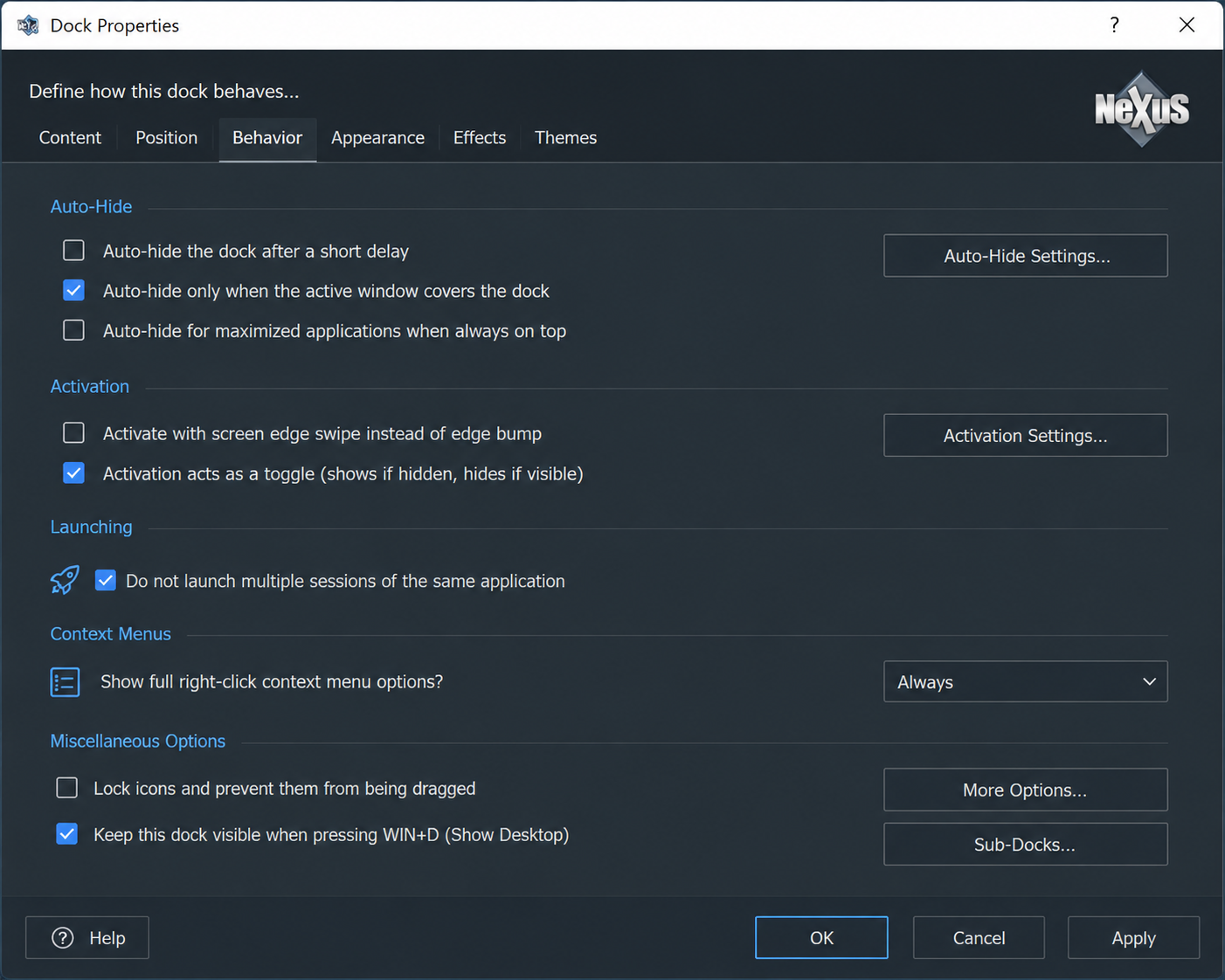

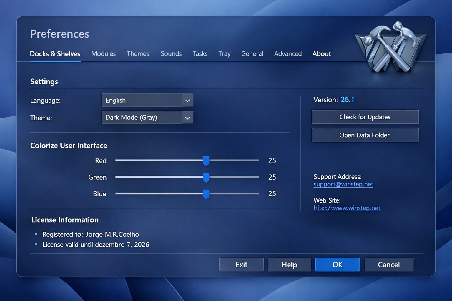

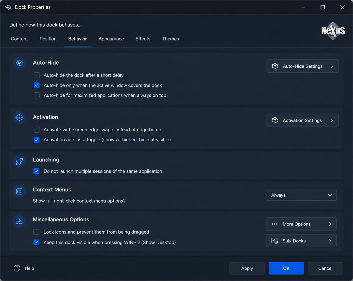

The AI suggested something like these three, but as you can see this makes Preferences HUGE (just like Windows 11 settings are HUGE these days):
There should also be a version with higher information density, but I can't get the AI to combine this with "modern UI style", it keeps giving me variations of the above two images. Anyway, I am not sure if the juice is worth the squeeze or even if something like this would be enough to satisfy those who are absolutely convinced that "new is always better" (even when it isn't).
