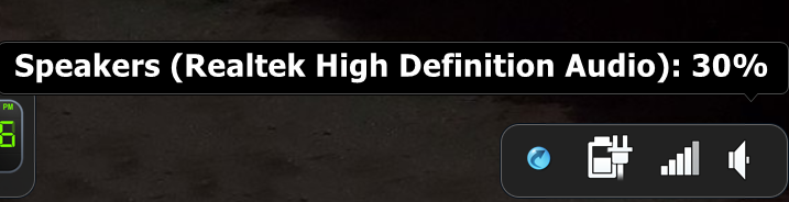

It is a Dock, not a Shelf. See attached screenshots.
One screenshot shows volume updated to 20%.
The other shows system tray dock hover label still reflecting 30%.
I'm not sure how else to better explain this. Listen Jorge, don't sweat this. It is a minor thing. Probably something corrupt within my PC.

PostPosted: Wed Sep 02, 2026 10:50 pm
Posts: 13366
No, something like that can be an indication of something more serious.
To be absolutely sure:
1. How are you reducing the volume?
2. If you stop hovering the volume tray icon (which makes the label disappear) and go back to it again, the wrong value remains?
3. if you press Mute instead of reducing the volume, does the icon show the red circle while the label keeps displaying the wrong value?
PostPosted: Wed Sep 02, 2026 11:09 pm
Posts: 71
1. How are you reducing the volume? Using both the keyboard keys for volume up and down and the volume slider in Windows (the one in my screenshot). Makes no difference.
2. If you stop hovering the volume tray icon (which makes the label disappear) and go back to it again, the wrong value remains? Yes, wrong value remains. I've tried that.
3. if you press Mute instead of reducing the volume, does the icon show the red circle while the label keeps displaying the wrong value? OK - this is interesting. Mute works fine - both the icon AND the hover label. Additionally, it also seems to force a refresh of the volume percentage. For example, if I change the volume from 30% to 20%, the hover label will still show 30%...BUT...if I turn mute on then off, it will then show 20%. This is so strange!
And again - this is issue only persists when I set the system tray dock to auto hide. That seems to mess with the refresh of the hover labels.
