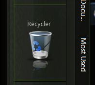

Probably never paid much attention to this before, but it really hit me earlier today. All in-shelf modules change with themes, except the clock. Any particular reason why this should be so? (None of my mods etc. are set locked.)
Are you sure the clock theme isn't locked? Can you post a screenshot of the clock module, please?
The clock changes just fine for me, is the Recycle Bin that does not change (locked theme or unlocked), the only change I see (in the shelf) is when you choose the style of Recycle Bin to be Recycler, I get the arrows from the Windows 7 Xtreme Theme Recycle Bin and when I choose the Recycle Bin option from style, I get the full Recycle Bin icon from Windows 7 Xtreme theme.
Also, the colorise option does not have any effect on in shelf modules.
PostPosted: Wed Jul 25, 2018 5:32 am
Posts: 159
Update to previous post:
Just made an attempt to change the recycler from a drawer and surprise: it is working. It is working in the drawer and also now, after that, it is working in the shelf. Go figure... :wink: :?:

PostPosted: Wed Jul 25, 2018 11:12 pm
Posts: 13630
Also, the colorize option does not have any effect on in shelf modules.
Sigh. This happens for two reasons: one because you're not understanding how modules work, second because the whole concept is rather confusing and not clear at all (lol).
A few lose concepts:
1. Each module has two different styles. What those styles are is arbitrary, it's just a way to have some variety to the default modules.
Which style is being used for a particular module is something that is ALWAYS set by the user, and cannot be changed by theme authors.
2. In-Shelf/In-Dock modules and Desktop modules are two VERY DIFFERENT beasts.
The first are essentially icons, even though they are dynamic (i.e; built on-the-fly) images. Because they are displayed the same way as the icons for all the other applications in a dock or Shelf and therefore can become as small as 16x16 pixel images, they are very limited in the amount of information they can display.
Desktop modules, on the other hand, are free form fixed size widgets (ignoring for the moment that you can actually scale them up and down). Being fixed size, the theme author is free to put as much information (text, etc) into them as it will fit.
Desktop modules are thus based on a fixed size background bitmap and may - or may not - also display inside them an image of the module in icon format. Also some modules allow the theme author to do that, other modules don't.
3. Desktop modules do NOT have a style, they only have one version. Only modules in icon format have two possible styles.
This is another thing that can induce confusion. For instance: most theme authors choose to the display the desktop clock module in analog format. Users get confused when they change they in-shelf/in-dock clock module to digital but the desktop clock module remains in analog format.
4. Another source of confusion can occur when the theme author decides to display the icon image of the module inside the desktop module. Because that image is an actual in-shelf/in-dock icon, it will already display in the currently selected style, thus giving the impression that desktop modules also have a style when they do not.
For instance, refer to Vectornut's post HERE.
The Recycle and Email Checker images (unlike the globe and ram sticks images in the RAM and Email Checker desktop modules) were not being colorized. Why? Because the former are actual in-shelf/in-dock icon images overlayed onto the desktop module background. So, the background got colorized but the icons did not (I changed that so the icons will also be colorized from now on according to the colorization settings of the desktop module).
The KTEK-4D theme author (Tiggz) in the example above could actually have chosen to use two different background images for the empty and full recycle bin states, and for the Mail/No Mail states of the Email Checker module, but he chose to display the actual icons instead.
Another problem with doing this is that if the user has a style other than the default selected for the recycle bin and the Email Checker, the image that shows up on those desktop modules is the green animated recycler and the rotating globe instead of his customized icons.
5. New modules are being added all the time (ahem, lol) so older themes will naturally not provide background bitmaps for desktop modules that did not exist at the time the theme was made.
When this happens, WorkShelf has no other option but to display that desktop module as a clone image of it's in-shelf/in-dock little brother (i.e.; as an icon, and in the style currently by the user). The only exception to this is the calendar module for obvious reasons.
Despite this, they are still desktop modules.
6. And this too can induce some confusion on the user, because if the desktop module is displaying the icon image (because the theme author did not provide a theme for that particular module) then changing the style actually works for that particular desktop module.
7. Despite being icons, the theme author has a limited ability to skin *parts* of the in-shelf/in-dock modules so they blend in with the their theme.
However, exactly what gets skinned depends of the module and the style of the module, as well as if the theme author provided alternate images/settings for those or not.
For instance, take the Recycle Bin: you have a static style and an animated style. Even though the theme author can provide an alternate animation for the second style, very few do. If the theme does not have an alternate animation for the second style, WorkShelf displays the default look of the animated recycle bin.
Same thing for the Email Checker module: the second style is a rotating globe animation - almost nobody is going to provide alternate animations for that even if they could.
Likewise, take the clock: theme authors normally only provide a static background for the in-shelf/in-dock analog clock style and change the colors of the clock hands, completely neglecting the digital clock style.
It's understandable, but what happens then is that some in-Shelf/in-Dock modules change when you switch to a different theme, other don't, sometimes they change when you switch to another theme (if the theme has alternate bitmaps), sometimes they don't (if the theme does not have alternate bitmaps for that particular module/style), which can also be a bit confusing.
8. Colorization settings for modules are restricted to desktop modules only. They are NOT meant to colorize the icon version of those modules.
So, when the desktop module is showing the icon version because that particular theme does not have bitmaps for that module, the icon image is not colorized either, which can lead to further confusion.
I am thinking that perhaps I should always colorize the desktop module even if it is displaying the icon image - the drawback of this is that it can have some performance implications if the desktop module is constantly being updated (the rotating globe for the Email Checker module, for instance).
