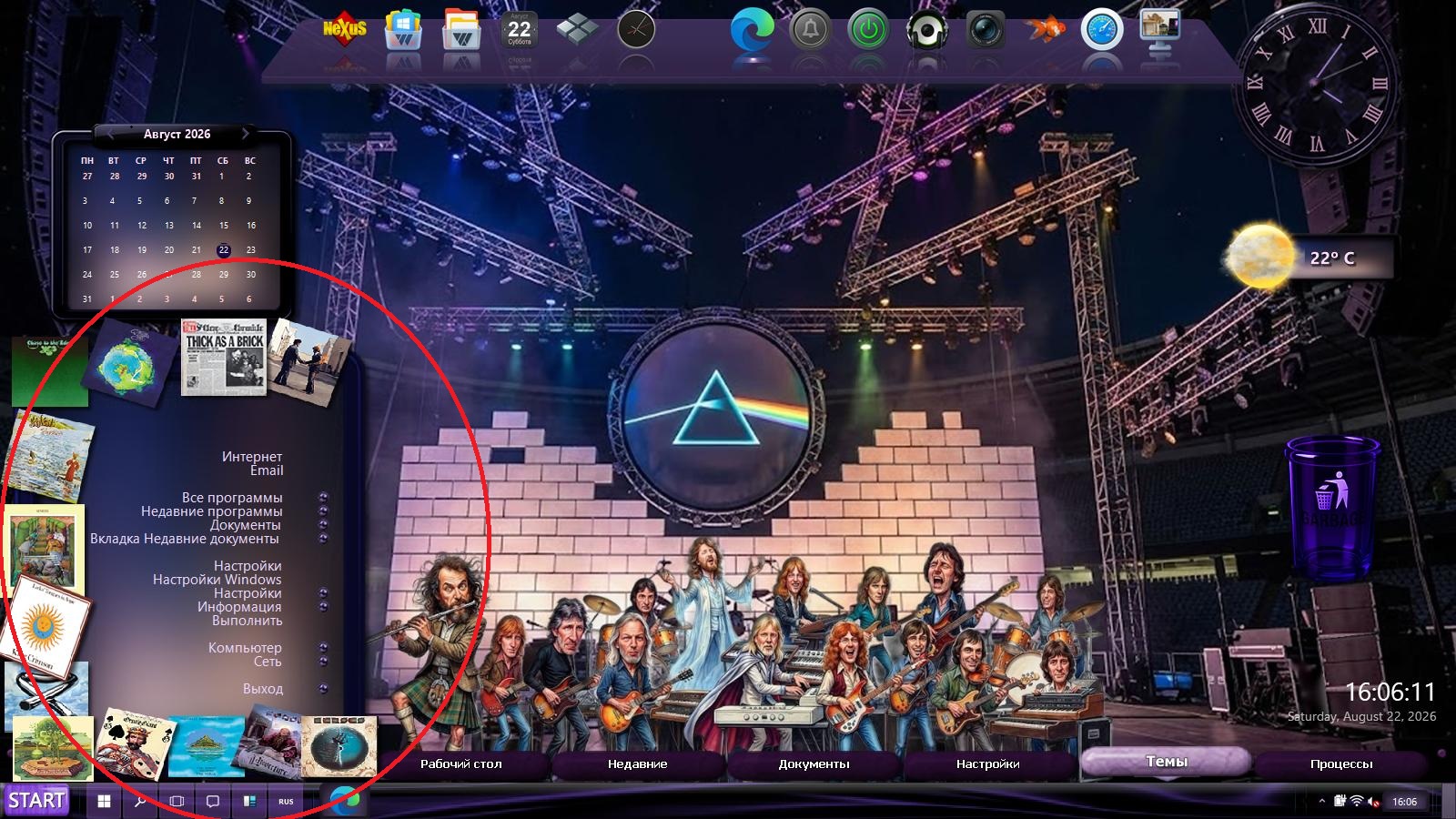

Respected Jorge Coelho Good evening! I'm going to ask a stupid question too. Is it possible to change the size of the Start menu in the future? More or less? (Perhaps this question has already been asked on the forum.)

I know you asked Jorge, but the issue is the skinner and in the screenshot, that is on me. The physical size of that particular menu is because the album covers shrunk to such a small size became completely unreadable any smaller. So consequently, this means the actual menu size became bigger to accommodate the covers surrounding the edges of the menu.
If I made them smaller, they would have looked like blotches of color added as an afterthought, so blame me.

Respected BassdudeNZ! I think the Start menu has a minimum size right now. Can it be increased? Create a changing size? As in Windows (use the arrow to resize the Start menu). There was the Aston program, the original replacement for the standard Explorer desktop shell for Windows. This does not work in Windows 11. There were many interesting topics in this project. But the project was closed. Winstep Xtreme is a very interesting program! And it is constantly being updated! Many thanks to Jorge Coelho for creating this program! And thank you so much for your topics! I think Windows looks much more interesting! (This is my personal opinion!)
Jorge is the Guru here with what windows can and cannot do. He knows more about Windows changes, what works, what won't work , much more than I have had hot breakfasts :) I am just a skinner - well, I am more than that, but as far as Winstep goes, that is accurate enough.
