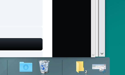

By the way, I was just wondering if it's possible to make the window limit to be the dock except when the window is in full screen. just like in macOS
File comment: Something like this

Nikolas wrote:
WOW, when's the new update coming!?
Go to the Advanced tab in Preferences, enable 'Notify me of beta (test) versions' then click the 'Check for Updates' button.
Also, read THIS POST. I think I haven't fully cracked it yet after all, but you be the judge - reply to that thread please. :)
Open the dock's Properties panel, go to the Position tab and enable 'Prevent maximized windows from overlapping the dock'.
Note that normal, non-maximized, windows can still be made to overlap the dock. That is normal behavior under Windows since you can make them overlap the Windows taskbar too.
That's kind of the opposite of what I was thinking, but thanks anyway :o
