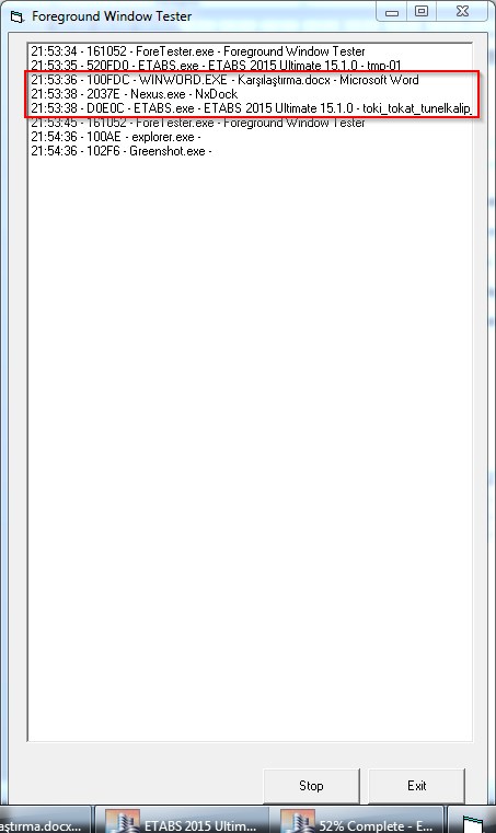

I have uploaded a screenshot of foreground tester which shows the issue. "MS Word" was on focus and I wanted the switch to "ETABS". After left click, ETABS gets the focus for a very short time and suddenly Word gets the focus again. I didn't clicked on Nexus.
Weird thing is, foretester does not show Word's "second focus".

I'm having the same problem. I ran the software (had to shut off my antivirus and firewall for it to run) and it showed that whether it be my browser, Windows Explorer or any other program, it didn't matter.
As soon as I click on something, the focus immediately switches to another program that is open. As the OP has said, it doesn't happen every time.
Apologies for the late reply too.
Perhaps because the window was not really the active window. When you say 'got focus' what really happened? What did you see?
Anyway, what worries me is Nexus showing up between Word and ETABS. Did you switch to ETABS via Nexus or via the Windows taskbar?

kunekainen wrote:
4- After a 400-500 miliseconds, MS Word becomes active again so I couldn't swtich to ETABS.
What I am trying to figure out (to see if it gives me a clue to what the problem might be) is what 'active' means in this case. You see, a window can be pushed to the top of the z-order (so it appears to be the 'active window') but not have the focus (and that would explain why the foretester application did not pick it up).
So, please reproduce the problem but this time take a look at the windows borders: do they change as if the Word window is indeed the active window or did the Word window simply got 'pushed' to the top of all other windows? If you begin typing, does input go to the Word window or to the ETABS window?

Sorry for misunderstanding. After your post I watched the problem carefully and find out Word window pushed to the top of the z-order and does not have the focus.
