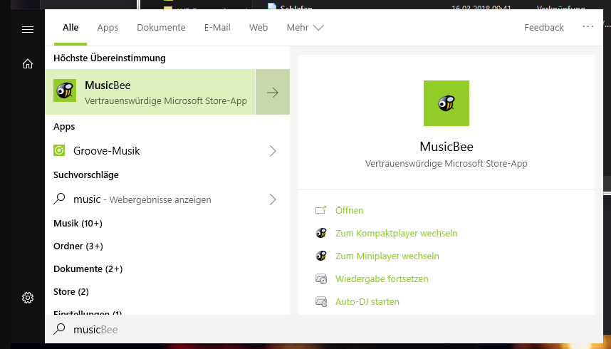

Haha, I get your point ;) . Do you have any proof that people got actually fired because of the Insider Program?
Have a look, in the current start menu there is, if you search for an item, not much of an option to choose from where to drag. It's the left side, yes. I can neither drag MusicBee nor Groove, or any other app.
Ah but your screen grab isn't actually of the start menu itself but of a search result dialogue. That may well be the problem why you cannot drag and drop from it.

As Ric pointed out (and thanks for the picture, btw, or we would have been here a long time lol), that is Windows Search, not the Start Menu.
