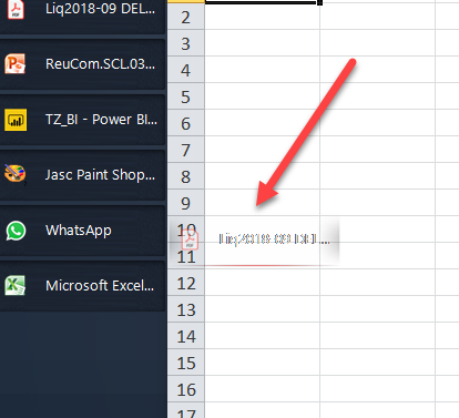

Another functional issue is that taskbar seems to have problems when doing a lot of Alt-Tab. In this image you can see a ghost of a taskbar button is created, and never vanishes... This issues is quite common...

 Post subject: Re: NextSTART Taskbar Functional Issues
PostPosted: Thu Oct 18, 2018 8:51 pm
Posts: 13363
Steps to reproduce?
Anyway, as I explained previously, major improvements work by re-direction of focus, and for now I am more focused on WorkShelf. I'll focus on the taskbar again once I have the new system with Windows 10 here (should be sometime next month, it has already been ordered, but the order includes hardware that has just been released and therefore is not easy to get your hands on at this point).
Last time I focused on NextSTART we got the dynamic Quick Launch area with overflow control, smooth taskbar animations all over, plus a bunch of other enhancements, etc... I just never focused on the vertical taskbar because very few people use it that way. Something else I will work on once I turn my focus back to NextSTART is per-monitor taskbars.

Steps to reproduce?
For instance start to move the tile and release the button halfway...
PostPosted: Wed Oct 24, 2018 11:58 am
Posts: 31
Just found an easy workaround: Grab the original offending tab and make it change places with another.... the ghost tab will go away,...
