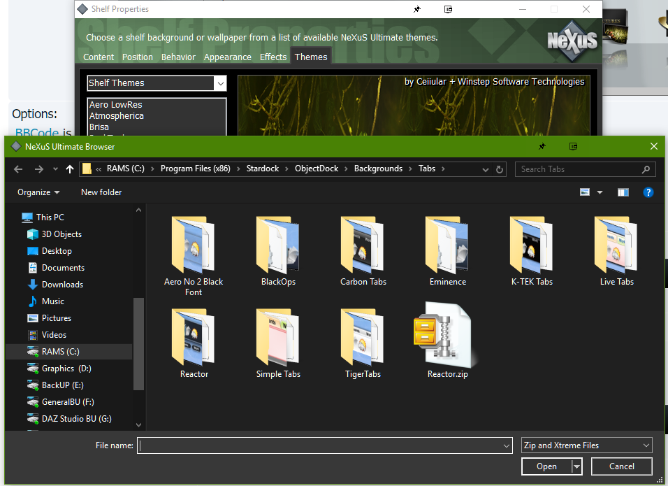

Hi,

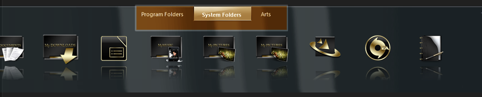

I've looked over the tutorial and done as much research as I can but I can not get the imported theme to show as a new usable theme. I really love the Reactor theme from ObjectDock so really wanting to use that since Winstep states that any third party theme can be imported and used. I think Reactor comes with ObjectDock so perhaps there is an issue with that? Not sure but would like to know one way or the other. IF it is usable then I need a clear cut tutorial that can guide me to figure out what steps I may have missed.
Also I wanted the fonts for the shelf made larger, found those settings, I think but I have them set to 14 and Bold and they are not any larger so does this require a reboot of my computer for that to take effect?

Ok, one very important thing first and foremost:
Nexus (the dock) is what claims to be compatible with themes for all 3rd party docks. This does NOT extend to ObjectDock's tabbed docks though (although as I have already promised here to another user, I will certainly look into that).
So, you can only import 3rd party themes for *docks*.
Click HERE for a themes tutorial also instructions on how you can import themes made for 3rd party docks. Hope it helps!
As for the fonts in the Shelf, here is what I suspect is happening: up until two versions ago, only a single Shelf was supported. Now you can have as many Shelves as you want and that also means each Shelf - like the docks - can have its own, separate, theme.
Unfortunately I didn't get around to add the extra functionality necessary to take this into account (I completely forgot, to be honest), so the Fonts dialog will only allow you to change the font settings for whatever it currently is the 'global' theme (it will tell you what that theme is at the top of the dialog). If your Shelf is using a theme other than that (i.e.; using an individual theme), it won't be affected.
I'll try to tackle both issues in the next release.

Just waiting for the font fix. Funny thing happened, not funny really but at one point the fonts DID enlarge and I was happy but there is something weird with how the product determines what I want because when I went to the themes tab it was not on the theme I had chosen but was back to it's default but I never OK'd the changes but it DID change things back to the other theme when I closed the properties dialog. I thought that was very strange not to mention disconcerting... and when that happened all my icons scoothched over to the one monitor. I got frustrated and just rebooted the computer. The default theme was still applied but my icons were back after Nexus initiated again.
Oh the fonts are back to that tiny little font, not matter what I try so that's done. I have older eyes, I need my fonts larger so that's why this is important to me.

Honestly? I saw the "fast boot" option right off the bat but didn't know what it was so that's why I didn't enable it. I didn't see it on the bar as I removed all the items in the default load of the bar and got to work replicating my older, buggy ObjectDock bar contents as I just wanted this done as quickly as possible.
Oh and I did follow the instructions on the Theme tutorial page and the ObjectDock theme will not import so not sure what to do about that. I really love that theme. The current bar I have is just to fat. Removing the text from under each icon helps thin it out but still fat. I need larger icons for my eyes. The theme from ObjectDock is, somehow, just right for screen space.... Oh well. I'm happy enough but would be nice to have that theme or find one thats similar to "Reactor" theme...
 Post subject: Re: How do I bring in a theme from Object Dock?
PostPosted: Mon Jan 07, 2019 4:40 pm
Posts: 13526
Can you please post that theme's URL here?
