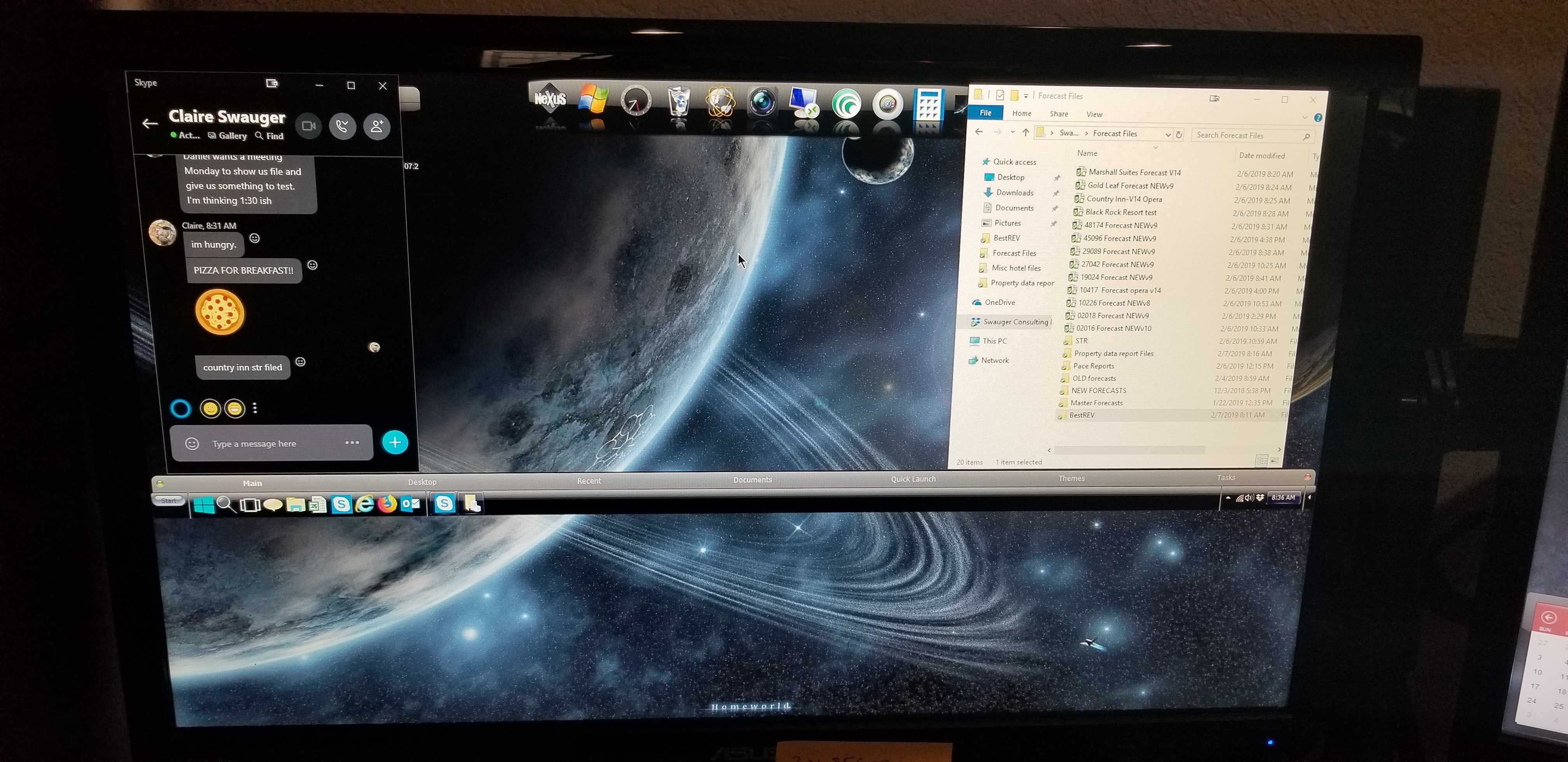

I am running windows 10 with a dual monitor setup.when my pc resumes from sleep mode the taskbar will be flickering at the bottom edge. any windows I left open will be rolled up. have to restart explorer to fix it. this started after a windows update. see attached photo.
any ideas ?

had to resize it before it would upload..
its windows 10 build 1809
I am not in that program.

If I send it straight to sleep and wake it up it'll be fine. If I don't leave any file explorers or browser windows open it'll be fine. If I leave skype or any windows open minimized or not and its been asleep a long while it does it.
The taskbar isn't always stuck in the middle of the screen, usually it'll pop back down but the skin overlay will be off and it'll be flickering. any windows that were open will be rolled up. I open task manager and cpu use is high. explorer.exe will be the issue. I restart it and the desktop resizes it and that fixes it. Sometimes have to restart skype etc
