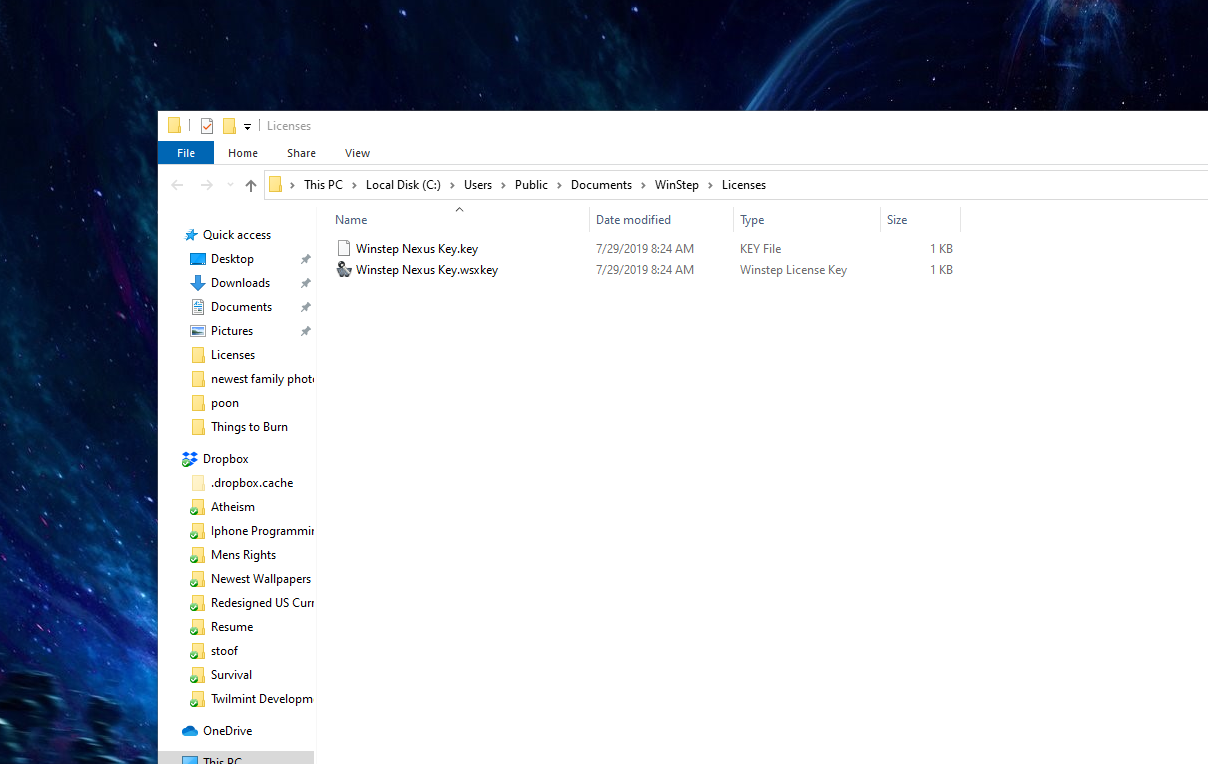

I've uninstalled Nexus and reinstalled.
I copied the license key from my email to the licenses folder, change it from wxs to key, and through Nexus, click on the Register tab, and then the Open Folder tab, which opens the licenses tab. I try double clicking the file, but then it asks me what program I want to open it with.
I also tried not changing the extension, double clicking it to register, which creates creates a .key file on top of the .wsx file, but Nexus doesn't see it. It still asks me which program I want to open the file with.
Oh, and I just left it there inactive. I wasn't able to actually use the program.
Reason I'm having so much trouble is that I actually did follow the email step by step and still run into this problem.

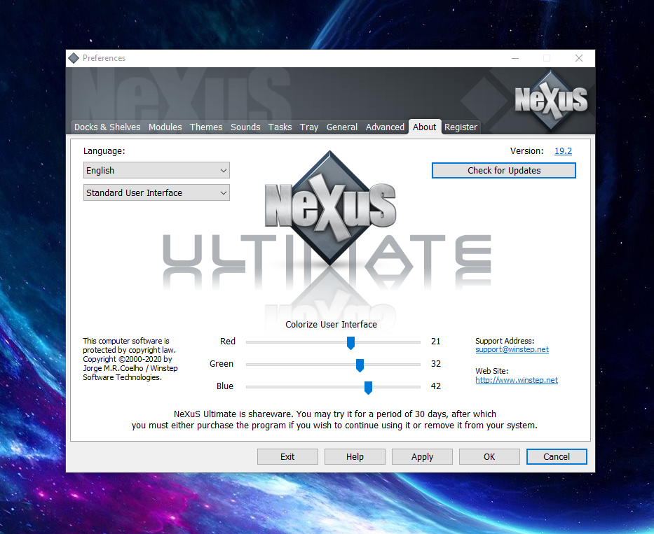

Did you download a fresh copy of Nexus Ultimate from the Winstep web site?
Also, can you post a screenshot of the About tab in Preferences, please?

I'm still using the 19.2 Ultimate installer that I got last year when I ordered.
File comment: About Tab
File comment: Key pic

Ah-ah! I knew it - someone has a hard time reading the manual before engaging in action, and then the table gets mounted upside down lol
Since when is the key file named Winstep Nexus Key.key ? The ACTUAL and ORIGINAL filename is Nexus.key - no wonder the software didn't see it. :)
So, rename the file Winstep Nexus Key.key to Nexus.key (and make sure Windows is not hiding file extensions so it doesn't become Nexus.key.key instead), open Preferences, go to the Register tab and click the 'Register' button.
Also, please delete the Winstep Nexus Key.wsxkey file.

It worked! Thanks so much. Love the program.
