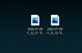

Any files, but mainly images that I have on my desktop when deleted return after restarting Winstep. If I cut and move they dont return but if I delete them they or rather their icons return to my desktop which requires a reboot to lose them. I dont know how to explain it any better than that other than the screenshot I have posted.

Guess it's going to remain a mystery then, sorry. :lol:

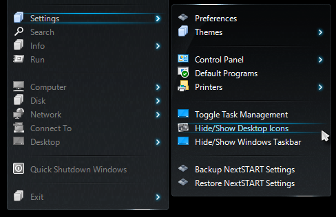

I don't understand this. Do you have Winstep hiding your Desktop icons and that's why you're quitting Winstep? Or do you have some part of Winstep completely covering your Desktop?
If you just want to show/hide Desktop icons, in my NextSTART menu (which is relatively default), there's a "Hide/Show Desktop Icons" in the Settings sub-menu.
