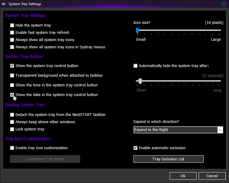

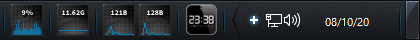

  1. Go into Preferences (default keyboard shortcut is CTRL+F12, or you can right-click on an empty part of the Taskbar and choose Preferences).
  2. Go to Taskbar tab.
  3. Click Taskbar Settings button.
  4. Click Taskbar Sections button.
  5. Highlight whatever sections you want to move and use the Up and Down buttons on the right to change their position.
    • See screenshots below. The Taskbar Sections have the items in the same order that I'm showing them. The right end of my Taskbar is shown in the last screenshot and shows all the items after "Tasklist" in the Taskbar Sections window.
  6. Go back to the main Preferences window.
  7. Click on the Taskbar tab.
  8. Click on System Tray Settings button.
  9. Make sure time is off and date is on (I'm pointing to the date one in the second screenshot below).
    • You can see the result of everything now in my last screenshot below.
I hope this helps you out!
