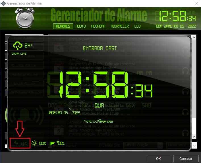

I have installed Nexus version 20.10 on Win10 Pro and configured Alarm in the dock. But it stopped playing sound during LCD display even though each alarm is set to a .wav file. When the LCD is displayed, a disabled speaker appears in the lower left corner. Can anybody help me?

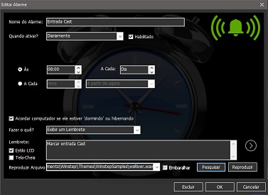

When you Edit the Alarm in the Alarms tab of the Alarm Manager window, is the 'Play' button for that alarm grayed out? What happens when you click on it, can you hear the sound?
R.: The "Play" button is not grayed out, but when I click on it, the text changes to "Stop" and I don't hear anything, until the text goes back to "Play"

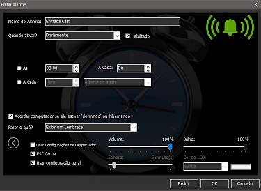

Also, when you press the Arrow above the Play button to get more settings, what is the Volume set to?
R.: Volume = 100%, Brightness = 100% and Nap = 5 minutes
Is the 'Use Wake-up settings' option checked?
R.: Yes

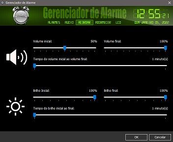

If so, check the settings in the Wake-up tab of the Alarm Manager.
R.: Volume Inicial = 50%, Volume final = 100%, Tempo do volume inicial ao final = 1 minuto

File comment: Alarm edit
File comment: Properties

File comment: Alarm in action

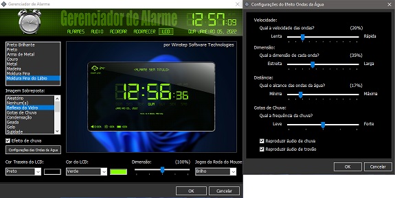

File comment: LCD tab
File comment: Wake up tab
