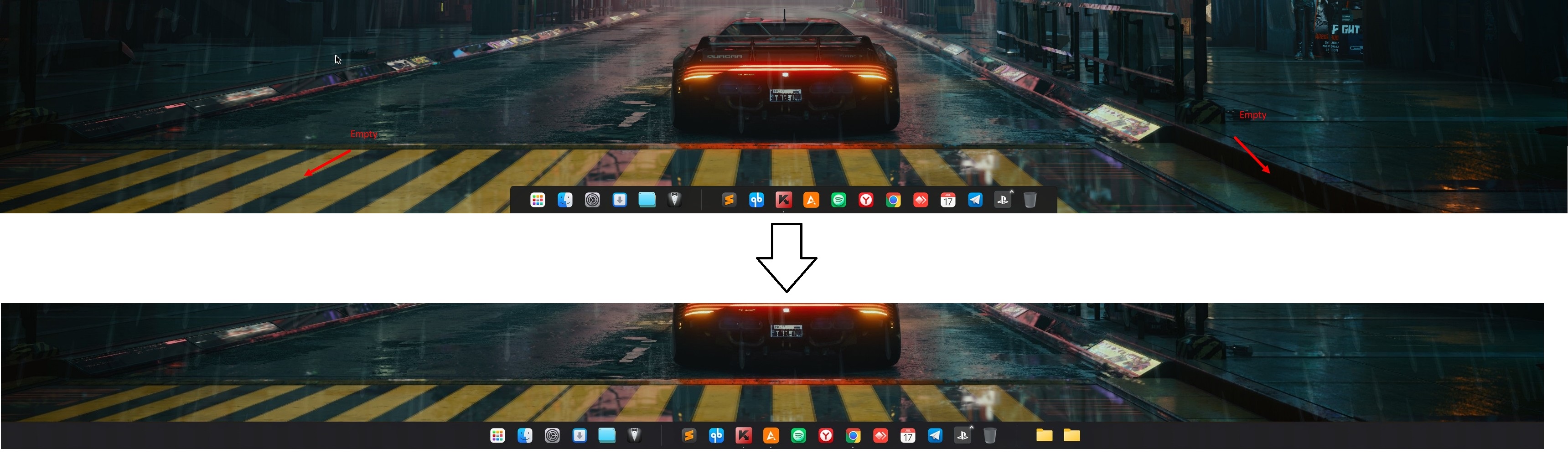

Hello everyone.
People, help me with advice.
Can I always make the panel full screen?
Maybe this will help.
I use a custom theme, a background image with a background.ini file is used.
inside:
[Background]
LeftMargin = 0
TopMargin = 0
RightMargin = 0
BottomMargin = 0
Outside-LeftMargin = 30
Outside-TopMargin = 0
Outside-RightMargin = 30
Outside-BottomMargin = 1
This is not my topic, I downloaded it.
But, I really like her.
I attached a screenshot of how it looks now and how it should be.

someone correct me if I'm wrong, but dock auto resizes to the number of icons, so to have it span the whole width of the screen you'd have to fill it up with blank icons or spacers on ether side
Hi.
Thanks for the feedback. Yes, if you fill the panel with icons, it slides apart. But, I don't want it to look like a dump))) Any other ideas?
 Post subject: Re: WINSTEP FULL-WIDTH PANEL
PostPosted: Fri Aug 26, 2022 7:36 am
you can use blank icons (make a fully transparent png or ico, my dock is itself transparent, but i use them to separate icons into groups
while you could use them on both sides as a sort of 'filler' to stretch out the dock
It's a good idea)). And what do you use to install the icon? A folder? A label? Can you throw off a transparent png or ico, please?

i use item separator
which then i set a fully transparent icon
here is the png:
