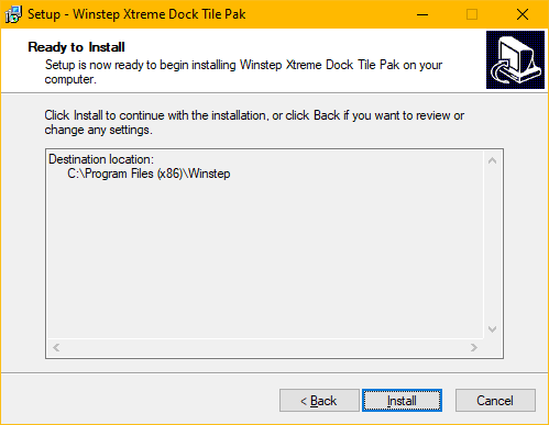

I have installed as per the setup supplied. As per screencaptures, it looks like the setup has completed, but still only the free Nexus application.
In the "C:\Program Files (x86)\Winstep" directory I only see one new file, "unins000.dat". The only executable files I see are; Winstep.exe, Nexus.exe, WsUpdate.exe and WsTranslator.exe. But there is no exectuables here that are named Xtreme or Ultimate. What executable files should I see please?
Regards Patrick
File comment: Here is the final completed install.
2024-08-17 16_01_44-Setup - Winstep Xtreme Dock Tile Pak.png [ 10.47 KiB | Viewed 17872 times ]
File comment: Here is the unpack screen capture.
2024-08-17 16_02_04-Setup - Winstep Xtreme Dock Tile Pak.png [ 56.76 KiB | Viewed 17872 times ]
 Post subject: Re: Unable to Get NeXus Ultimate to Run
PostPosted: Sat Aug 17, 2024 7:07 am
That's not the setup file for Nexus Ultimate. That is the setup file for the bonus dock tile packs.
Please look carefully in the email with your license key. In the section "How to download and install Nexus Ultimate" the first link is for the setup file for Nexus Ultimate (ultimate.zip). Download that, unzip, and run the setup file within.
