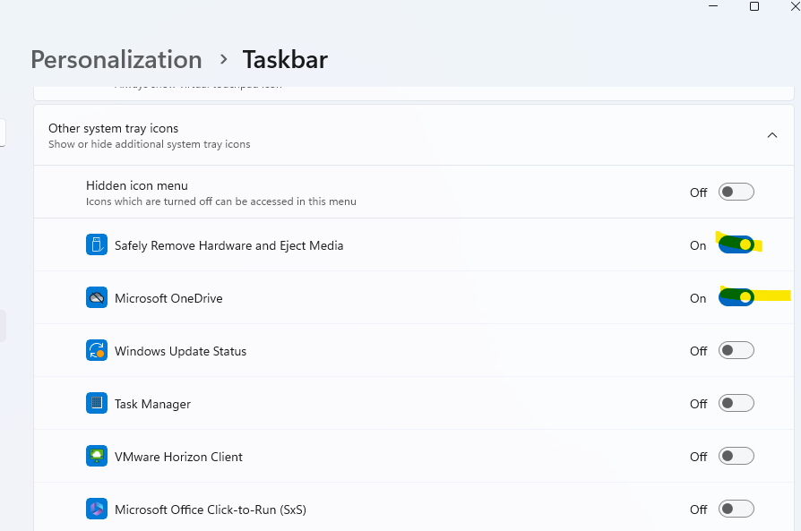

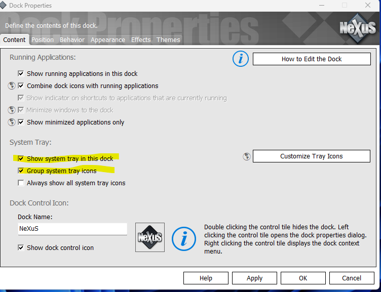

I am using Nexus Ultimate 24.4. In Dock Properties--> Content--> System Tray--> I checked
* Show system tray in this dock
* Group system tray icons
* Always show all system tray icons (Icon shows up when unchecked)
But when I click on the System tray expand button on the dock, I do not see my system tray icons, even though, they are checked to on in my Windows 11 Taskbar personalization option. Why can't my taskbar icons show up when I click on the system tray expand button?
I am using Windows 11 Pro 23H2.
Thanks in advance for your help.

Thanks a lot for your response. I followed what you did by turning off all the icons in the other system tray icons in Personalization > Taskbar; please see below in the image. I also checked Show system tray in this dock inside the content tab of dock properties. I still do not see my system tray icons in the overflow area. Do I need to do anything in the Customize Tray Icons area shown below? I only see Windows Explorer.
File comment: Personalization Taskbar where I unchecked other system tray icons.
File comment: This is my system tray property.

Unfortunately I wiped my Windows 11 drive a while back and I am only running Windows 10 now, so I can't check my settings. The only thing that you mentioned that I believe was different on my system, was I had "Enable tray icon customization" unchecked, and under Windows 11 "Personalization > Taskbar, "Hidden icon menu" was set to on. I think turning the Hidden Icon Menu on may be the answer.
I can confirm that I was able to see all my system tray icons in the overflow area, and show the system tray on my dock using Winstep Xtreme 24.4 on Windows 11 23H2. It took quite a while before I was able to make it happen and its possible that I may have changed some other setting. I was also running Start 11 and WindowBlinds 11. They can modify the taskbar and Widows explorer so that may have had an effect also.

Anyway, also make sure the 'Always show all system tray icons' setting is DISABLED in the Winstep application:
