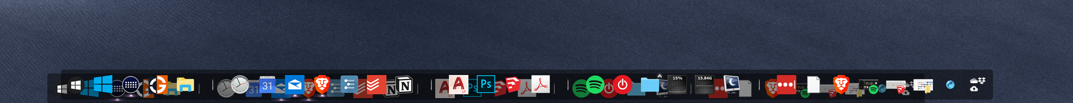

I have a dual monitor setup with separate docks locked to each monitor.
Anyone know why I keep getting my secondary dock move to the same place as on my primary monitor? Both docks are locked to the bottom of each screen so I cant understand whats going on.
Its quite frustrating as I have to unlock the dock which is stuck behind the other, move it back to the 2nd monitor and re-lock in place, which would be fine, but that in itself is a clunky process.
I'm guessing this has something to do with turning the 2nd monitor off. But does anyone know of a fix for this?

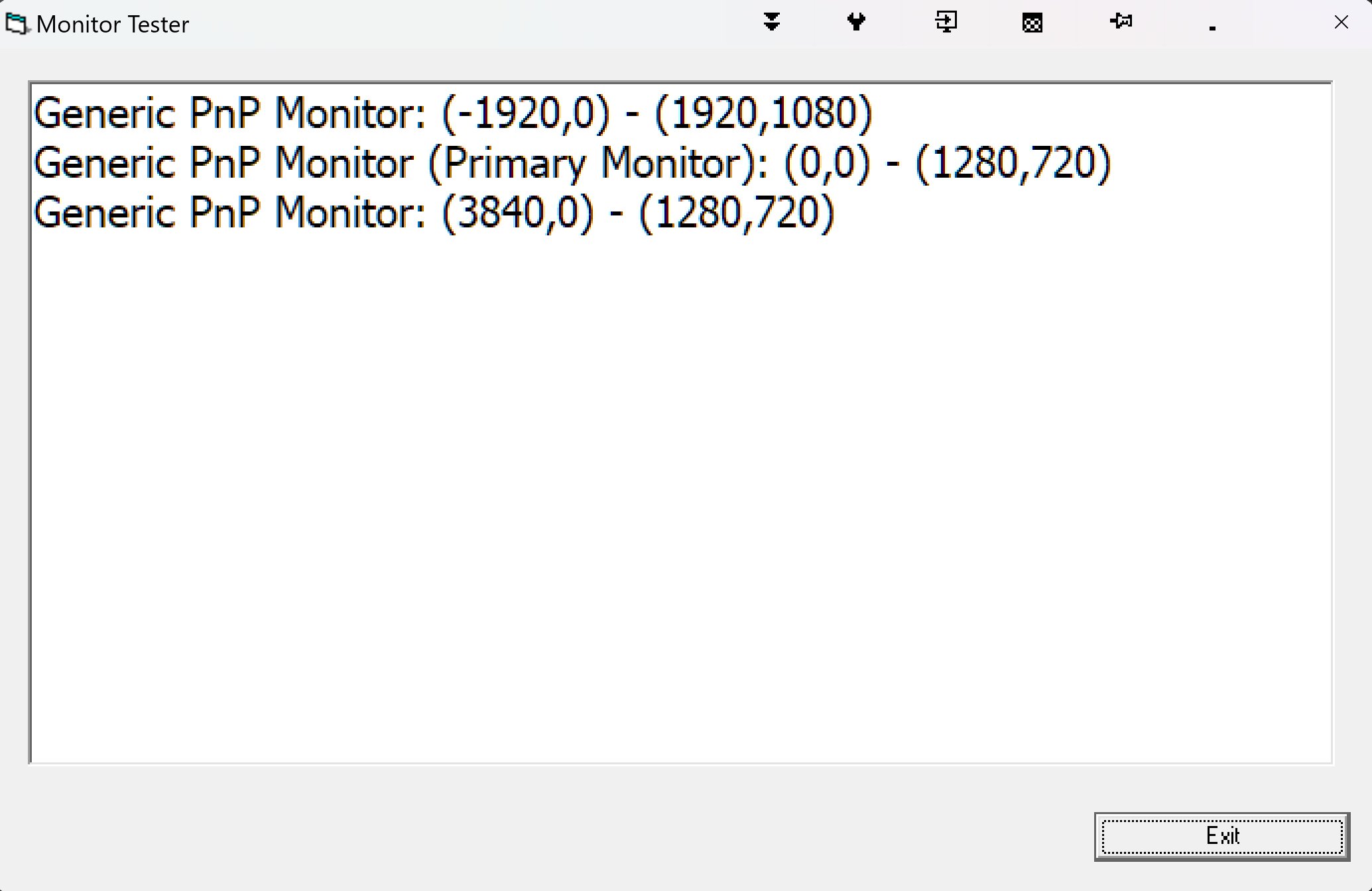

I have three monitors but the settings of workshell do not show this third monitor.

Download THIS FILE from the Winstep web site, unzip and run TestMonitors.exe then post a screenshot of the results, please. This will show what the Winstep application sees in terms of monitors and screen resolutions.

Oke here it is.

Winstep thinks that the 1280,720 monitor is my primary but the 3840 is. And i have two 1920 screens.

What you see there is what Windows is telling the Winstep application regarding the number of monitors and their resolution. Since you claim to have two 1920 monitors, this means Windows is lying.
This happens because one or more monitors have mismatched screen DPIs. Winstep applications are high DPI compatible, but they are not PER-MONITOR high DPI compatible. This means that for everything to work properly all monitors must have the same DPI (e.g. all 100%, or all 125%) otherwise Windows will lie to the application about the real screen resolutions and what you get is the result.

Thanks that is the solution, i can now place the dock on all screens.
