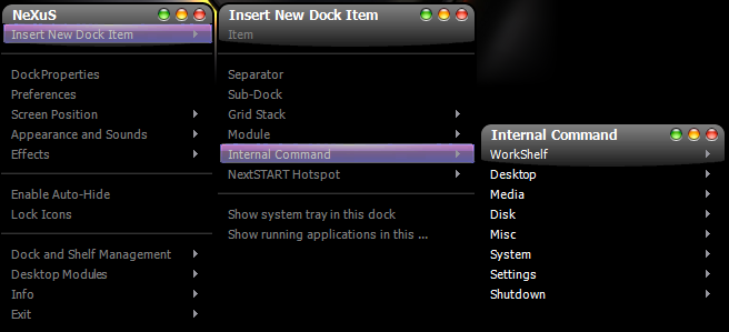

Pasting the URL worked. As far as seeing a new item pop-up for URL, I don't see that. Here is a screenshot:
 Post subject: Re: Add browser websites to docks
PostPosted: Fri Apr 18, 2025 7:36 pm
You select "Item" at the top of the insert context menu, which opens the Item Properties dialog. Then on that dialog you change the 'Item type" to URL, then type in the label and the actual URL and press OK.
