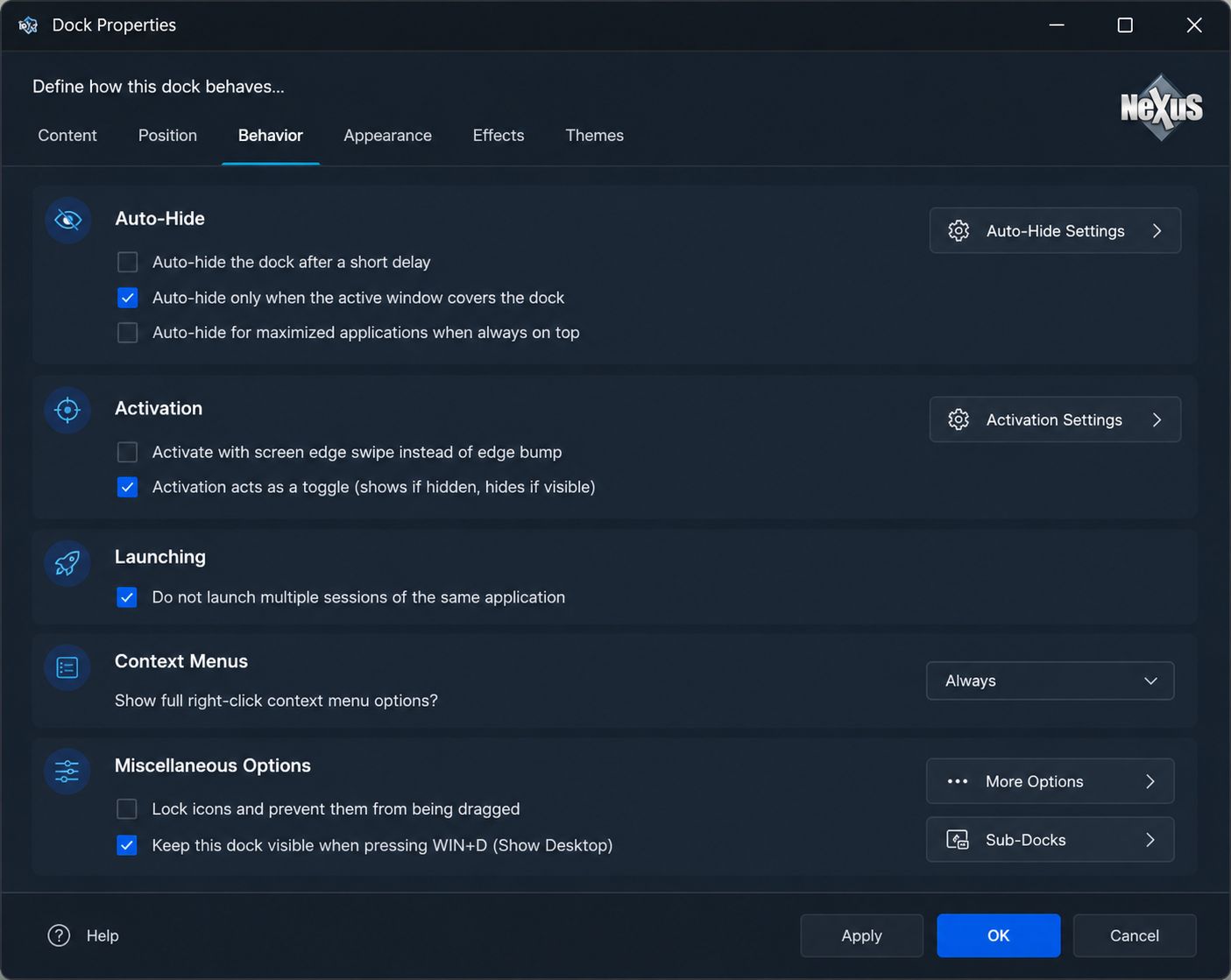

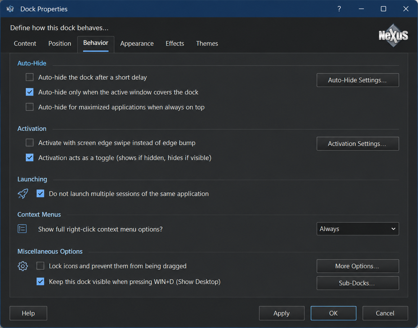

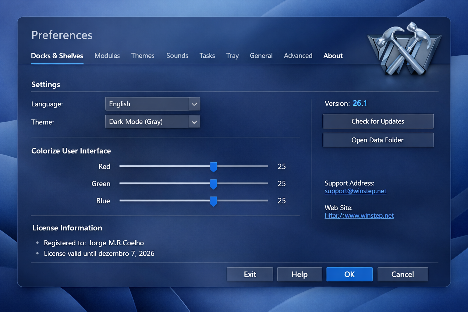

The AI suggested something like these three, but as you can see this makes Preferences HUGE (just like Windows 11 settings are HUGE these days):
There should also be a version with higher information density, but I can't get the AI to combine this with "modern UI style", it keeps giving me variations of the above two images. Anyway, I am not sure if the juice is worth the squeeze or even if something like this would be enough to satisfy those who are absolutely convinced that "new is always better" (even when it isn't).

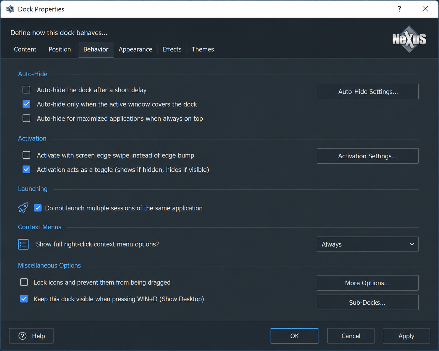

Also, the Sub-Docks dialog on the Dock’s Behavior tab currently includes an Open sub-docks on mouseover option and a configurable popup delay. It turns out that this setting already controls whether other dock popup objects - such as Grid Stacks and Launch Pads - open on mouseover as well.
A user recently suggested that folder menus should also support mouseover activation. These are the menus displayed when a folder shortcut is configured with Show Folder in a Menu in the item’s Properties dialog.
Since the existing setting effectively controls all dock popup objects - sub-docks, Grid Stacks, Launch Pads, and folder menus - it makes sense to move it, together with the popup-delay setting, to the More Options dialog on the same Behavior tab. The option could then be renamed:
Open sub-docks, Grid Stacks, Launch Pads and folder menus on mouseover
This also solves a problem in the free version of Nexus. Because Nexus Free does not support sub-docks, clicking the Sub-Docks button currently displays a promotional screen for Nexus Ultimate. In Nexus Free, the equivalent option in More Options would simply read:
Open folder menus on mouseover
That said, users of the paid versions may still reasonably expect the mouseover settings for sub-docks to be available from the Sub-Docks dialog. Rather than duplicate the controls there, I plan to add a Mouseover Settings button that opens the More Options dialog directly.
