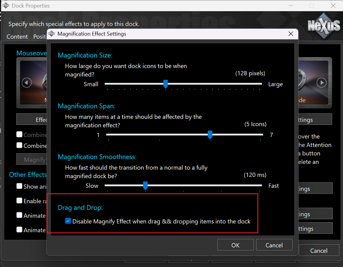

Hi Jorge, I believe I found another minor bug. The Disable Magnify Effect when dragging and dropping items into the dock does not seem to be working. When I drag and drop programs from Start Menu to the dock, the magnify effect still occurs. I'm using latest Nexus Ultimate beta and Windows 11. Let me know if you need more info. Thanks!
I don't think we might be using the same terminology... there is no "Disable Magnify Effect" setting?
Actual settings that need to be enabled/disabled and detailed steps to reproduce please. :D

The setting lives under Dock Properties>>Effects>>Mousover Effect>>Magnify>>Effect Settings.
See Screenshot.

OMG I did not even remember that setting existed lol
Fixed, thanks.
Fixed, thanks.
LOL! No problem! Thanks for fixing it!
