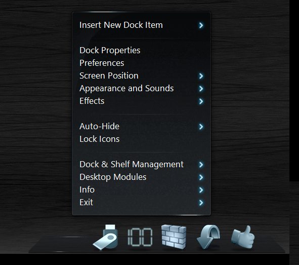

Right clicking the empty space shows this menu:

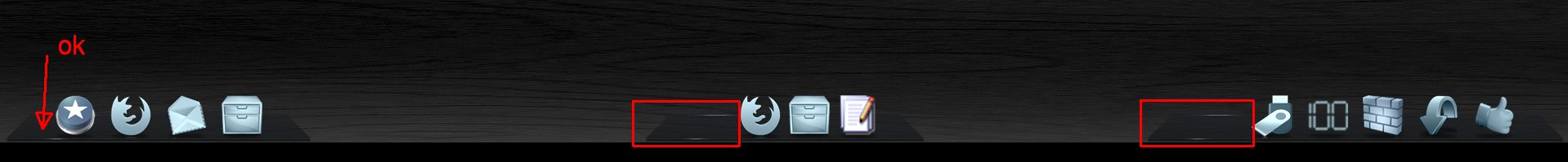

For visual reference:
[attachment=0]all.jpg[/attachment

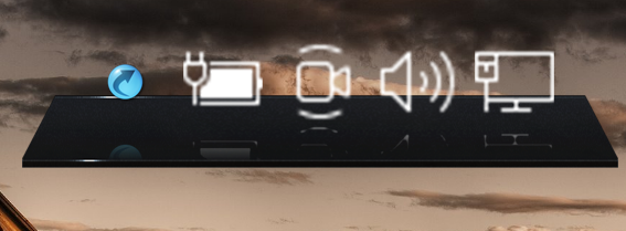

Since you have "Always show all system tray icons" UNCHECKED, the leftmost (blank) position on the tray icons dock should be (is?) the tray expansion button. Here is what a normal tray dock looks like under a Windows 10 VM:
Clicking the blue tray expansion arrow opens the Windows system tray overflow pop up, where all the other tray icons are.

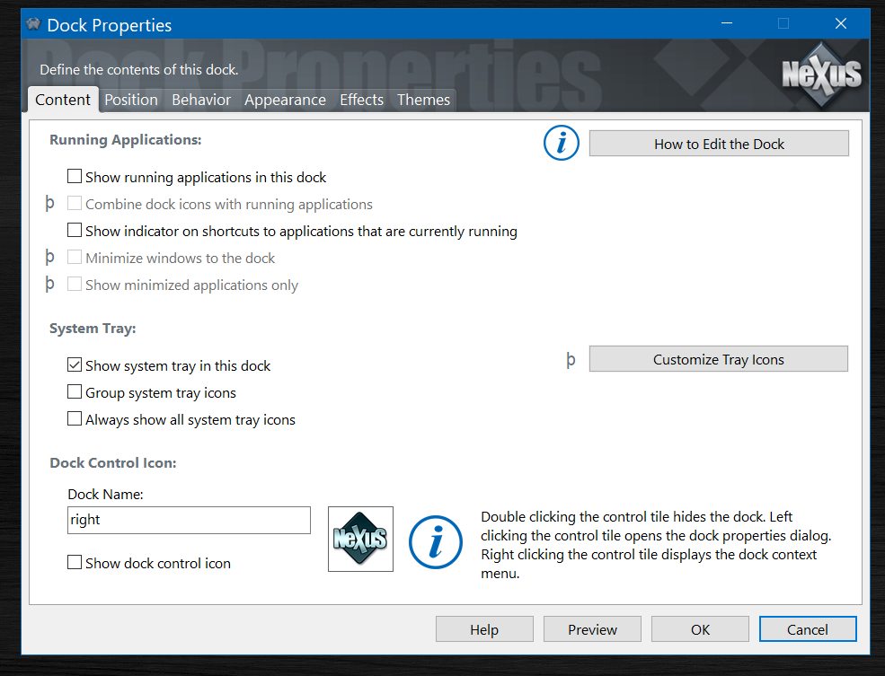

Another thing I noticed is that the little symbols next to some of the settings in the Dock Properties dialog should look like little globes but they look nothing like that in your screenshot. Here is what they look like on a normal system:
Did you remove the Webdings font on your system?

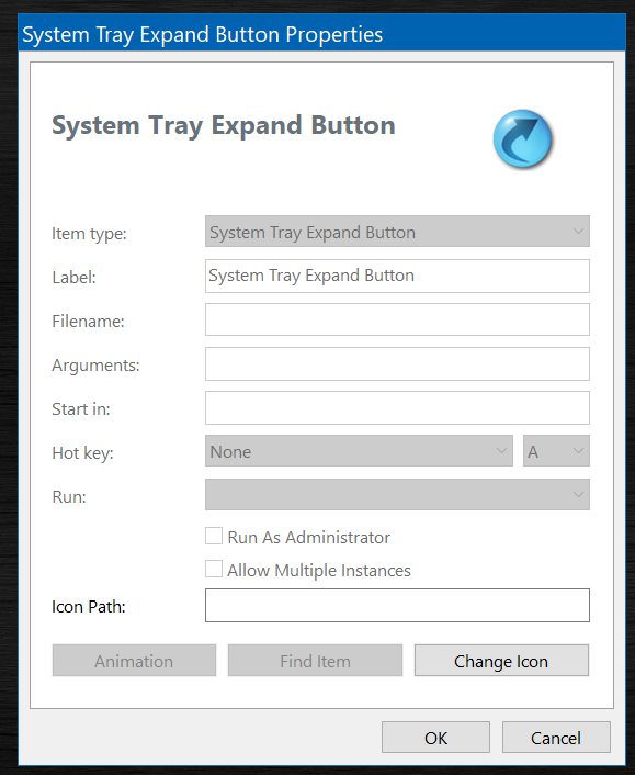

Right clicking that expansion button shows the normal
'system tray expand button' properties dialog.
(the missing glyphs is due to no webdings font)
