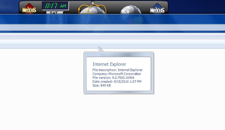

One last thing is there anyway you can make it so these info boxes do not show over windows at all?
Here is an example of what I mean. As you can see in this screeshot I have a window right under the dock and when I hold the cursor over any item on the dock these info boxes popup over the window. "The cursor is missing from the screenshot"
I would love it if you can make it so nothing at all from the dock can show up over windows including any text or boxes from items on the dock.
Hope this can be done :)
Thanks and have a wonderful weekend!!! :)

Removing the always on top attribute of the balloon tooltip - which is there by design - would cause more trouble than it would solve - especially considering the balloon tooltip is temporary and disappears as soon as you mouse away from the dock. What would be the point of having it appear if it popped up behind other windows, after all?
True you do have a point there :).
But how about instead if you had an option to not have the "tooltip box" show up at all. I mean option to disable it. And instead only have the "text" display when cursor is over an item on the dock? The "text" does not seem to show up over windows like the "Box" does.
What do you think of this idea and would this cause you trouble?

That option is already there: Misc.Advanced dialog of the Advanced tab in Preferences, 'Disable balloon tooltips'.
Note, however, that there is a bug in beta 2 (already fixed for the next beta/release) in which disabling the balloon tooltips also disables the mouseover window previews of running applications.
Great!!! :)
Well this solved my issue!
Not sure how I missed that lol :)
Thanks again!
