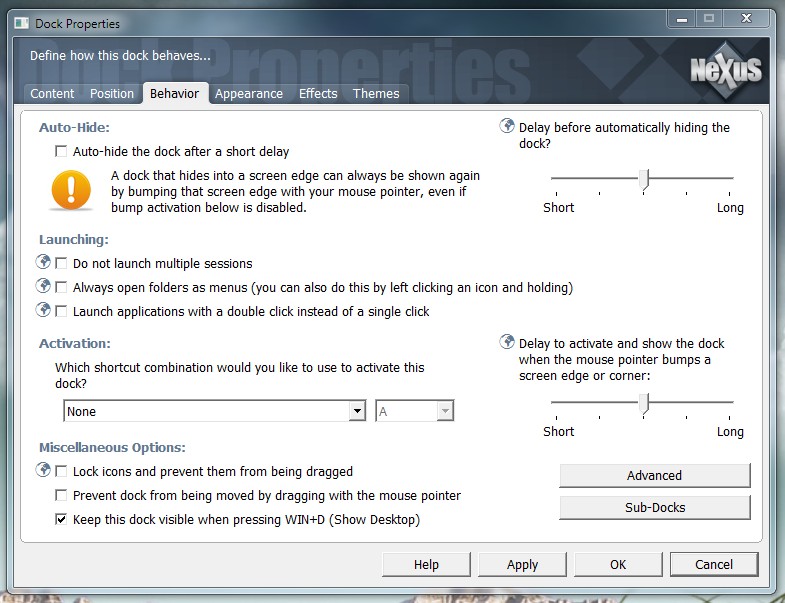

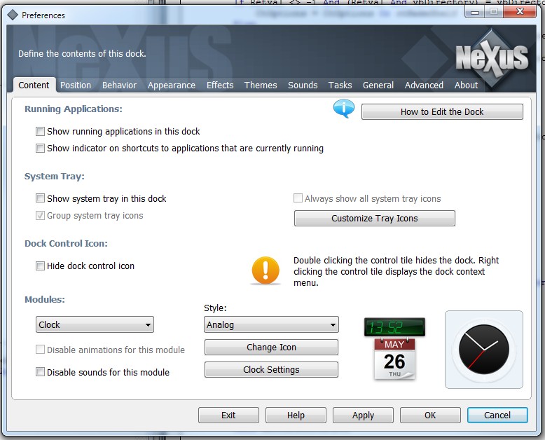

I realize that, and v11.5 got a major re-organization of the UI. You now have a new 'Content' tab in Preferences, for instance:
In previous versions, and mostly because UI panels are shared between Nexus, Ultimate and Winstep Xtreme, settings were forcefully separated into 'per instance/dock' and 'global' settings. If this made some sense in Ultimate and Xtreme, where you can have multiple docks, it made no sense in Nexus free, as having a single dock means even 'per dock' settings can be regarded as global.
So the whole UI, even for Ultimate and Xtreme, was re-organized so settings are where you would logically expect them to be (for instance, the auto-hide delay, which is a global setting affecting all docks, is now next to the 'auto-hide' setting in every Dock Properties dialog instead of in the General tab of Preferences). In Ultimate and Xtreme, settings which are global now have a 'global' marker next to them (the following is a screenshot of the Nexus Ultimate UI, not Nexus free, although the behavior tab in Nexus free looks pretty much the same now but obviously without the global markers):

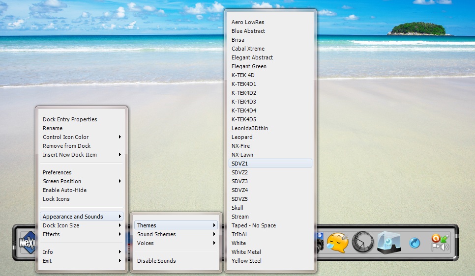

But I found another problem: If I change themes by right-clicking the Nexus button on the dock, themes will not be applied. The dock will have each transparent icon behind each app icon.

I found it could be related to some parts:
1. the setting of "prevent themes from changing your current wallpaper"
2. the making of theme files
3. wallpaper is including in the theme files or not
Yep, that was happening with 3rd party dock themes when applied from the menu. Fixed for v11.5, thanks. :D
