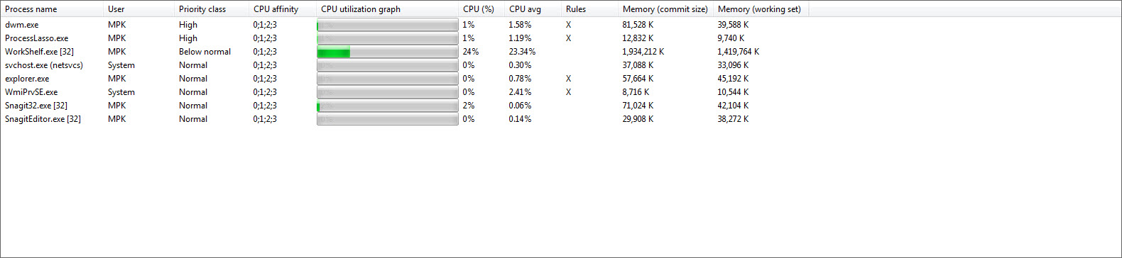

Hi Jorge I have been using xtreme happily since last April but today it started to crash on loading.
NextStart is fine but it's the workshelf modules that load, work for a maybe 30 seconds (when I hover over the docks the icons balloon out is what I mean by working) and then the docks and the workshelf freezes completely.
I run "Process Lasoo" which shows workshelf.exe(32) running even when the workshelf and docks are frozen. It also show workshelf using 24% of the CPU and 1.9GB on Memory which is massive.
I can restart Workshelf.exe (32) with process lasso but exactly the same happens - it just freezes although everything else on the computer continues to work fine.
I have uninstalled and reinstalled Winstep Xtreme with the latest download several times and rebooted but still the same result. I am running Windows 7 (64bit).
Your help in resolving this would be most appreciated. The only new software I installed yesterday was SoundTaxi Media Suite and also from the same developer I installed RipTiger. Neither are running at the moment.
Michael

1.94 GB is very close to the limit for 32 bit processes (2 GB). Something is leaking memory like there is no tomorrow. 24% CPU usage means WorkShelf is maxing out one of your CPU cores.

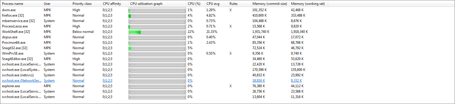

I did however take two screen shots of my desktop as you asked - one just before workshelf and the docks crashed and another just after they crashed.
I did not post them because the uninstall which included removing the settings worked but I am posting them now to see if they do help you identify the problem.
CPU and Memory Usage After Workshelf and Docks Crash.jpg [ 182.65 KiB | Viewed 21733 times ]
