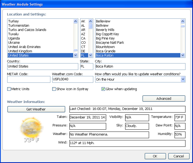

This said, can you please post a screenshot of your Weather settings panel here?

Hey Jorge,
I think these are the settings you wanted a copy of ?

Sorry...I don't know why I am having trouble uploading a .pdf of the screen capture...I browse and pick the file but it disapperas...and when I "add the file" I also do not see it...???...Landon

Posts: 23
Hey Jorge...thats what I thought I was doing...the text was coming across but the file was not uploading...AH-HAH...I found it...the file was 273k and too big to upload...I knew I wasn't crazy...well...a little crazy..not that kind of crazy...so I will try it again but at 215k, and hopefully you can read it...thank you...Landon

Posts: 13603
Well, yep, I checked it here and MSN is returning nothing for that location. You can see for yourself:
http://weather.msn.com/RSS.aspx?wealoca ... c:USFL0040
As such, the Weather module automatically falls back to the Google feed, which only gives a 4 day forecast.
Replace USFL0040 with USFL0041 above if you want to see what a valid weather feed would look like.
No idea why MSN is not giving weather conditions for Boca Raton, FL. Could be permanent, could be temporary, only they would know.
