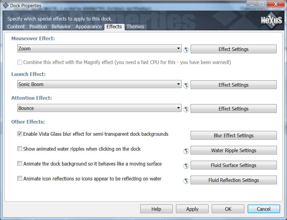

Are we talking about Nexus free, Nexus Ultimate or Xtreme?
Can you please post a screenshot of the Effects tab in Preferences?

here's a shot attached.

Looking at that backup, I can see the Launch effect for your first dock (which has 10 items, first item being 'Common Folders') is set to AfterGlow. I don't see anything obvious that might cause the problem. Nobody else has complained about this either (so far), which makes it a tough one to crack.
Looking at your Preferences screenshot above, however, I did notice that your screen DPI is NOT set to 100%. It's a long shot, but have you tried setting your screen DPI to 100% and see what happens?

Sorry for the long delay in replying. While I have not set my DPI back to 100% to see what happens (I *need* 125%, so even if that made it work, it would be an unusable solution), upon the initial reinstallation of Nexus Ultimate, the selection effects worked great, just as expected. And that's with the 125% DPI... doesn't seem like that's the culprit.
