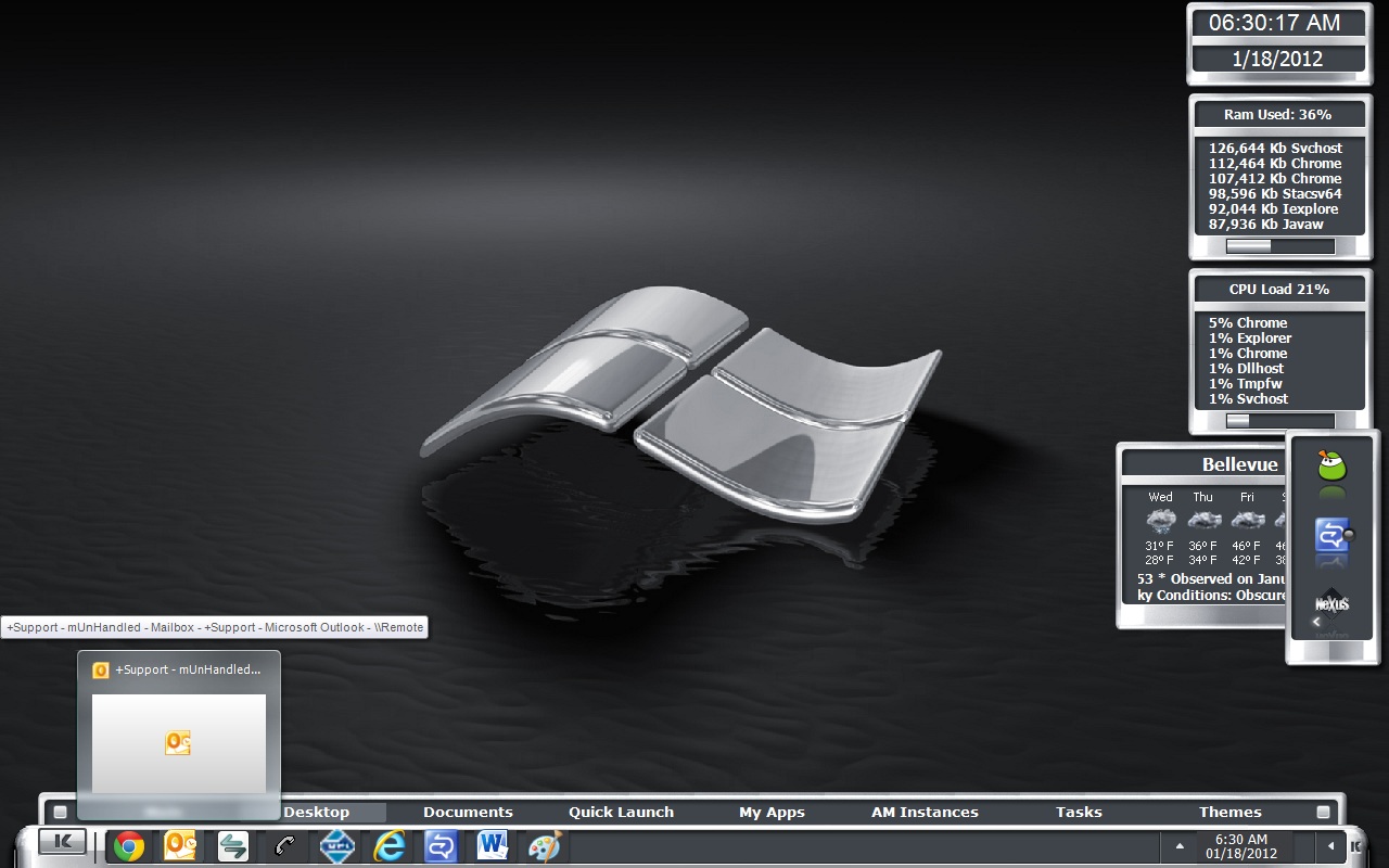

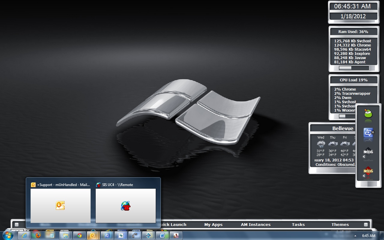

I have seen this happen for only one Application and is mildly annoying. I am running the Beta version (11.12) on WinStep Xtreme.
I connect to my work network using Citrix and run some Apps via that. Here are 2 screenshots showing what shows up on my Windows Taskbar vs Nexstart TaskBar. The same Application does not show up with the 'Show Running Applications' in the Dock either (guessing they both use the same code).

What do you think Jorge?
File comment: Mouse Hover shows only 1 application.
File comment: Mouse Hover shows 2 applications.

I do not believe it is the same issue.
- The Window in question does show up in the standard Windows Taskbar. That is never a problem.
- Window shows up when I hit Alt-Tab. This is never a problem.
- Window also shows up in Object Dock Plus.
Its not a disappearing button/tab issue. It just never shows up as a Running Application in NexStart or the dock.

In the Windows taskbar the SIS UC4 terminal window is grouped together with the +Support window. This means both windows belong to the same application.
My guess is that this is exactly what happens with multiple tabs in an IE or other browser: the Windows taskbar displays the separate tabs individually, the NextSTART taskbar only displays the current tab.
