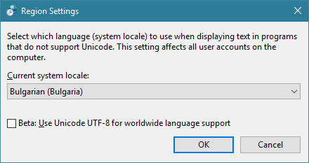

This made me realize that I have my locale set to Bulgarian and I need to change the Windows setting that takes care of non-Unicode programs:
Changed it to Bulgarian:
and restarted.
After that I repeated the process and the value this time is "мар 15 2021" which in English reads "March 15 2021".
Voila, the problem is gone!
Thanks again for your guidance!
PS: maybe you should think about implementing the program in Unicode in the future ;)
Best regards
