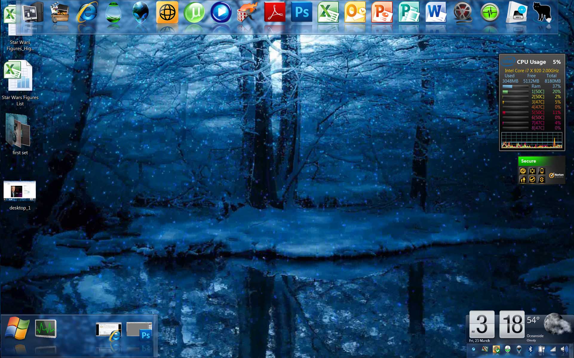

I appreciate the response. I've been trying to solve this problem for a while now. I have already searched google for dreamscene crashes, explorer crashes, etc., and none of the solutions posted (for either vista or 7) worked for me. So like a good mechanic, I worked backwards with what I know is running in the background that did not come preinstalled with Windows 7. Well, I found my culprit: Stardock Fences. I disabled it and then trying a dreamscene, it has been running over two hours with no problems. Explorer runs at 126'000K/3%-5% CPU. With dreamscene on my CPU runs between 5%-7% at idle. I will keep it running to see if any irregularities pop up.

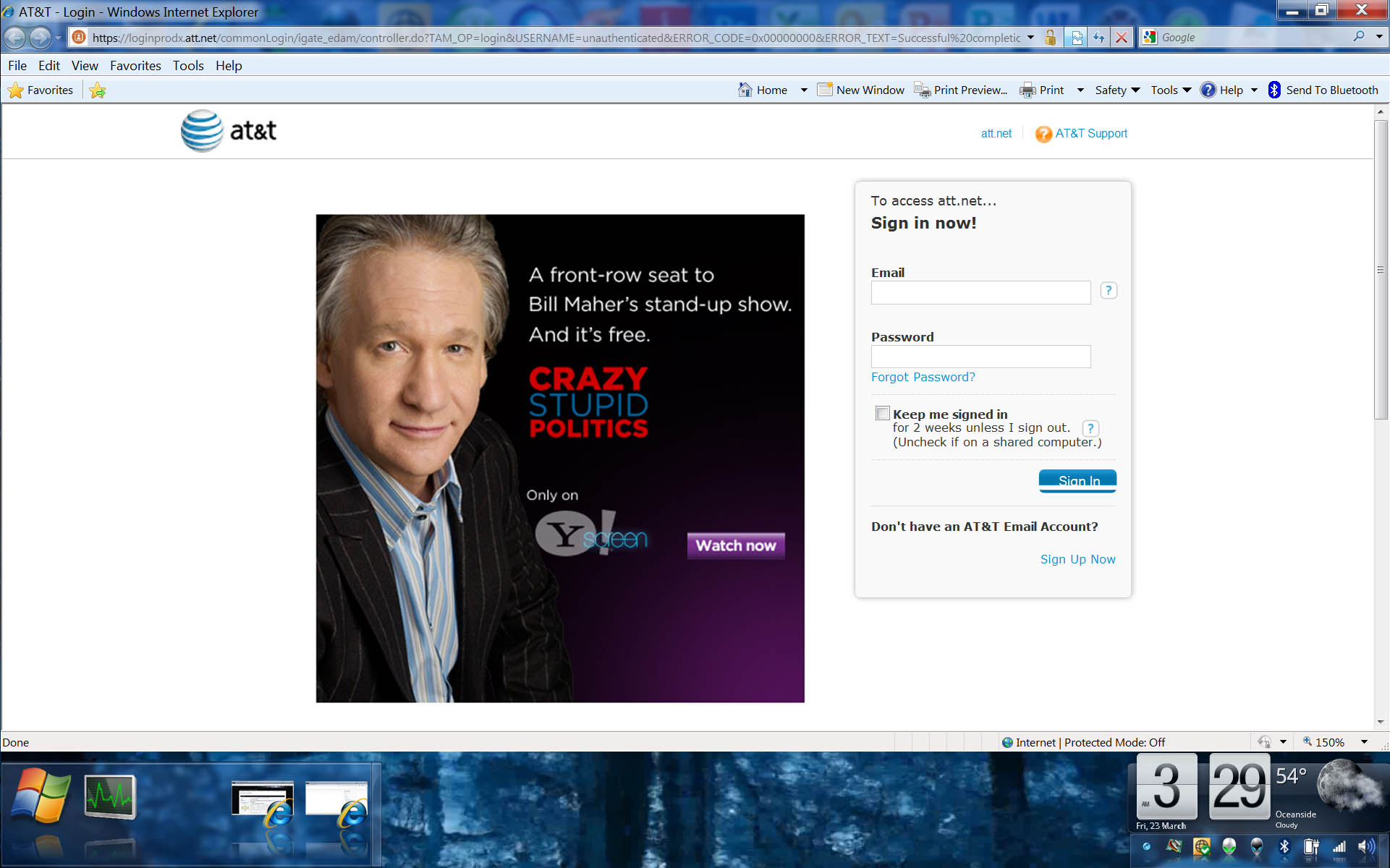

Now I have another issue. How do I go about making the desktop icons ONLY, respect my top dock's space? If I enable the "prevent maximized windows from overlapping the dock" option, it does prevent my desktop icons from moving behind the dock, but I still want the program/explorer windows to be able to overlap the dock. I have attached my desktop pics to give more of idea of how I have my desktop setup. I just want to prevent the desktop icons from going behind the top dock, but without affecting the window sizes. I can't use Stardock fences since I now know it has been causing explorer to crash. Is there any way to edit something in windows to change the borders of the desktop?

Not that I am aware of, because what causes the desktop icons to respect the space reserved by the dock is the very same thing that makes windows not overlap the dock (appbars).
