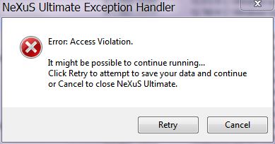

 Post subject: Re: Access Violation Error after today's Window updates?
PostPosted: Wed Nov 11, 2015 9:05 pm
Posts: 178
Jorge,
I'm getting the error when trying to delete an item from the dock.
Thanks,
Grouch
Windows 10 Pro[x64]
Nexus Ultimate 20.10.1154
Antivirus: Windows Defender

Any type of item (i.e.; Internal Commands, modules, shortcuts to applications, etc...)? Did you try it with different items?
Also, how are you trying to delete the item? By dragging it to the Recycle Bin module or via the right click context menu? If the latter, does it crash too if you drag it to the Recycle Bin module?
What about the Shelf?

Jorge,
Confirmed! I backed out KB3097877 and tried again. All is well. It's definitely another botched patch from Microsoft. I'll watch for a re-issue of the patch and try it again.

Jorge,
Confirmed. The re-issue of KB3097877 plays nice with others. I was able to remove an item from the dock without crashing "Nexus Ultimate".
