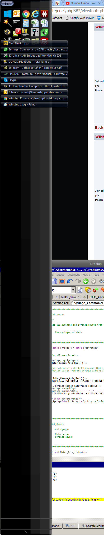

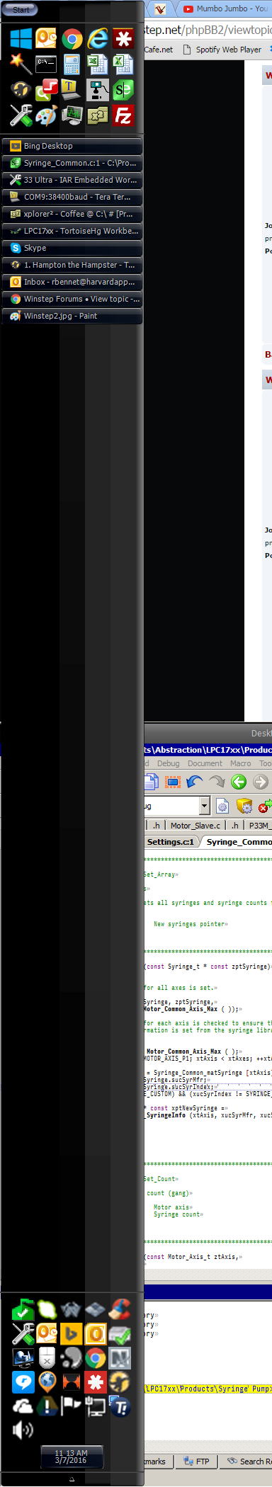

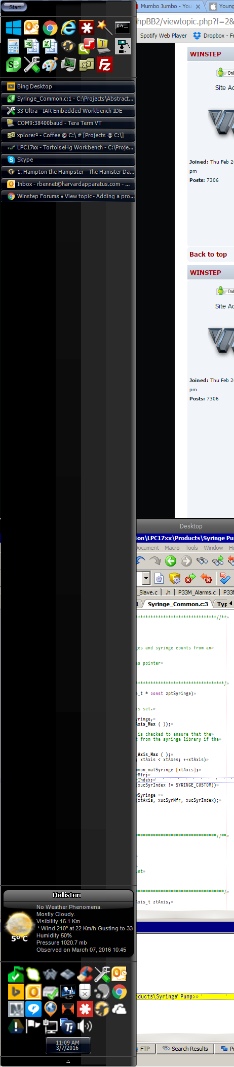

I uploaded three images. The first one shows my normal taskbar. The second shows it just after a Quick Launch rename. The third one shows it after the taskbar was allowed to autohide once after the second image.
Part of the workshelf can be seen at the bottom of the top screen. The Nexus is in the upper right corner of the top screen but not visible because of the cropping.
The taskbar spans two screens on the left side of a four-screen configuration. So you'll see the first screen in the upper half and the second screen in the lower half. There are two more screens to the right of the ones shown for a total of four screens. The screen configurations are:
23
14
Screens 1 and 2 are on the motherboard, and screens 3 and 4 are on a plug-in video card.
I wasn't able to show much of the screens because of the 256 KB upload limit.
So after renaming a Quick Launch item the taskbar loses the Weather module + system tray, and the tasklist extends horizontally beyond the taskbar? Wow.
I think 'losing' the weather module is what is causing all the weirdness.
How are you renaming a Quick Launch item? Step-by-step, please.
