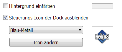

Here's the Nexus icon that always comes up as soon as the Dock is hidden:
...although the icon is disabled in the settings:
So, how to get rid of that icon?

Ok, if you posted the screenshot in English, I might be able to know where it came from...
...unfortunately, that "Sterungen der Icon fur ausblanden" means nothing to me... :D
Where did that setting reside?
 Post subject: Re: Nexus activation by hitting screen border not working
PostPosted: Mon Mar 10, 2014 2:22 pm
Joined: Mon Jun 14, 2010 6:57 am
Posts: 35
This is under Appearance (but could be anywhere in the confusing settings 'telephone book') and means "Hide Dock Control Icon".

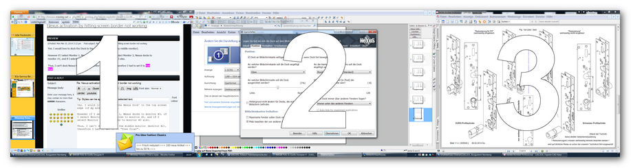

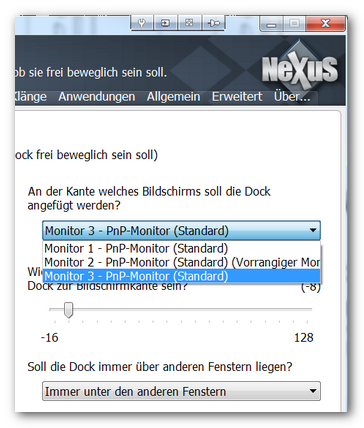

Thanks, yes. I would love to dock Nexus to the top screen edge (of my middle monitor).
However if I select monitor #1 in Nexus, it docks to monitor #3, if I select monitor #2, Nexus docks to monitor #1, and if I select monitor #3, Nexus docks to monitor #3 also.
Other than in above screenshot, my monitor #2 is NOT "vorrangiger=primary monitor" in Windows -- rather, monitor #1 is primary monitor. Nexus seems to have difficulty in recognizing multiple monitors correctly.
Thus, I can't dock Nexus to the middle monitor (monitor #2), therefore I had to set it to "free float".
PostPosted: Mon Mar 10, 2014 3:48 pm
That's a very interesting bug. Actually, I realised you've got some sort of monitor extender from the buttons on the titlebar of your Windows. I remember there was another issue like this, a few years ago, where the Windows monitor enumeration was somewhat... buggy. I remember Jorge had to introduce some sort of monitor enumeration using... something like serial numbers or other?
Now, the big question is whether that monitor expander that you're using (which one is it, by the way) is interfering with Nexus or not.
