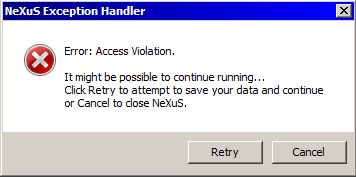

I've done multiple startups today and it happens every time. Nexus pops up an exception violation box (see attachment) and NextStart crashes with the following report:

 Post subject: Re: Winstep crashes on startup
PostPosted: Fri May 13, 2016 3:36 pm
Err, what are you doing running the free version of Nexus if you have Winstep Xtreme?
Anyway, 'it happens every time' when? Immediately after a reboot?
It obviously wasn't happening before, so what changed on your system?
Last time I saw Winstep applications crashing left and right like this was due to a faulty Windows update... and Windows issued a bunch of updates yesterday.
However, I've already downloaded and installed them here on my Windows 7 x64 system and I am not seeing any issues.

I checked the link to the faulty update information you provided so I found the update and uninstalled it. There are no more Xtreme starting problems now, and Windows now starts in 2 minutes instead of the previous 10 minutes.
