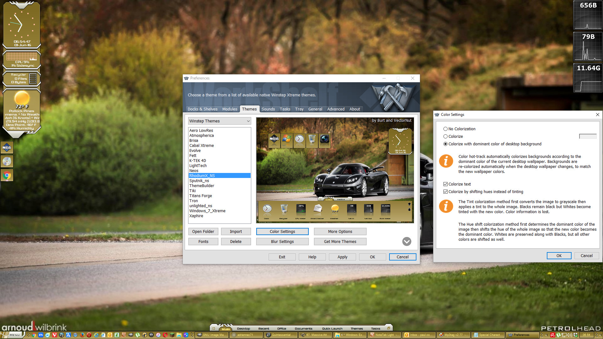

PostPosted: Wed Jun 01, 2016 2:07 pm
Jorge, here is a screenshot before exiting and restarting Winstep but after actually TELLING it to Apply:
File comment: Before exit and restart of Winstep
As you can see, Winstep settings knows the color it SHOULD use, but it doesn't actually use it.

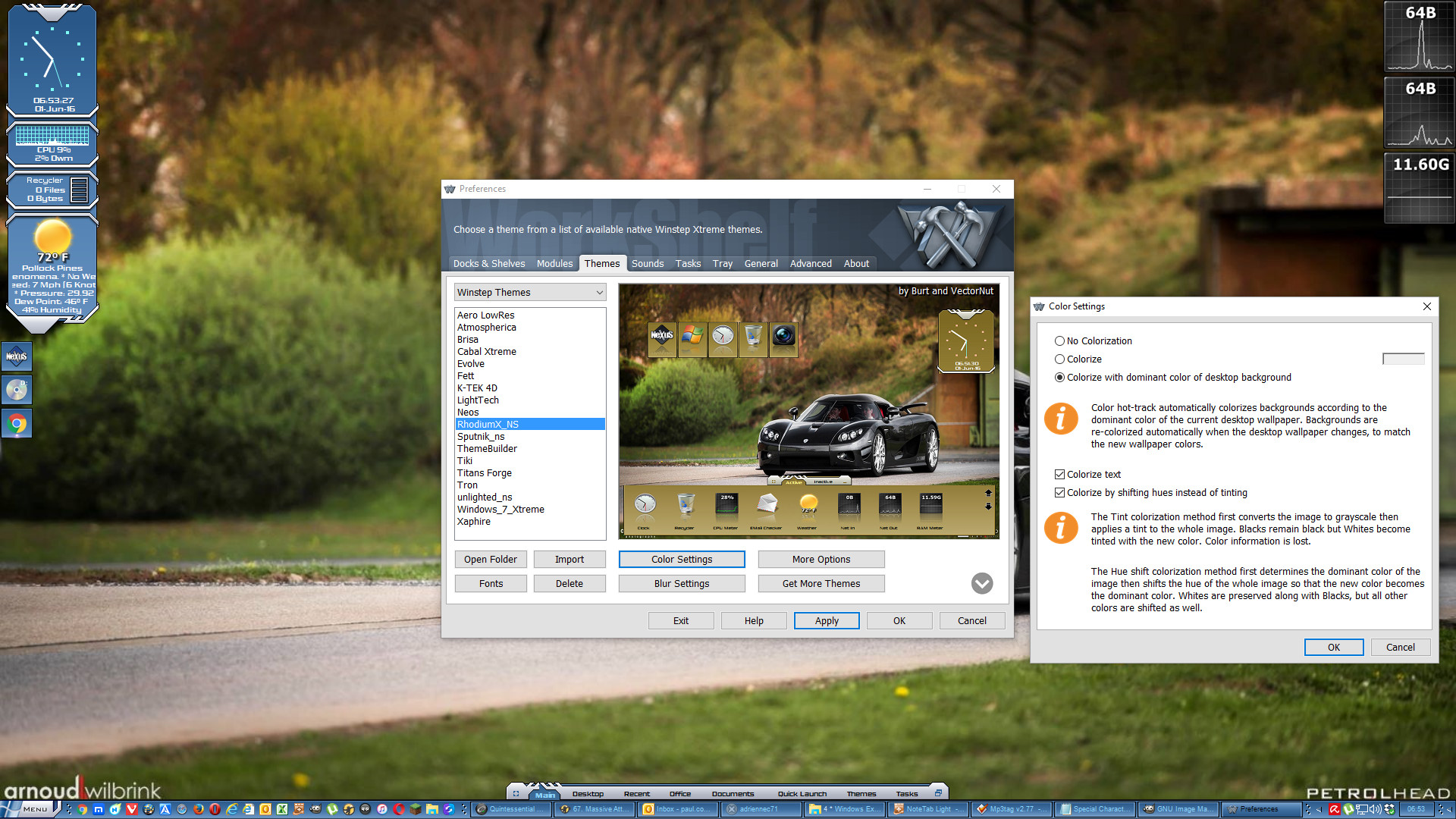

Here is a screenshot after exiting and restarting Winstep:
File comment: After exit and restart of Winstep
Now the colors are correct.
On a sidenote, you will also notice in the screenshots that the modules that don't have skins are dark grey in both shots, as I was mentioning before.
