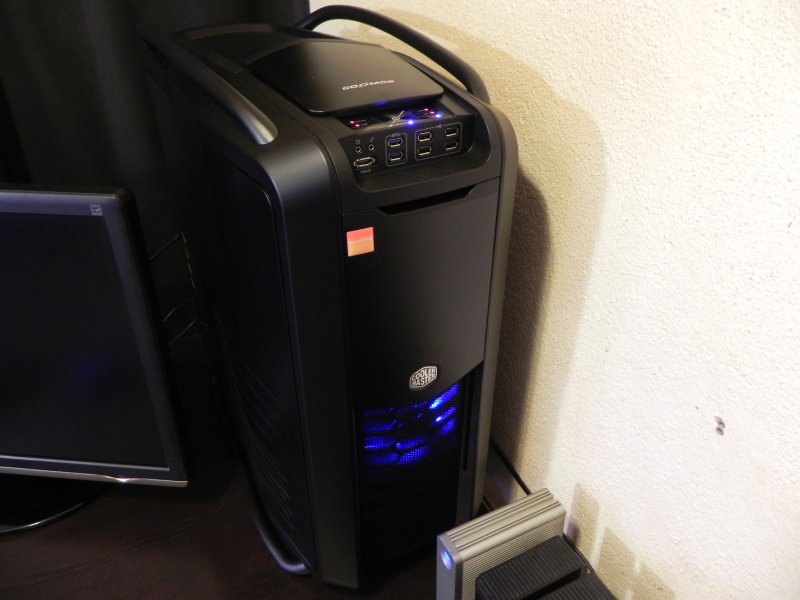

I can not get the Home Edition's drive temperature, but I can get the temperature of the Essential Edition drive that is connected by USB. And the temperature of the later would sometimes climb all the way up to 48? C, even when idle! Worse, by touching the enclosure of the eSATA drive I could feel it was much warmer than the USB drive.
I had to find some way to bring the temperatures of these drives down, so I came up with the idea of buying an el-cheapo Nox Sirocco notebook cooler with 3 fans and placing the external drives on top of it.
Made a small mod to the cooler and now the temperature of the My Book Essential Edition external hard drive is down to 28? C! That's even less than the temperature of most of my internal hard drives! :)
The following is a picture of the cooler:
This thing has three 70mm fans enclosed in an hermetic structure, which forces the air to come out through the grill at the top. The following picture will probably help you to understand this better:
What I did was to set the fans on max speed and tape shut all the grill holes around the two My Books, thus forcing the cold air propelled by the 3 fans to exit through the actual drives. I also placed a small object below the front of the cooler in order to turn it into a fully horizontal surface. The result has surpassed my best expectations! :)
If your external drives have passive cooling and are running way too hot, this is one possible solution. I guess it will work with any similar cheap coolers, provided the fans produce enough airflow.

Here is a picture of the mod I did to the notebook cooler. I moved the eSATA 1TB My Book a bit to the side so you can see the ventilated grill holes right below it:

Update:
The original article was written 3 years ago. Between then and now, a lot of things have obviously changed. :)
My system is now an Asus P8Z77-V Deluxe motherboard, Intel i7 3770K Ivybridge CPU at 4.5 Ghz (OC), 16GB RAM, two Samsung 830 256GB SSDs in RAID 0 (for system files) and two 1 TB internal hard disks (for data). One of the internal hard disks is a Samsung F3 and the other a WD drive that was previously an external hard drive.
For backups I now have two external WD 2TB MyBooks Essential connected via USB 3.0.
USB 3.0 is so fast that it essentially made eSATA irrelevant.
