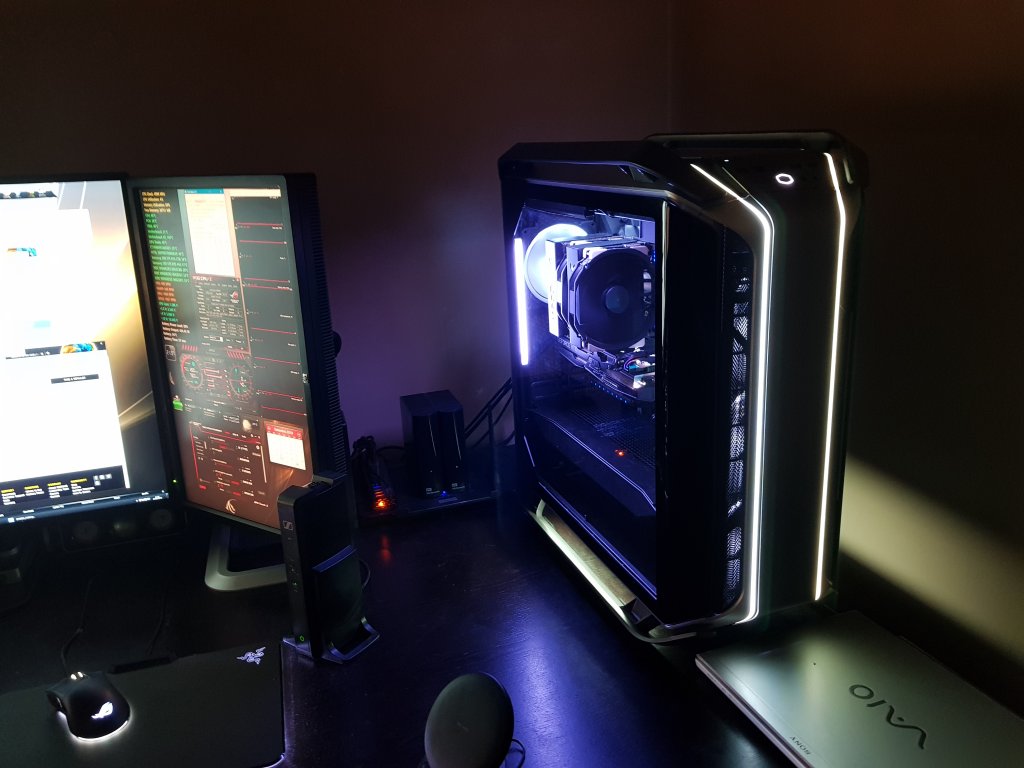

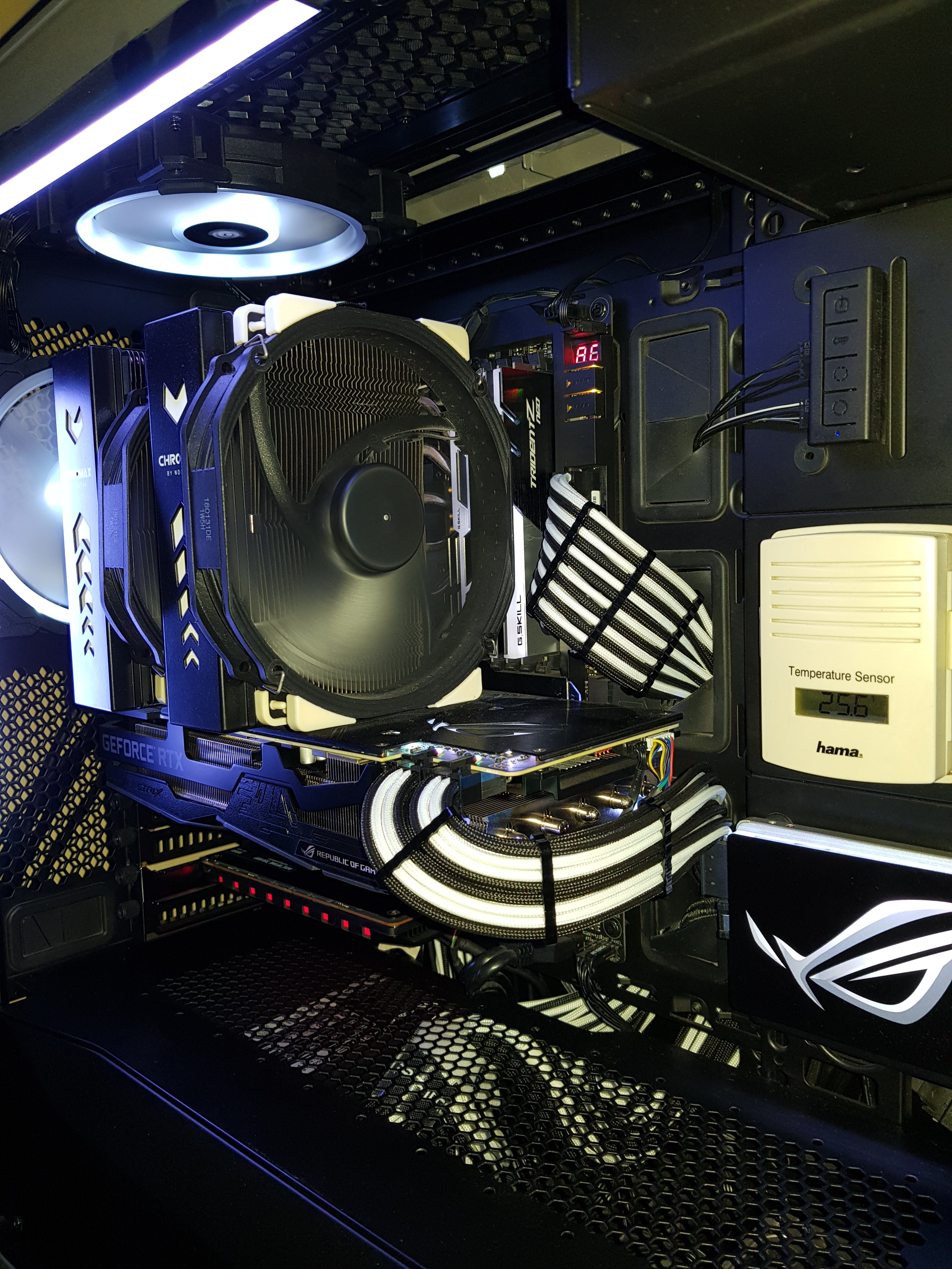

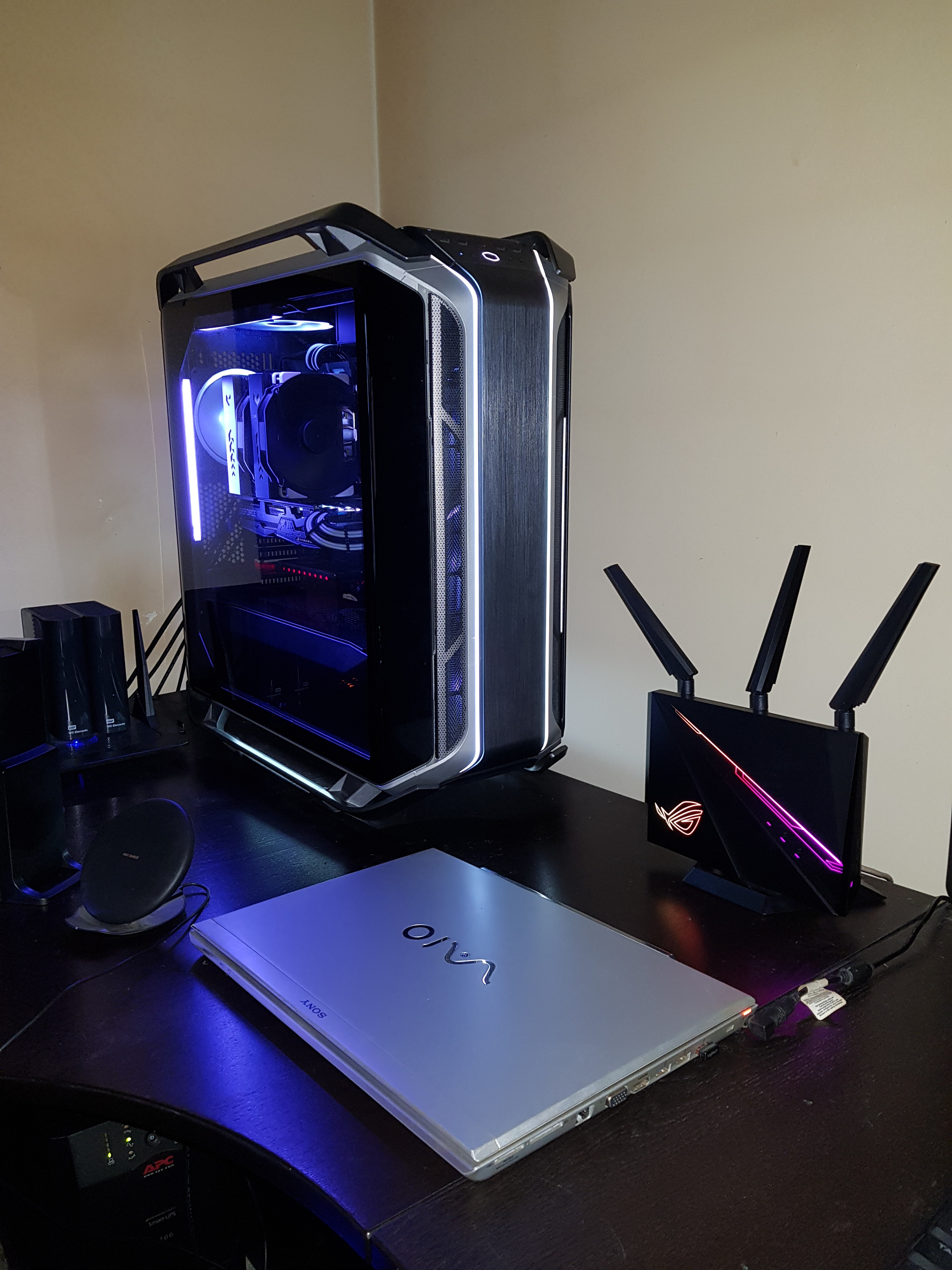

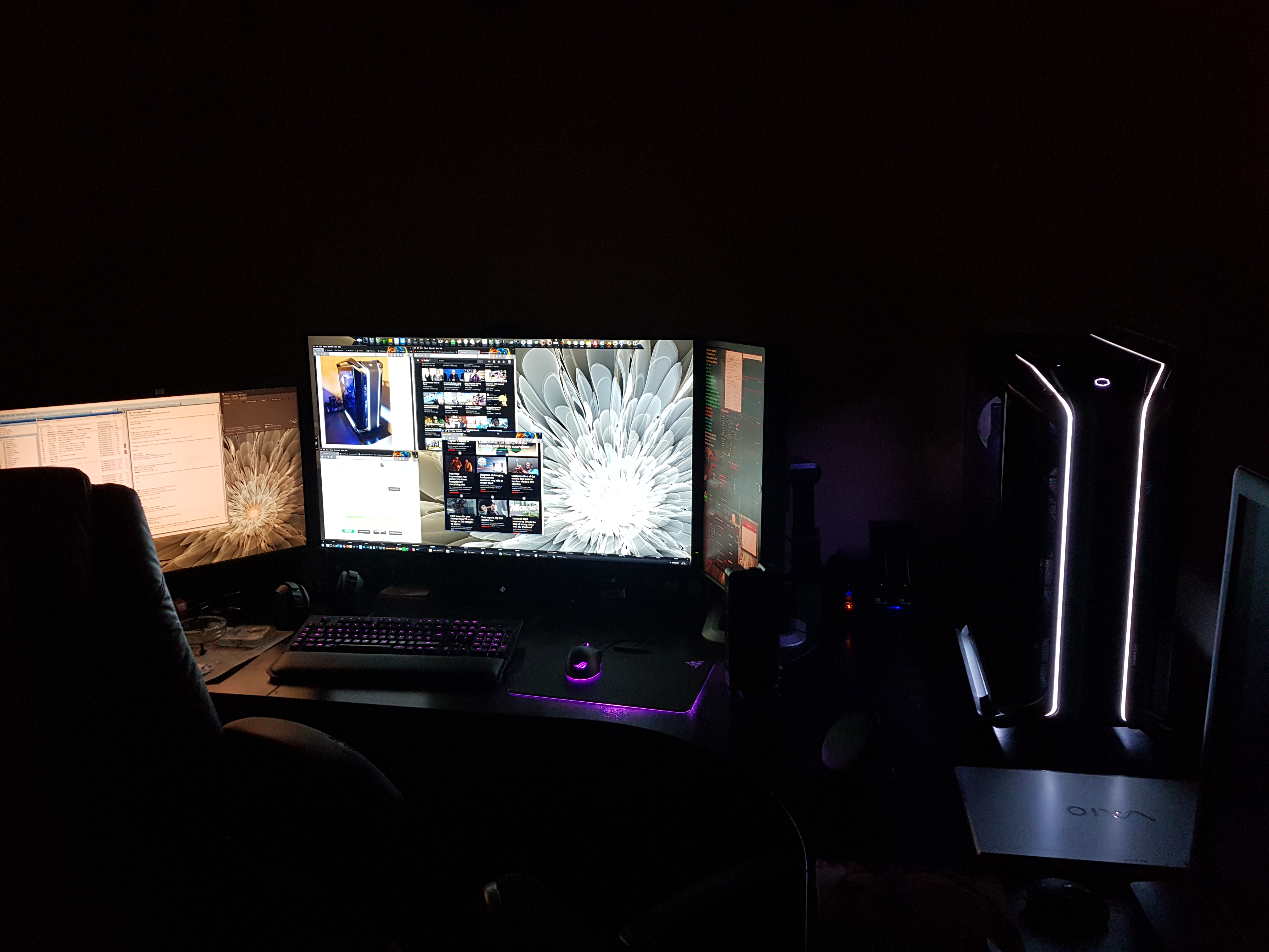

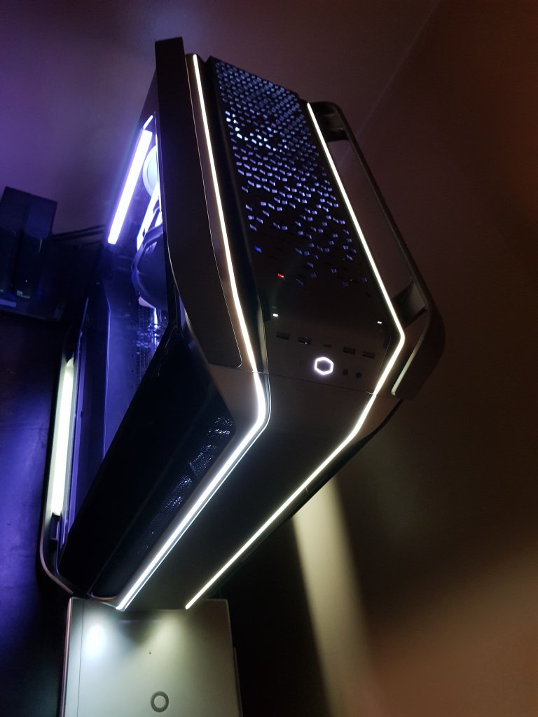

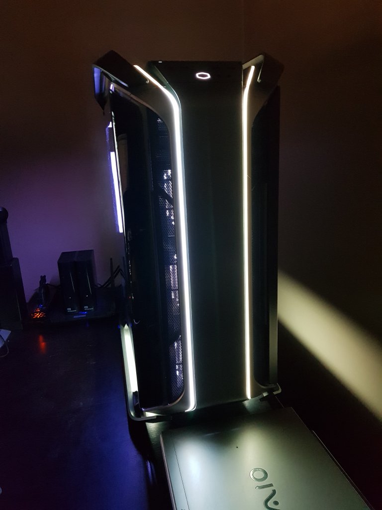

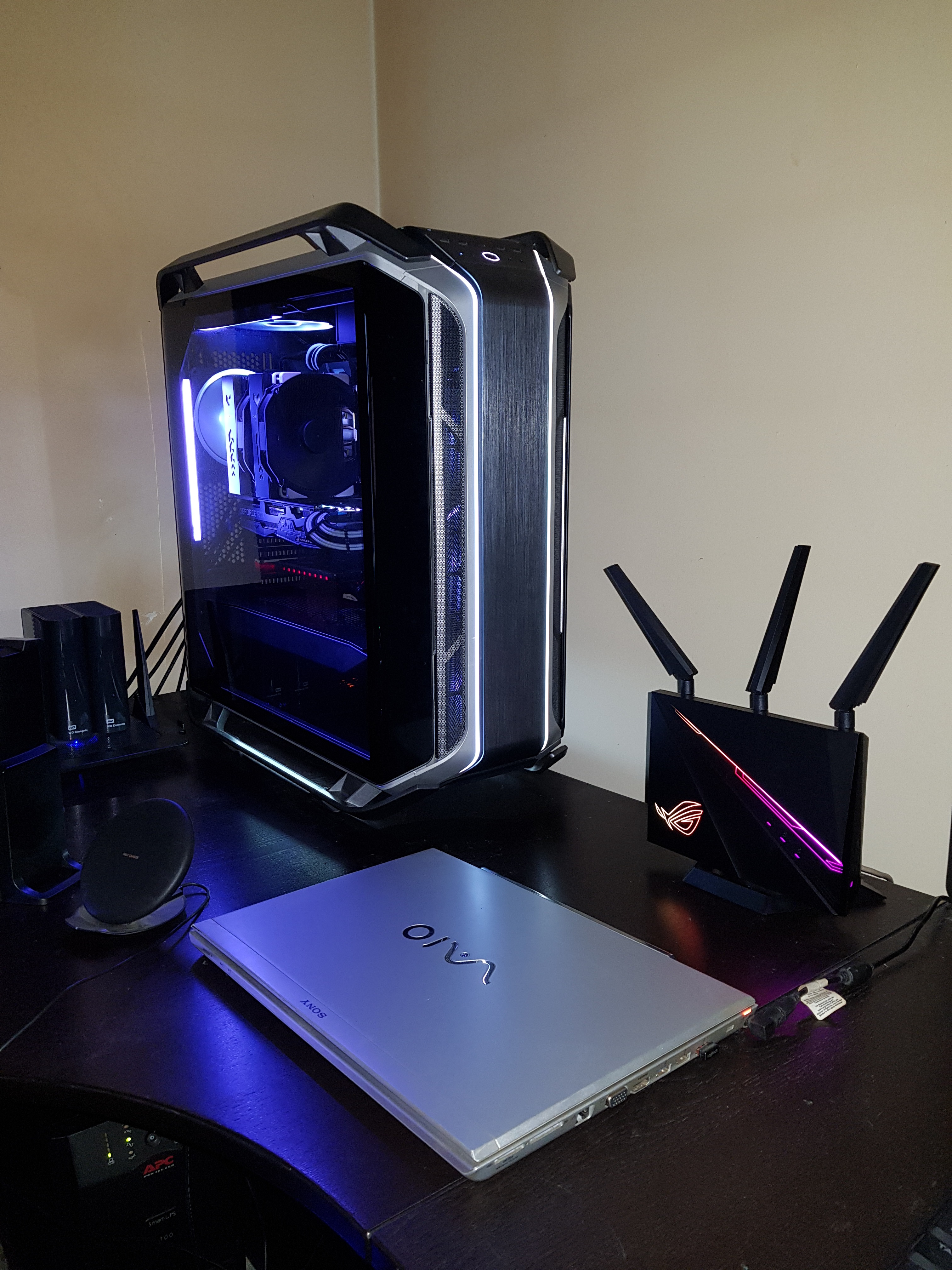

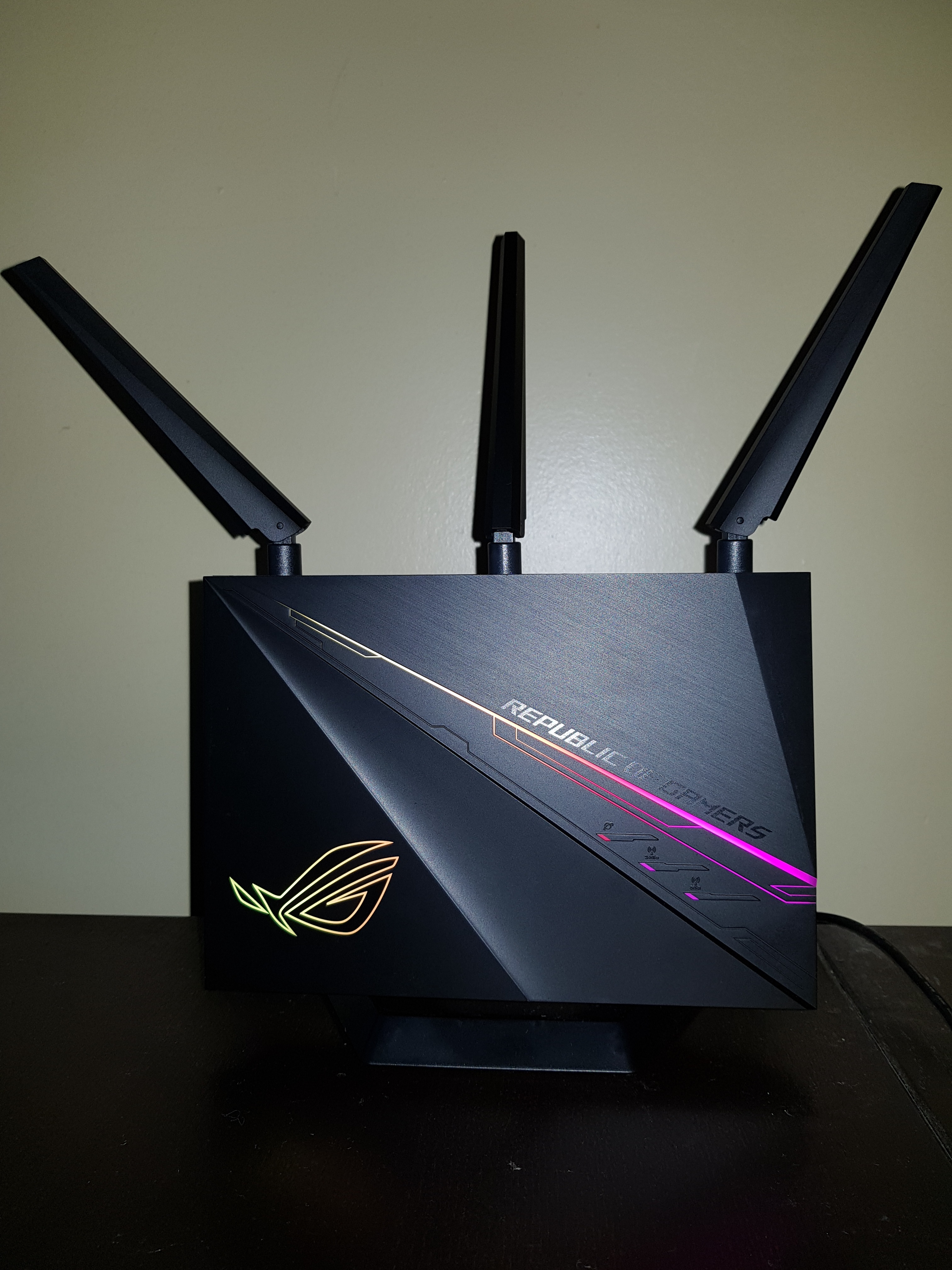

Ok, basically given up on having CM's MasterPlus software controlling the small ARGB controller and settled on a white/blue/orange RGB theme for the case, which is actually pretty nice while remaining sober. None of those flashing RGB colors for me.
I also got a custom made RGB SSD cover with the Asus ROG symbol for my (ugly) Crucial MX-500 SATA SSD and I think it looks pretty cool too.
In addition got a Cooler Master RGB bar which difuses the white light throughout the case and allows the white accents in the Noctua Chromax covers to remain visible even when the lights in the office are off. All in all, and despite the lack of success with the MasterPlus software, I'm pretty happy with the results:

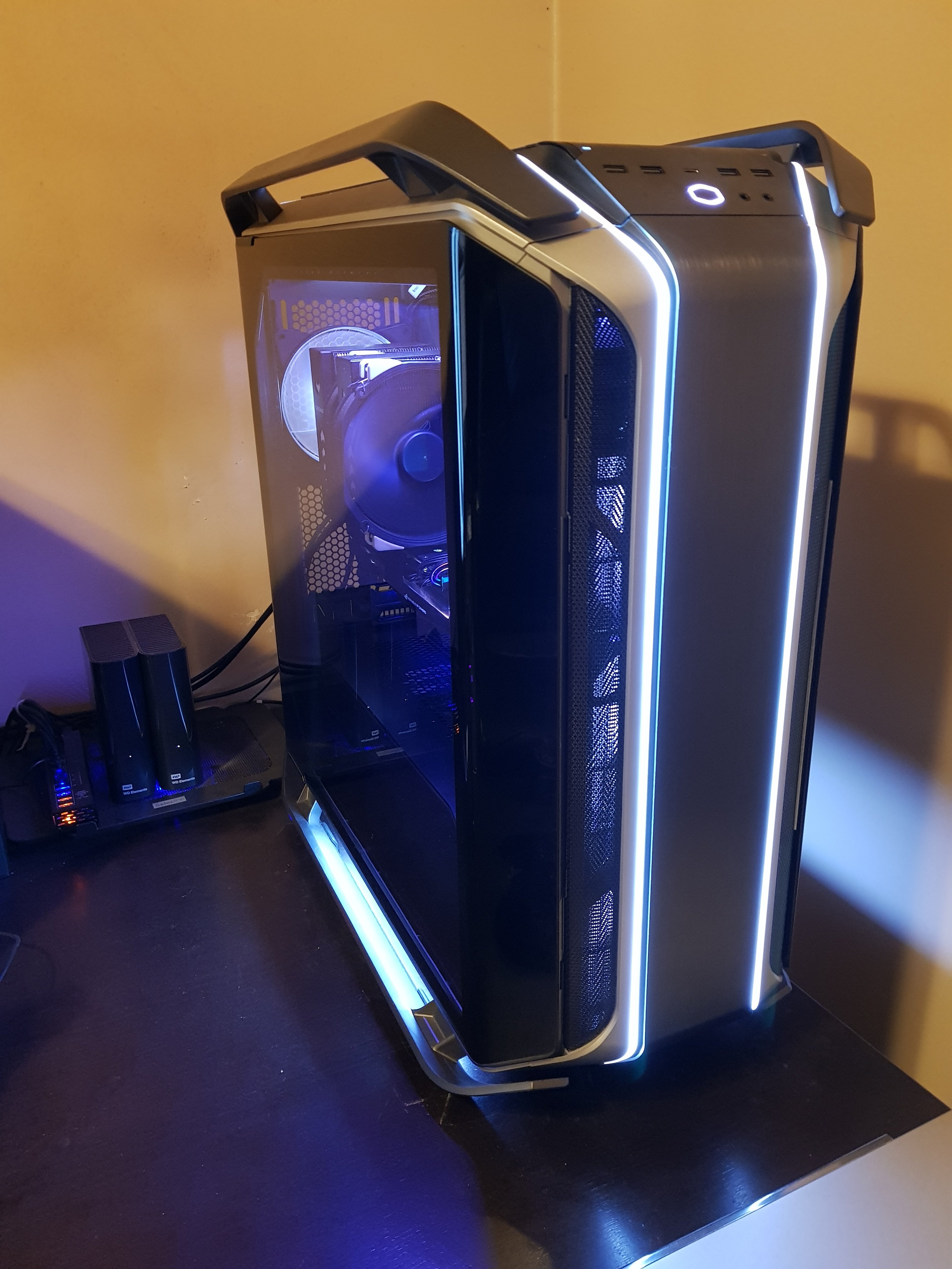

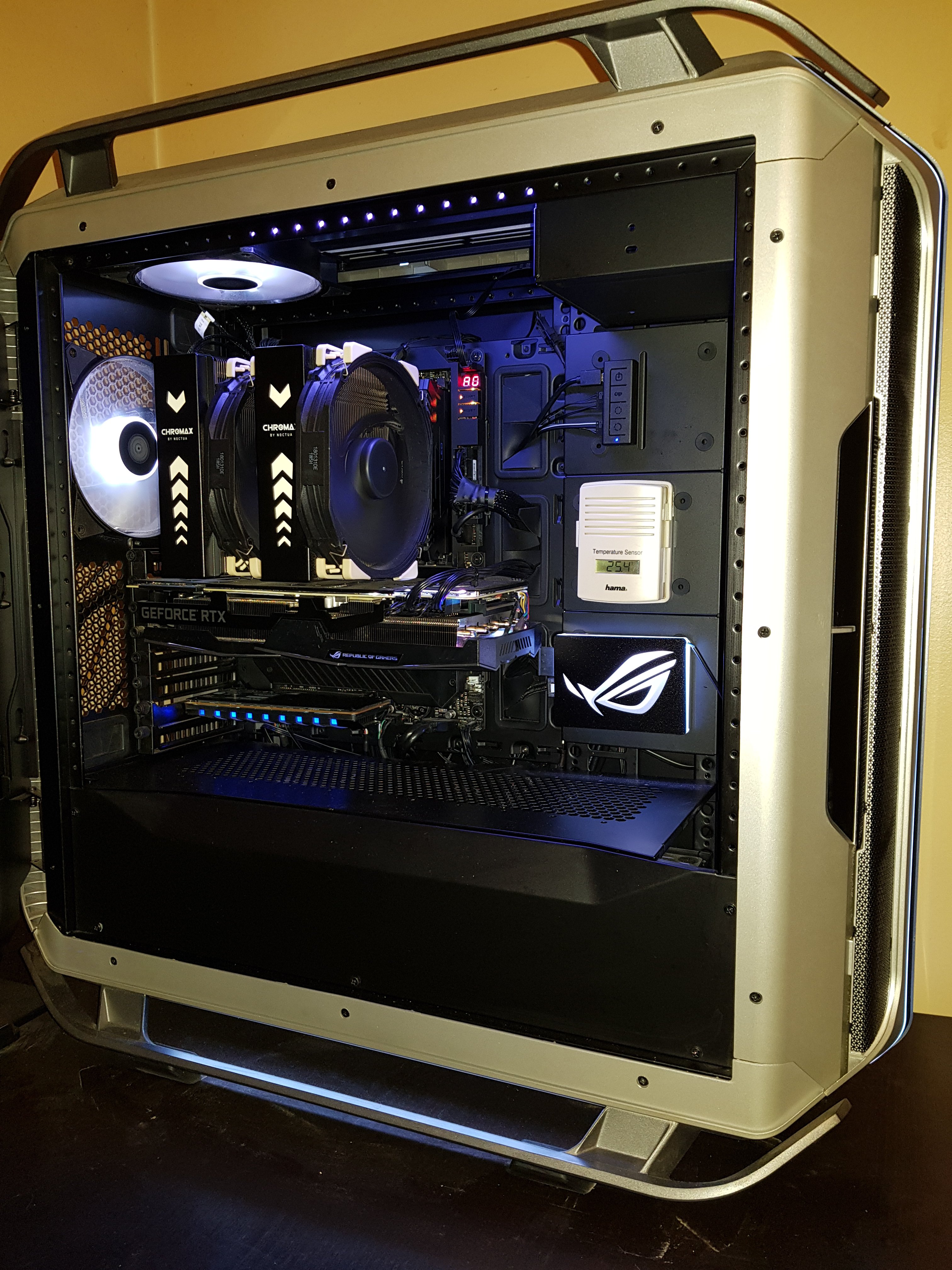

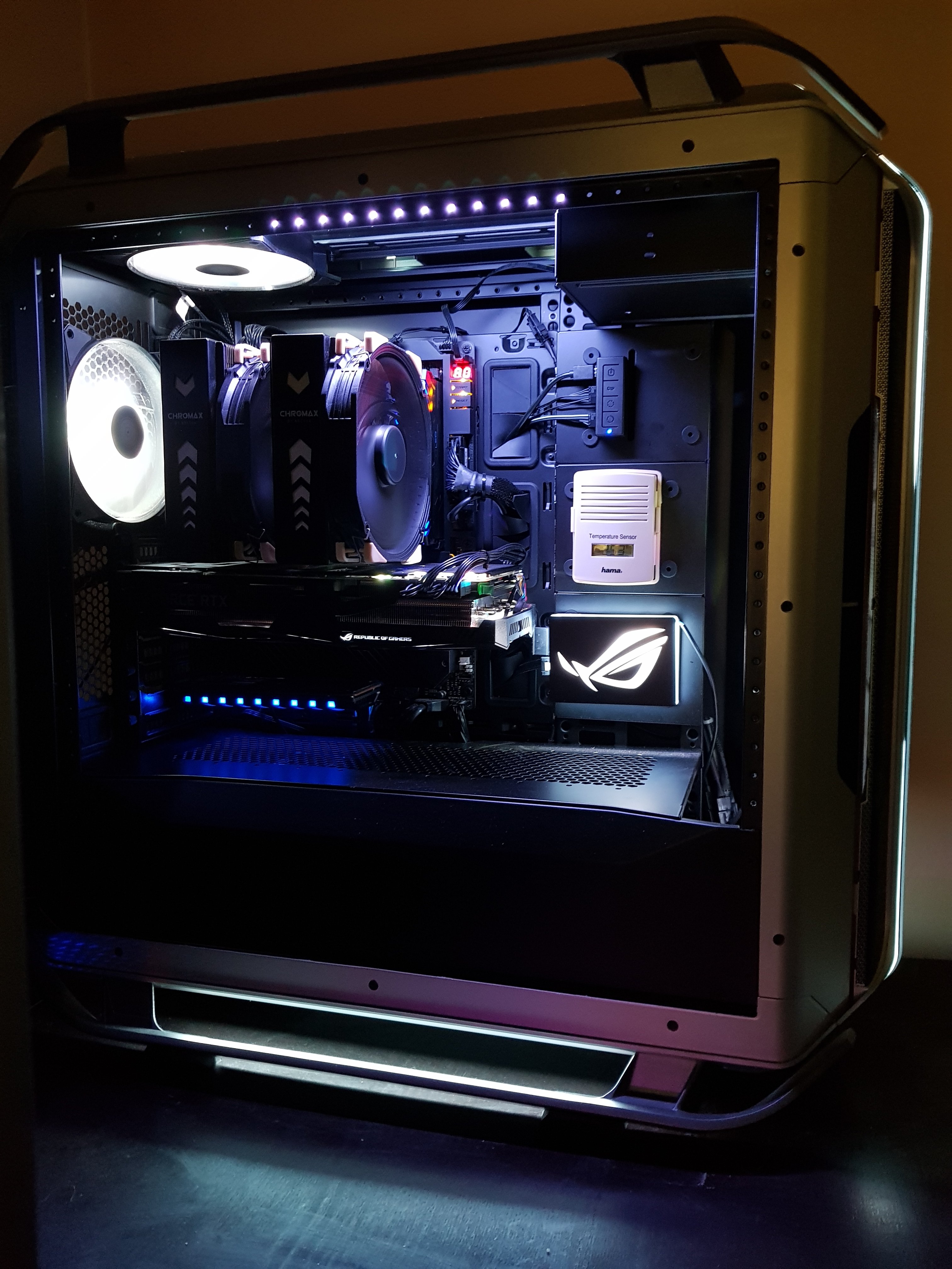

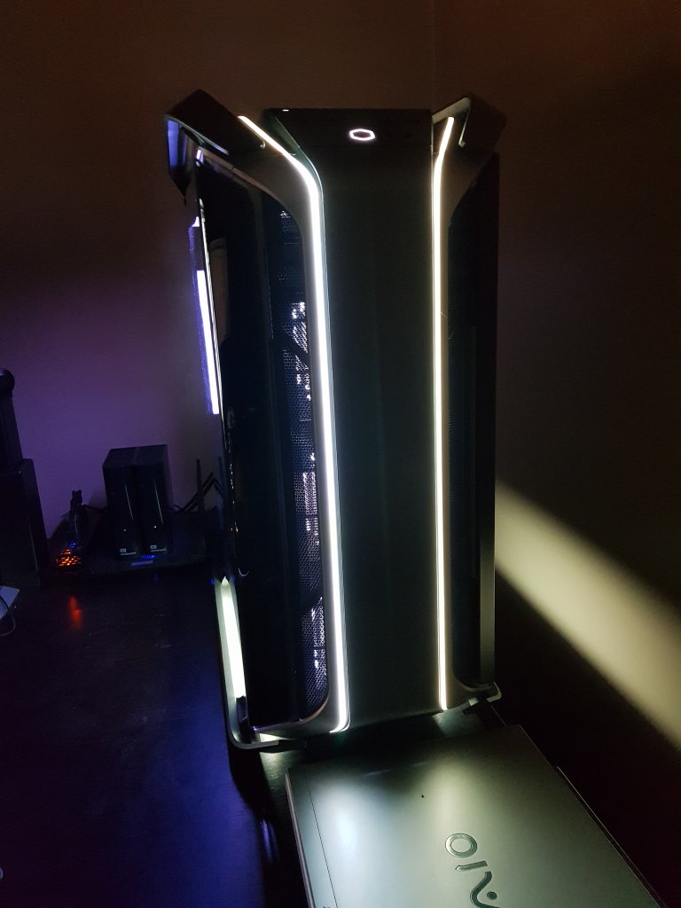

So, a small update to this:
Ended up replacing the Cooler Master MF140R ARGB fans with Corsair LL140 RGB fans. This because after a lot of experimenting there is no doubt in my mind that Corsair's iCue software is currently the best, more flexible and most complete RGB controlling software out there. The LL140 fans are also one of the most beautiful RGB fans available, with their independent outer and inner rings - but you do pay a premium for them as they are expensive.
It's appalling how bad Asus Aura Sync is given how long it has been in development, it doesn't even let you apply different effects to different components and anything other than static color effects basically hogs one of your CPU cores just so you can have pretty lights. Asus is another company that makes great hardware but terrible software. Cooler Master MasterPlus software is also not ready for prime time.
In the end this RGB stuff should all be standard so you could use the software you like the best regardless of component brand, but it isn't - each manufacturer pushes their end of the stick and if their software sucks.... you're stuck with it.
In the mean time the LED strips in the C700M, which were all a cool bright white in the beginning (when set to white, of course) are now turning to a dull yellowish white. All except one of the strips at the front, which makes it worse - from what I read this could be due to poor heat dissipation inside the strips.

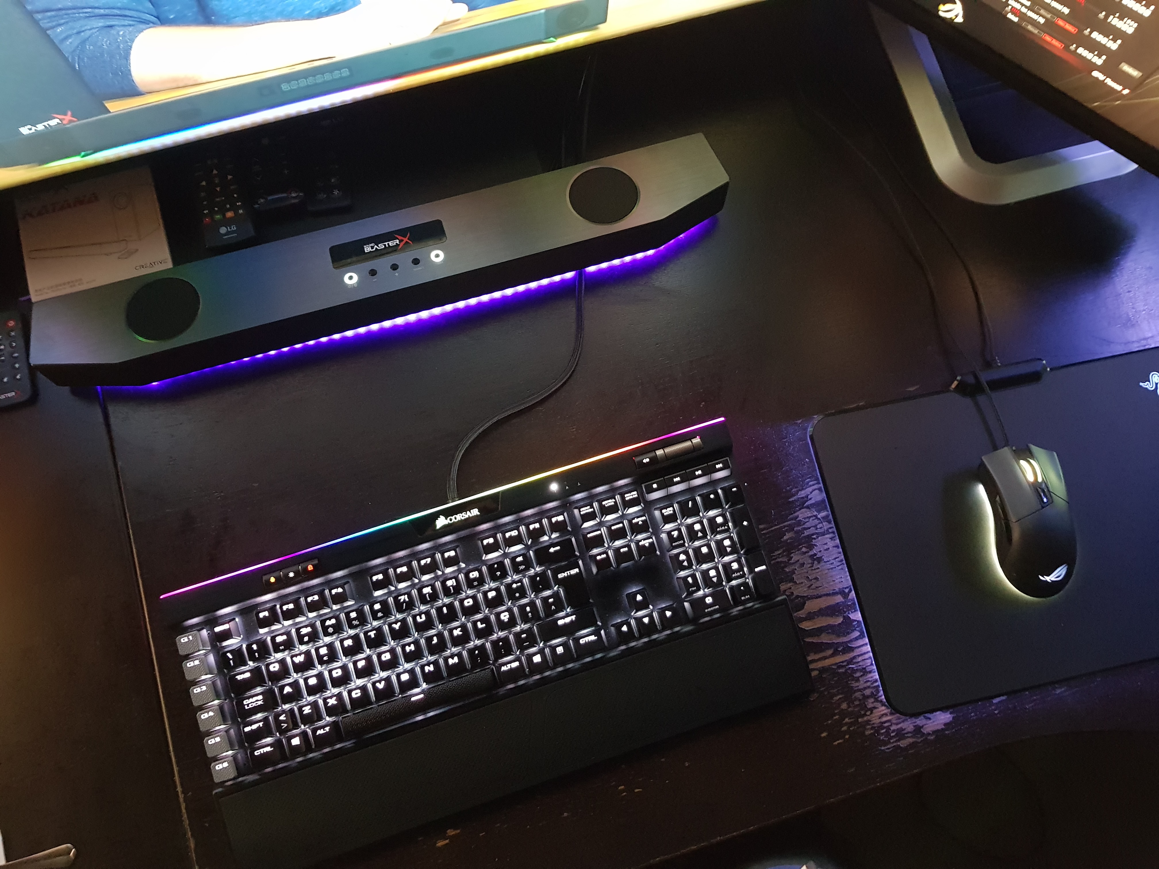

About a month or so after sending the Razer Mamba TE back on warranty due to the usual micro-switch problems and getting a ROG Gladius II Origin instead (still very happy with it), I was told by the shop I brought the Razer at that it could not be repaired and I would be given a credit note instead.
Some time goes by and given the good results with Corsair's iCue software I decided to use the credit to get a Corsair K70 MK2 Low Profile keyboard with Cherry Speed switches (there was nothing else I might want in that shop and the credit note had an expiration date, so use it or lose it).
The Corsair keyboard thus took the place of my Razer BlackWidow Chroma V2, which is actually a really nice mechanical keyboard (and has a superb wrist pad):
This said, the overall superior quality and brushed metal look of the Corsair keyboard (plus iCue being a hell of a lot better than Razer Synapse, e.g.; I can even combine multiple RGB effects together) sold me on the K70.
But here is the problem: try as I might (and I did for a long time) I could not get used to the Cherry Speed switches that came with the K70.
Probably because I have long fingers, that combined with the hyper sensitive switches meant a TON of accidental key presses, sometimes resulting in some sequence of control codes being sent that would create havoc with my browser as I was typing something and, more often than not, resulted in me losing whatever I had typed thus far. It didn't happen all the time, of course, but it happened often enough to become extremely frustrating.
So I bit the bullet and just got a Corsair K95 Platinum keyboard with Cherry Brown switches. Overall very similar to the K70, the K95 has a row of macro keys on the left side, taller keys (i.e.; it's not low profile), an extra cool looking RGB strip on the top of the keyboard, three hardware RGB profiles, and it also has a dual mode magnetic wrist pad (so you can choose between a smooth or a textured surface).
I only just got the keyboard so I am still getting used to it, but already run into two problems: because of the extra row of macro keys at the left that the MK70 did not have, my hands are now in the wrong position: I keep hitting CAPS LOCK when I want to hit the A key and so on... I don't think this is a biggie as it should simply be a question of getting used to shifting the 'home position' of my hands one key row to the right.
The other issue might be, I think, a bit more problematic: take a look at the position of the ESC key in the K95 and compare it with the position of the same key on the Razer keyboard. Notice the difference? On the Razer the ESC key is the leftmost top key (as it should) and the macro keys are below it. On the K95, however, the G1 key (first macro key) is on the same horizontal row as the ESC key, in other words, where you would expect the ESC key to be. This means I keep hitting G1 when I want to press ESC.
Personally I think this is a MAJOR ergonomic blunder on Corsair's part, and is also a common complain I see on Amazon user reviews of the K95. Let's see if this is something I can get used to - other than that, the 'accidental wrong key presses' that used to happen on the K70 have stopped completely. Yay! :)

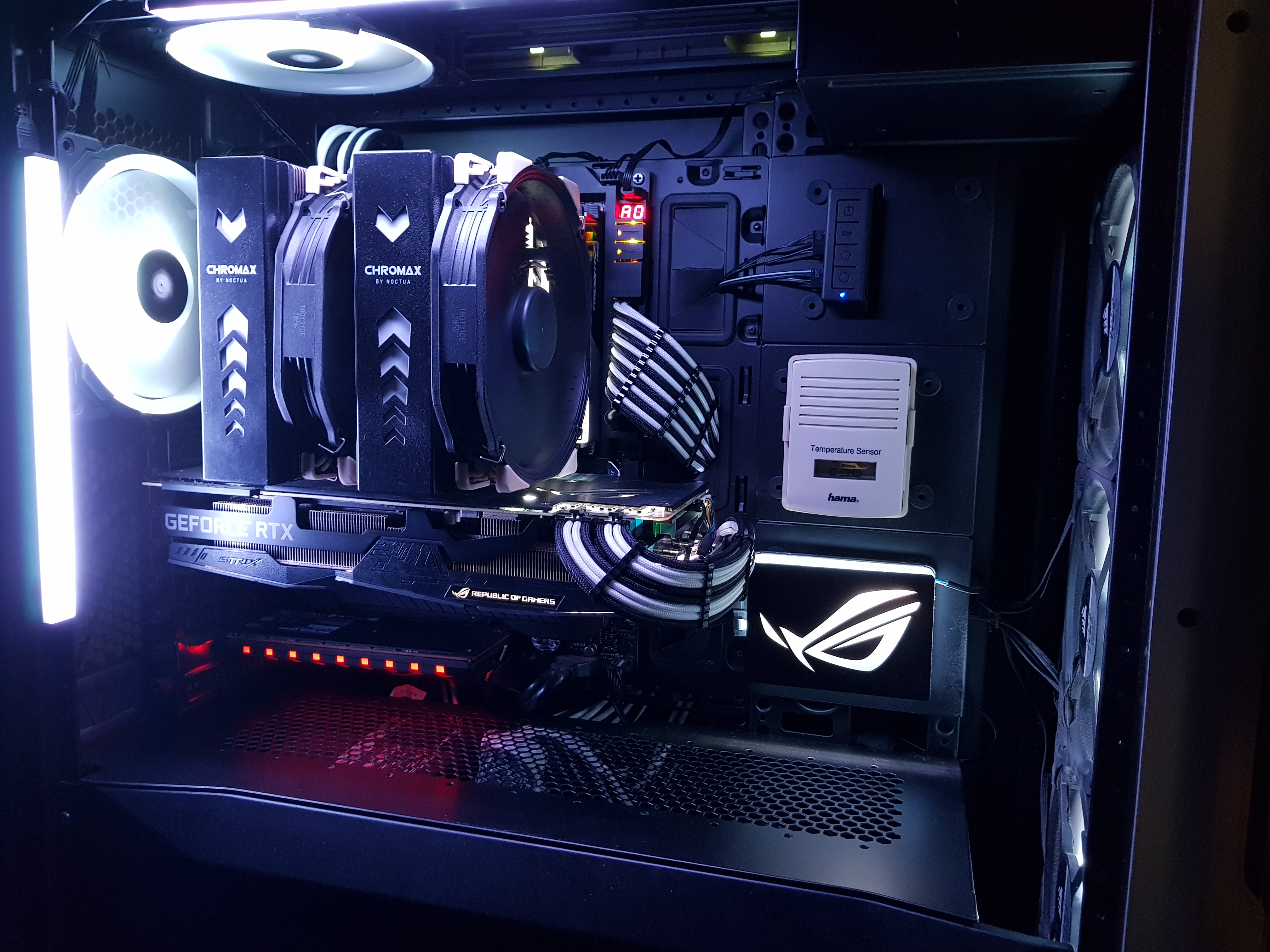

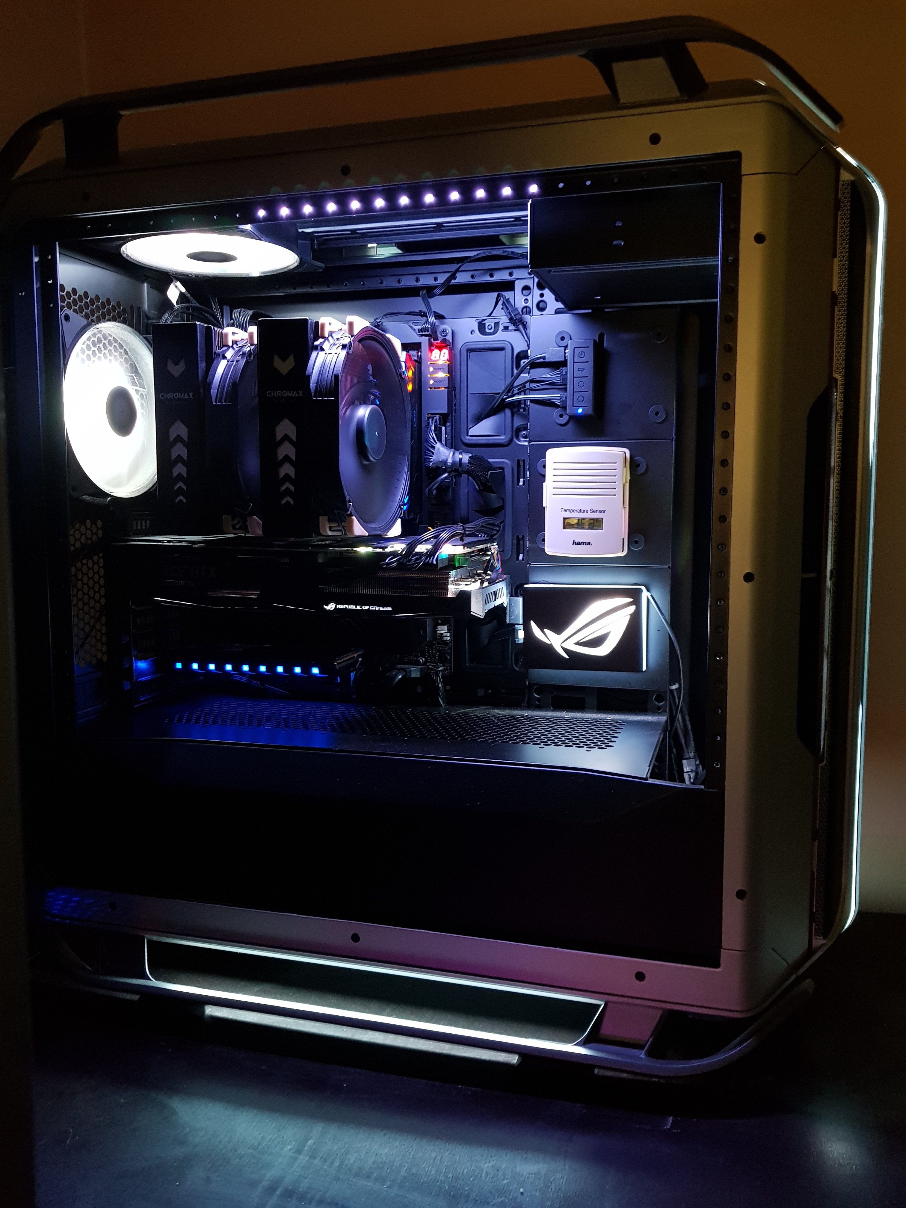

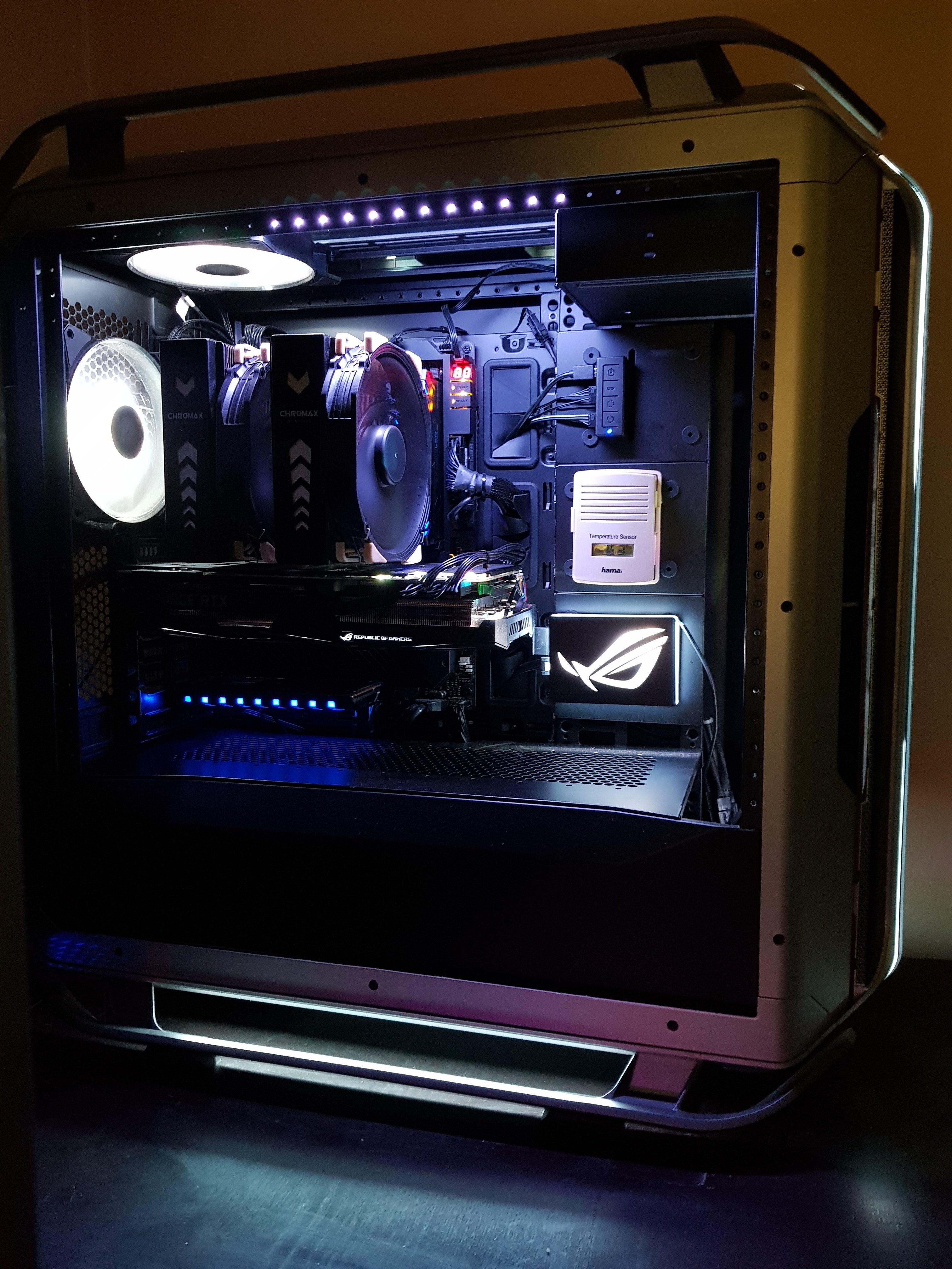

So, to give an update on the system (looks like I am always tweaking things here lately eheh):
To start with I ordered some customized black and white cables from Cablemod. Took them a while to get here and they were pretty expensive, but I think the result was worth it:

My ISP's cable modem is also a router and is actually located in the living room next to the tv and the tv box (and both connected to an APC 900VA UPS). The office is actually in another room, so I have a CAT6 cable that runs through the wall from the ISP's router to a socket on the office's wall.
Until now I had an ASUS 8 port gigabit switch connected to a LinkSys WAP300N Access Point for my own private wireless network. The wireless protocols supported by the LinkSys Access Point, however, were already not up to date (maximum speed was something like 144 Mbps, IIRC). My Internet download speed is 500 Mbps and upload speed 100 Mbps, FYI.
Also, anyone connecting their phones to the ISP's router network would also have access to my computers, and even though all of them were password protected and only people I knew were allowed to do this, I was not too kin on this idea.
So I ended up getting an ASUS Wireless Router GT-AC2900 to replace both the switch and the wireless access point. Being a router with a built-in firewall it isolates my network from the network provided by my ISP's router.
Also best of all it has - you guessed it! - RGB! Yay. Makes it 10% faster too. :wink: :P
The ROG Rapture GT-AC2900 is an 802.11ac (Wi-Fi 5) dual-band router that supports maximum data transfer rates of up to 750Mbps on its 2.4GHz network and 2,167Mbps on its 5GHz network, which is plenty for most current generation client devices. It even supports DFS.
DFS stands for dynamic frequency selection and it’s a useful feature that isn’t supported by many routers. In a nutshell, it allows the router to use less congested channels that are typically reserved for government services. Since these channels are less congested, users can get better Wi-Fi performance by using them.
The firmware inside the router is also pretty sophisticated, allowing me to do sorely missed things such as analyzing traffic per device, etc... Needless to say, not only are wireless speeds much faster than before, as the wifi coverage was also greatly increased (a bonus for watching Netflix on the smart tv that is upstairs in the bedroom).
And the bloody router is also gorgeous to look at ehehe.
