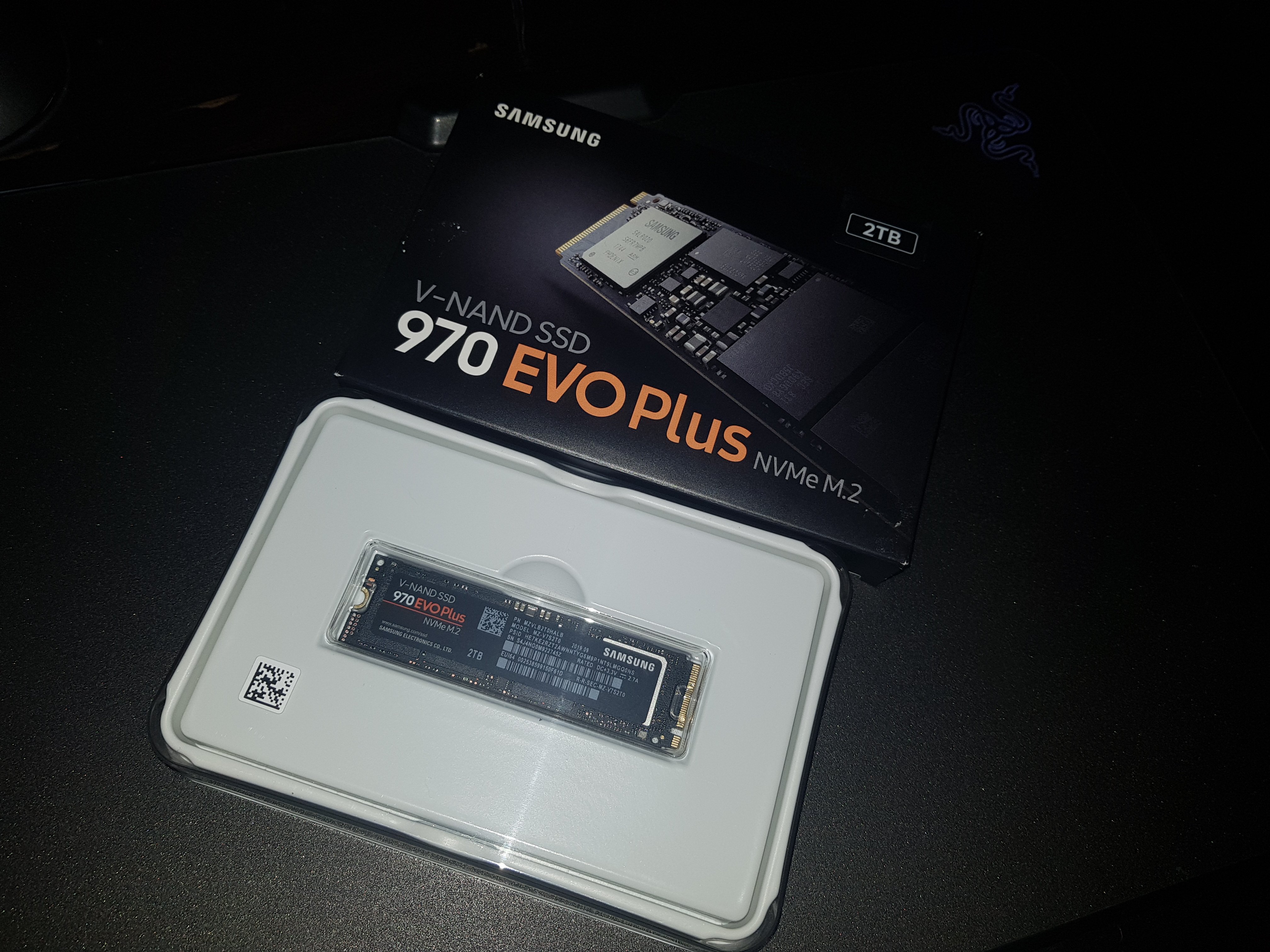

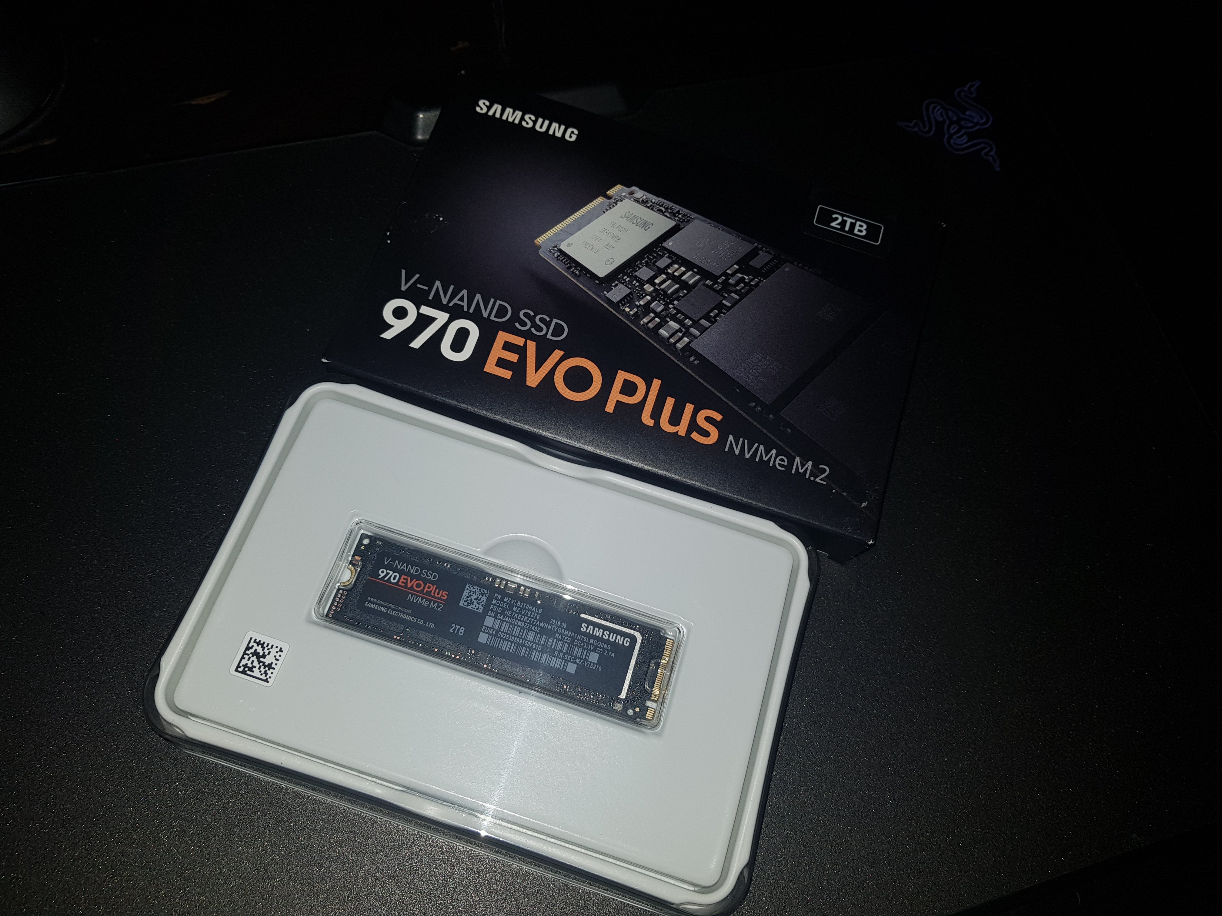

Either way I overnighted a new 2TB 970 EVO Plus from Amazon.it - I would have to get a new drive anyway since I would have to have something to replace the old EVO while it was on its way to Samsung.
Good thing I did too since Samsung were adamant about the screenshots of the drive BEFORE issuing a RMA (which pissed me off a bit, although I understand why they want this).
So when the new drive arrived I removed the NVMe heatsink on the motherboard, installed the new drive (this motherboard supports up to two NVMe drives), copied all the data over from the old 970 EVO to the new 970 EVO Plus, removed the old 970 EVO and took the screenshots they asked for. A few hours later I got the RMA from Samsung.
Hopefully they will send me a *new* 970 EVO back, and despite now having one more NVMe drive than I really need, at least I won't be also stuck with a failing NVMe drive (or a drive that cannot be trusted, which is the same) that cost me over 600 Euros a little over a year ago (the new 970 EVO Plus is not only a bit faster as it is also cheaper, it 'only' cost 450 Euros).

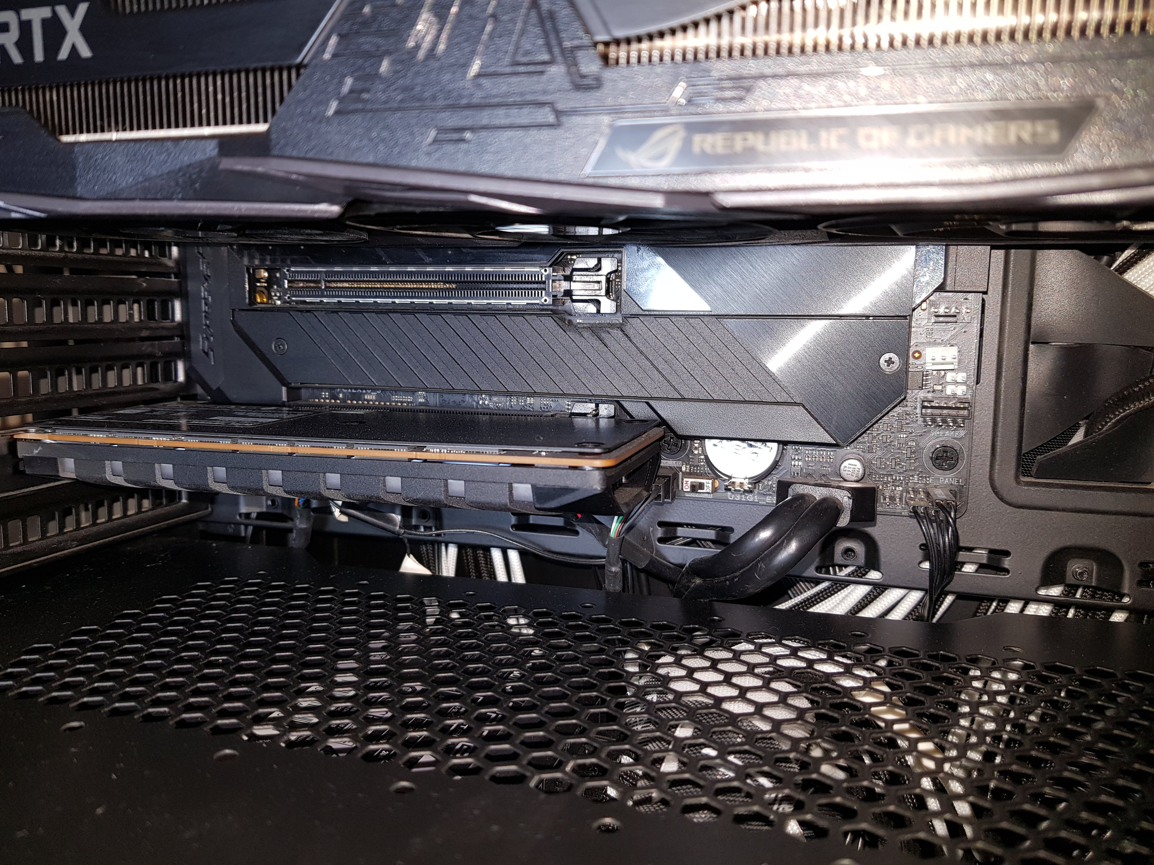

The heatsink on the motherboard, below which you install the NVMe drives:

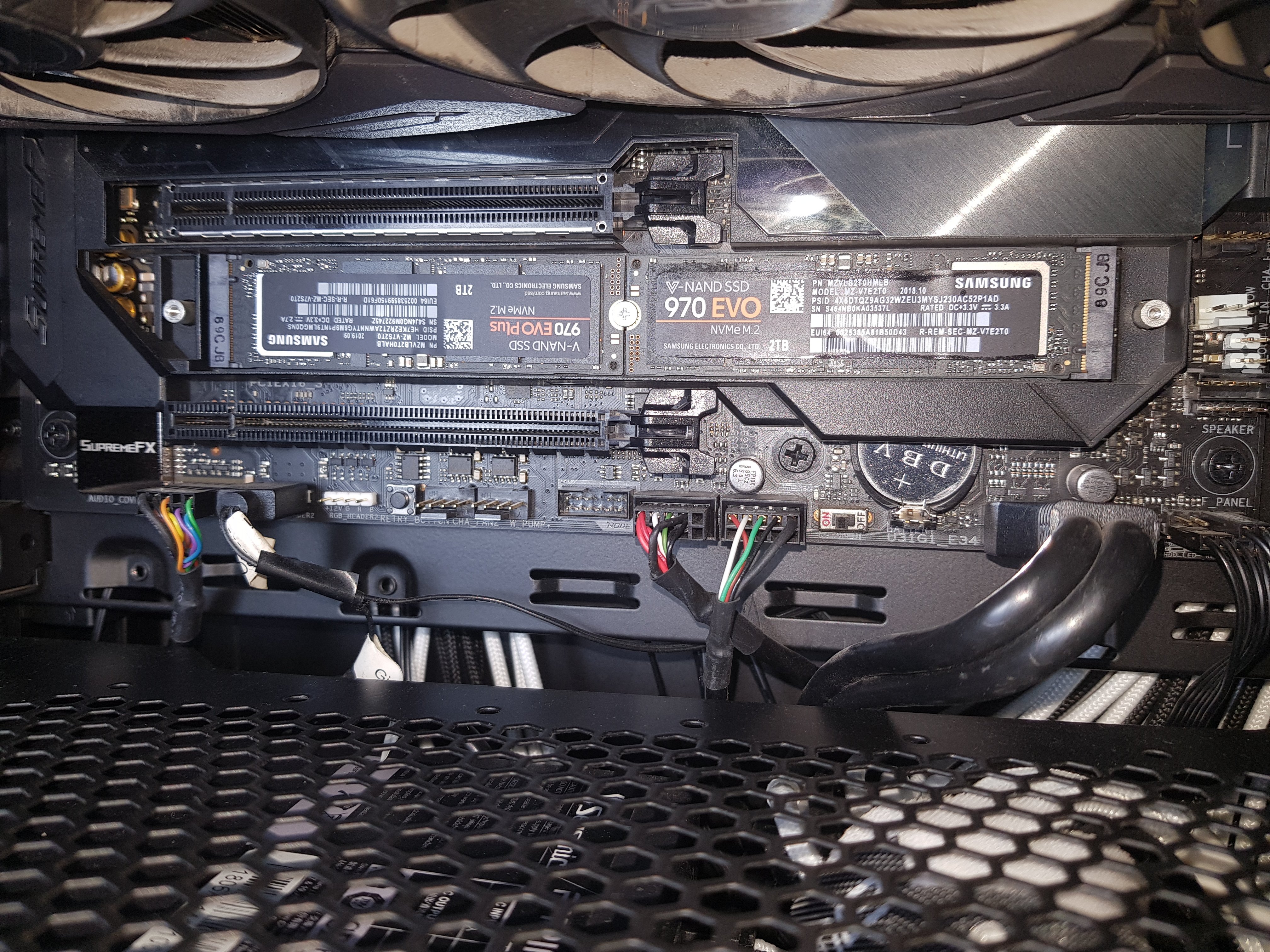

The two drives in place without the heatsink and with the Intel Optane temporarily removed for 'elbow space':

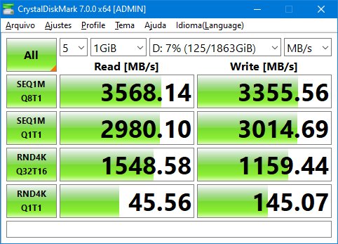

And here's an updated version of the original benchmark after I turned off the Meltdown and Spectre protections. There didn't seem to be a whole lot of difference in speed for me.

Hmmmm... back when I did that, over a year ago, it made a huge difference (check the last two screenshots). Perhaps by now MS has changed the drivers, etc, so there isn't such a huge performance penalty? Or maybe that utility is no longer doing anything? lol
EDIT: Just tried running the benchmark again and the numbers are pretty similar (if a bit higher in fact) to the numbers I got last year AFTER disabling the Specter patch (Ah, note that I am using version 6 of Crystal DiskMark, you are using version 7, results cannot be compared).
 Post subject: Re: New system is here: Intel Optane 905p inside!
PostPosted: Sat May 02, 2020 8:47 pm
Oh, I see. They changed how some of the tests are performed in 7.0. (https://crystalmark.info/en/software/cr ... k-history/)

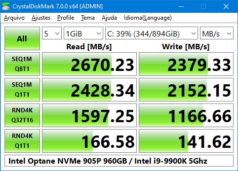

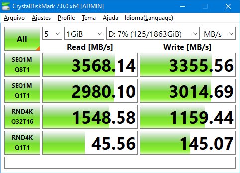

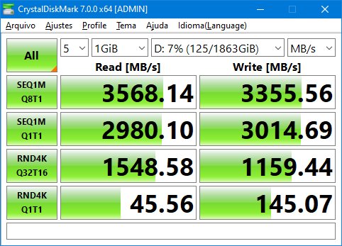

For comparison here are the results on v7 for the Intel Optane and my 970 EVO Plus 2TB:
This is the Samsung EVO:
And this is the Intel Optane:
Weird thing though, the 4K values for the Optane should be in the 245+ since that is where it excels. Ah well. :)
