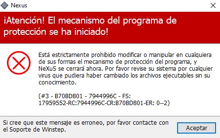

Hello, I have this problem. After a while running, I get this error. What could it be?
File comment: error

Means something has changed the nexus.exe executable file. If you didn't do that, then uninstall and re-install Nexus (make sure to download it from the Winstep web site and install that version) and check your system for viruses.
Before uninstalling you should make a backup of your settings to a temp folder in your hard drive, and when prompted during uninstall if you want to remove everything plus the settings, ALWAYS say NO.

thanks, i will try!

Also, check your Windows Event Log for hardware errors, to make sure your hard drive isn't failing and corrupting data on the disk.
