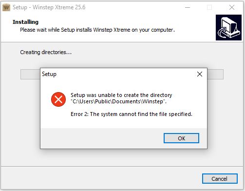

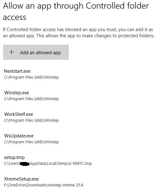

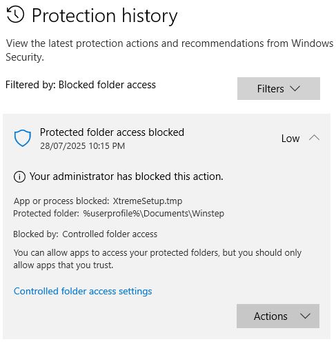

This issue also applies to Windows 10 IoT Enterprise LTSC (21H2), as it has some additional security controls enabled. In this case, the feature is "Ransomware protection -> Controlled folder access".
This blocks the same folders as mentioned in the original post above (see attachment 1), and causes the Winstep installer to fail (attachment 2).
The solution is to add exceptions via "Allow an app through Controlled folder access" (see attachment 3).

My guess is that eventually I will have to change the default installation from Public Documents to Program Data. Program data is also available to all users, but the problem with Program Data is that it is a hidden folder.
And what if ransomware starts targeting Program Data too (it actually targets everything already doh) causing Microsoft to decide that Program Data should also become a protected folder? Game of Whac-A-Mole...
Public Documents was a perfectly legit folder to store data (and indeed the logical location if you actually want users to go there, given that Program Data is hidden) until security software decided that anything writing to it can - obviously! - only be malware. Can't fix stupid.
