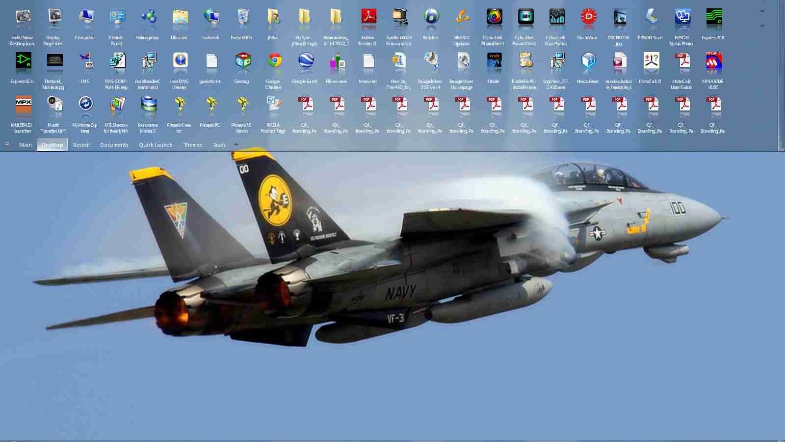

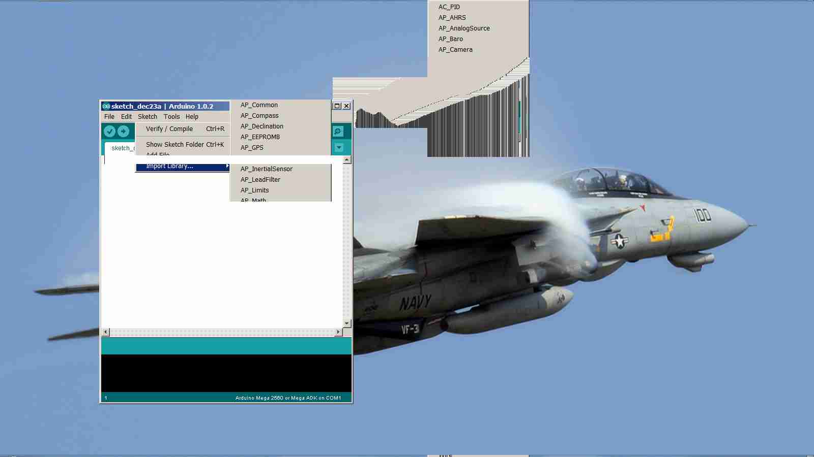

Here are the screen captures.
File comment: This shows the drop down region of the top dock.
File comment: Here the application has raised a menu that extends over the application client area and the dock region. When the app window is moved the menu overlapping the dock remains on the screen, and the menu in the client area remains and is carried by the app window.
When Winstep is shut down, or the dock is turned off, this problem does not exist.
The problem also applies to any other docks, ie. the dock that pops out from the rhs of the screen.
Hope this makes things clear.
