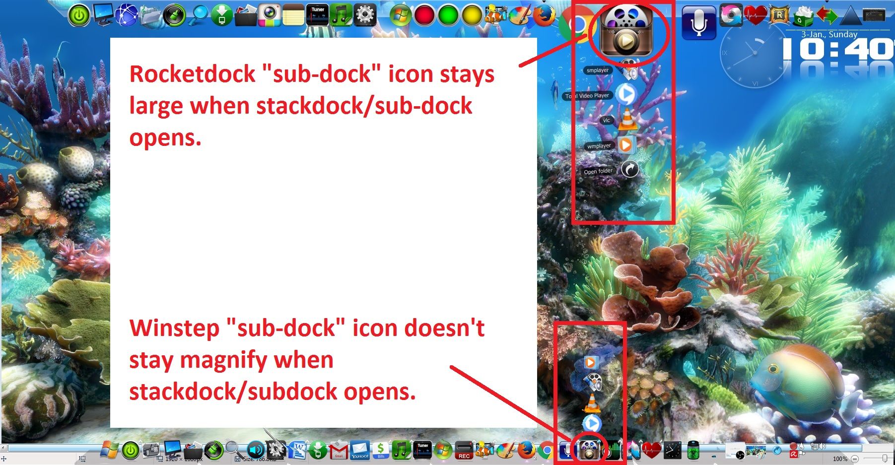

There is this one thing that keeps bugging me. Hopefully it's in the setting somewhere, but I can't find it. The below picture and video illustrates my concern.
I have both Rocketdock and Winstep Xtreme active on my desktop currently to do some different testing. I have both docks set to purposely magnify moused over icons.
Subdock/Stackdocks: As I mouse over docked icons and click to open subdocks, rocketdock's subdock icon will remained magnified as the programs within the subdock reveal themselves. On the other hand, Winstep, automatically stops the magnification process when the subdocks open.
Is there a way to have the subdocks behave like they do in Rocketdock? because it actually feels smoother opening up subdocks/stackdocks in Rocketdock than in Winstep.
This one particular aspect seems more polished in Rocketdock than in Winstep, while everything else as I can see is more polished in Winstep than in Rocketdock. It's just this one little tidbit that's bugging me.
EDIT: If it's not a "subdock," and simply a "program," the magnification process works perfectly in Winstep. In other words, it can be done. But when it comes to 'subdocks' that's when the experience differs. The video below shows "programs" remains magnified when opening. I simply would like to get 'subdocks' to remain magnified when opening as well.

The problem is that you are trying to compare Apples to Oranges. Can't be done, sub-docks and Stacks are different animals.
Sub-dock functionality came to life long before MacOSX and its magnifying dock. Back then each icon in the dock had a square background tile, and icons did NOT magnify. So, when you opened a sub-dock, it would be a perpendicular extension of the parent tile, and aligned perfectly with it.
If you try to do the 'sub-docks align with parent' thing with magnifying docks, what happens is that when the parent dock magnifies the magnified icons will partially overlap the sub-dock, preventing you from freely accessing all elements in it. Very, very, cumbersome. So, a decision was made many years ago to prevent the parent dock from magnifying when you open a sub-dock - this keeps the parent dock out of the way, while still allowing the sub-dock to align with the parent dock.
Stacks do not suffer from this limitation because the icons in them have no background(s), they're just free floating icons that can be placed anywhere, even at an elliptical angle.
A similar issue happened with how sub-docks were opened in the past: before magnifying docks, a sub-dock icon could also be used to run an application. To open the associated sub-dock, you would click on the 16x16 sub-dock indicator symbol instead. Clicking on the icon itself would launch the associated application rather than opening the sub-dock.
This worked fine until magnification came along. With magnification, the sub-dock indicator no longer stays in the same place, it moves around as you mouse over the icon and the icon size changes, making you chase after it. This makes hitting such a small target a hit-and-miss affair - again, perfect before magnification, too cumbersome afterwards. So now sub-dock place-holder icons are no longer allowed to 'double-up' as regular dock shortcuts.
The only solution to what you mentioned is to come up with my own version of the Stacks docklet, which has been on the to-do list for some time now.
