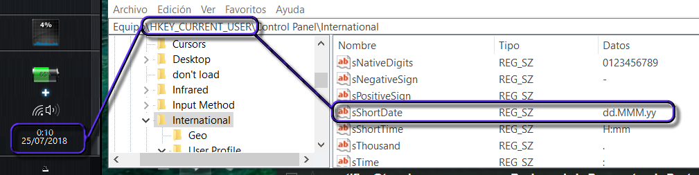

PostPosted: Wed Jul 25, 2018 4:18 am
Posts: 31
No, they can't be configured, both the date and the time are displayed in the short format specified for LOCALE_USER_DEFAULT .
Then I think there's something wrong. Please see attached image
 Post subject: Re: System Tray Clock and Date Format
PostPosted: Thu Jul 26, 2018 5:30 am
Since I'm very familiar the dd-MMM-yy format, I thought I'd give this a try.
The NextSTART date is also not picking up the system's short date setting. See the image below. I'm running Windows 10 version 1803 (build 17134.165).
I wanted to chime in with this before you finalized the version you're working on now, Jorge.
PostPosted: Thu Jul 26, 2018 5:53 am
Ok, you guys are right, sorry.
The API calls were indeed using the LOCALE_USER_DEFAULT format, but for some reason they were also using the LOCALE_NOUSEROVERRIDE flag which basically threw away user preferences - and I only noticed it now when looking again into this.
No idea why it was like that, it's a years old piece of code.
Fixed, should be working fine in the next release.
PostPosted: Fri Jul 27, 2018 6:52 am
It's strange. Is that NoUserOverride only applicable to the date, because the time change worked fine. I had switched my system's time to 24-hour format while playing with the date and the time change worked but the date didn't.
PostPosted: Fri Jul 27, 2018 8:19 am
For some reason I also had code there set to deliberately change a '-' date separator into '/'. :oops: Probably a left over from the Win9x days lol

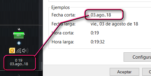

PostPosted: Fri Aug 03, 2018 4:23 am
Posts: 31
DesertDwarf wrote:
It's strange...
I can now confirm that in version 18.08 it's been fixed :D
