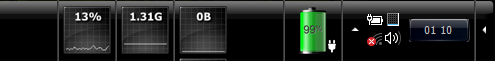

The more serious real beef here is what happens in the next image. The Taskbar has been made horizontal (bottom edge) again, and where's the other half of the NET module? There's an empty space where it should be. Yep, you can just see the top of it at the bottom edge of the bar, under the first half - in the same position it was in when the bar was vertical. (I did mention this issue before.) Again, this is theme independent. Only way to normalise the bar is to reload the theme.
Or to detach and re-attach the module. Anyway, fixed - when the NextSTART taskbar is rotated all attached modules are briefly detached and then re-attached in the correct positions. Thanks. :)
Ah, yes, of course! Anyway, excellent work Jorge. :) Now, what about the other two, if lesser, issues?

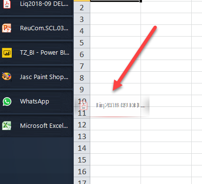

Another functional issue is that taskbar seems to have problems when doing a lot of Alt-Tab. In this image you can see a ghost of a taskbar button is created, and never vanishes... This issues is quite common...
Steps to reproduce?
Anyway, as I explained previously, major improvements work by re-direction of focus, and for now I am more focused on WorkShelf. I'll focus on the taskbar again once I have the new system with Windows 10 here (should be sometime next month, it has already been ordered, but the order includes hardware that has just been released and therefore is not easy to get your hands on at this point).
Last time I focused on NextSTART we got the dynamic Quick Launch area with overflow control, smooth taskbar animations all over, plus a bunch of other enhancements, etc... I just never focused on the vertical taskbar because very few people use it that way. Something else I will work on once I turn my focus back to NextSTART is per-monitor taskbars.

Steps to reproduce?
For instance start to move the tile and release the button halfway...

Posts: 31
Just found an easy workaround: Grab the original offending tab and make it change places with another.... the ghost tab will go away,...
Steps to reproduce?
