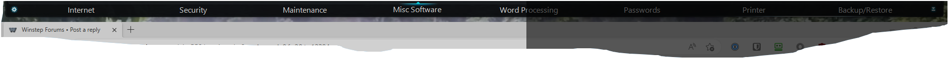

This attachment is for the normal Docking to Screen
File comment: This attachment is for the normal Docking to Screen
Ashampoo_Snap_Thursday, December 22, 2022_6h16m7s.png [ 74.73 KiB | Viewed 18828 times ]

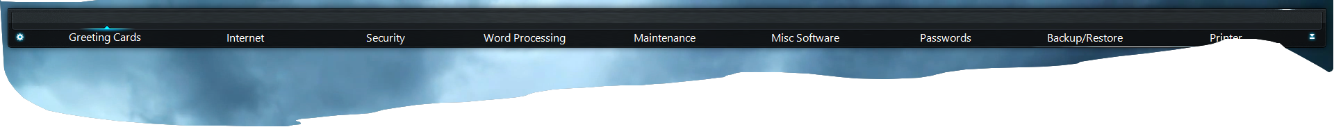

This attachment is the 2nd PC, with the workshelf low, with same settings.
File comment: This is the same upper workshelf on my 2nd PC, position is low, with same settings.
Ashampoo_Snap_Thursday, December 22, 2022_6h24m58s_001_.png [ 165.29 KiB | Viewed 18828 times ]

Apologies, the setting I mentioned is indeed related to docks but not the Shelf.
It seems to me that you might have the Shelf base showing. Open the Shelf Properties dialog, go to the Appearance tab, click the More Options button. Is the Shelf base set to 0 pixels? If not, that might be your problem.

BINGO! You are a winner! That was it, the positioning needle was 1 digit to the right, which allowed this extra room above the shelf. I really appreciate all the effort you gave into solving this for me. Have a great day and stay safe. Bruce :D
