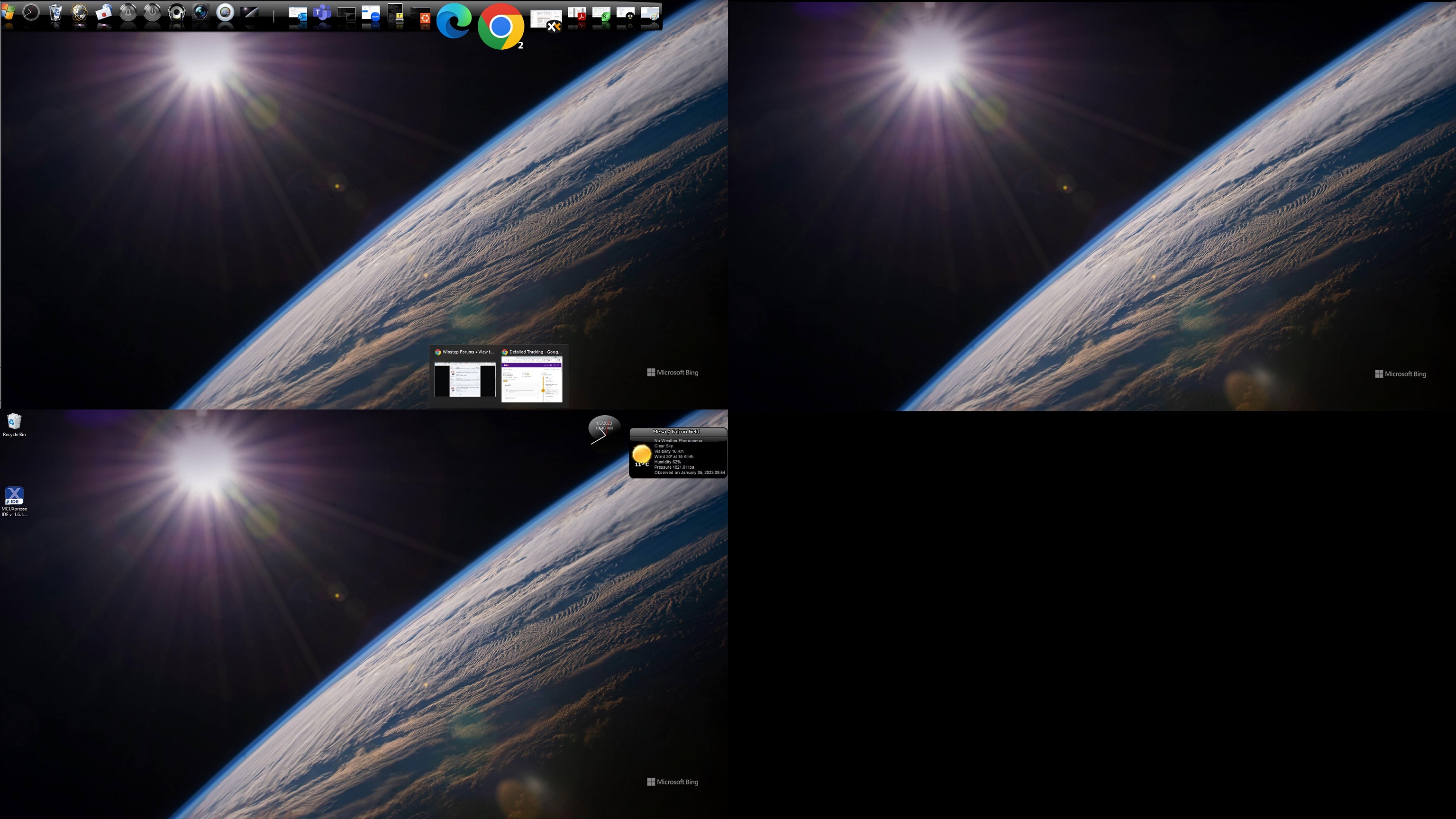

Press the PRTSCR (Print Screen) key on your keyboard when the thumbnails are at the wrong location, this should copy a screenshot of *all* your desktops (and their relative position) to the Windows clipboard. Then open a program like MS Paint, paste the image onto it, save it as JPG and post it here please.

The picture has been reduced to 80% size since the forum won't accept anything over 1 MiB.

That is, in fact, pretty weird - not sure yet what might be causing it.
What happens if you undock the dock from the screen edge so it becomes a floating dock?
Also, are you running NextSTART? Might be something related to reserved screen space.

If Nexus is undocked on the laptop screen, it will show the thumbnail just above the bar if Nexus is in the bottom half of the screen, and just below the bar if Nexus is in the top half of the screen. It doesn't show the thumbnail on the screen edge.
If Nexus is undocked on either of the two external monitors, it will show the thumbnail just above the bar if Nexus is in the bottom half of the screen, and at the bottom of the screen if Nexus is in the top half of the screen.
Also, sometimes when dragging Nexus from the left to the right screen, it will unexpectedly switch to vertical mode. (Maybe because the cursor was on the left edge when a refresh was done?)
Yes, I'm running NextStart on the left side of the left external monitor. I'm also running Shelf on the top of the right external monitor. I tried moving Shelf to the left monitor and put Nexus on the right monitor with no other WinStep items on that screen and it still displayed the thumbnails at the bottom of the screen if Nexus was docked at the top or was in the top half of the screen. I also tried closing NextStart but Nexus still showed the thumbnails at the bottom.
