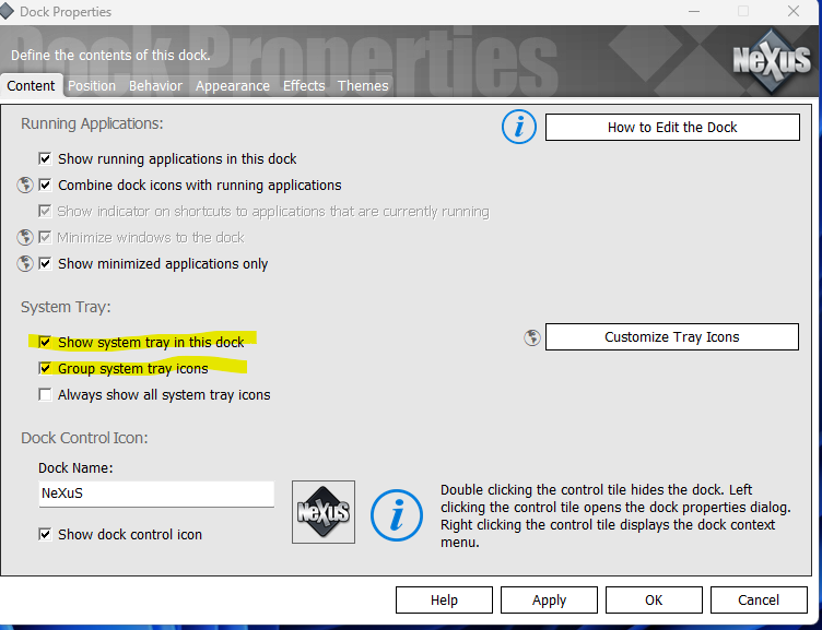

I am using Nexus Ultimate 24.4. In Dock Properties--> Content--> System Tray--> I checked
* Show system tray in this dock
* Group system tray icons
* Always show all system tray icons (Icon shows up when unchecked)
But when I click on the System tray expand button on the dock, I do not see my system tray icons, even though, they are checked to on in my Windows 11 Taskbar personalization option. Why can't my taskbar icons show up when I click on the system tray expand button?

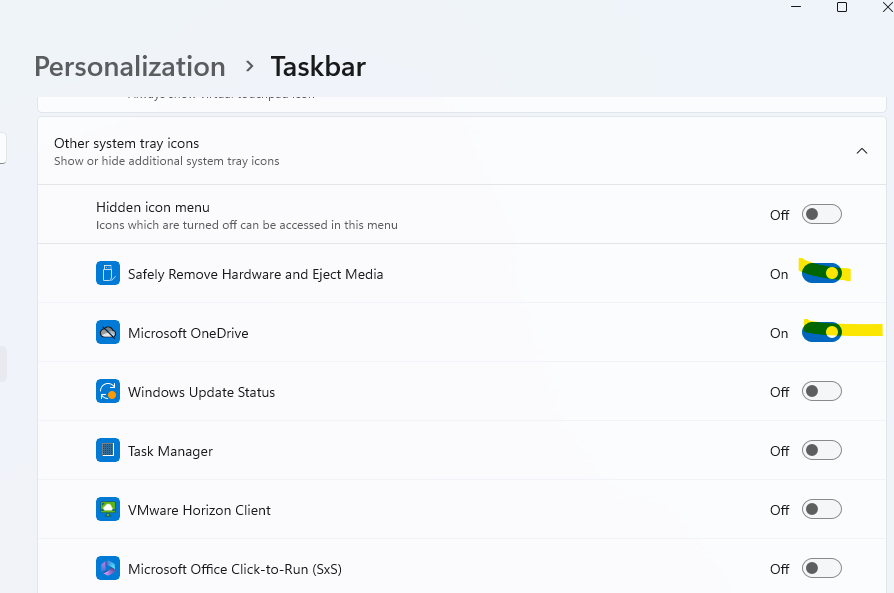

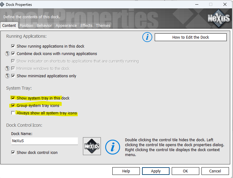

Thanks a lot for your response. I followed what you did by turning off all the icons in the other system tray icons in Personalization > Taskbar; please see below in the image. I also checked Show system tray in this dock inside the content tab of dock properties. I still do not see my system tray icons in the overflow area. Do I need to do anything in the Customize Tray Icons area shown below? I only see Windows Explorer.

Unfortunately I wiped my Windows 11 drive a while back and I am only running Windows 10 now, so I can't check my settings. The only thing that you mentioned that I believe was different on my system, was I had "Enable tray icon customization" unchecked, and under Windows 11 "Personalization > Taskbar, "Hidden icon menu" was set to on. I think turning the Hidden Icon Menu on may be the answer.

Anyway, also make sure the 'Always show all system tray icons' setting is DISABLED in the Winstep application:
