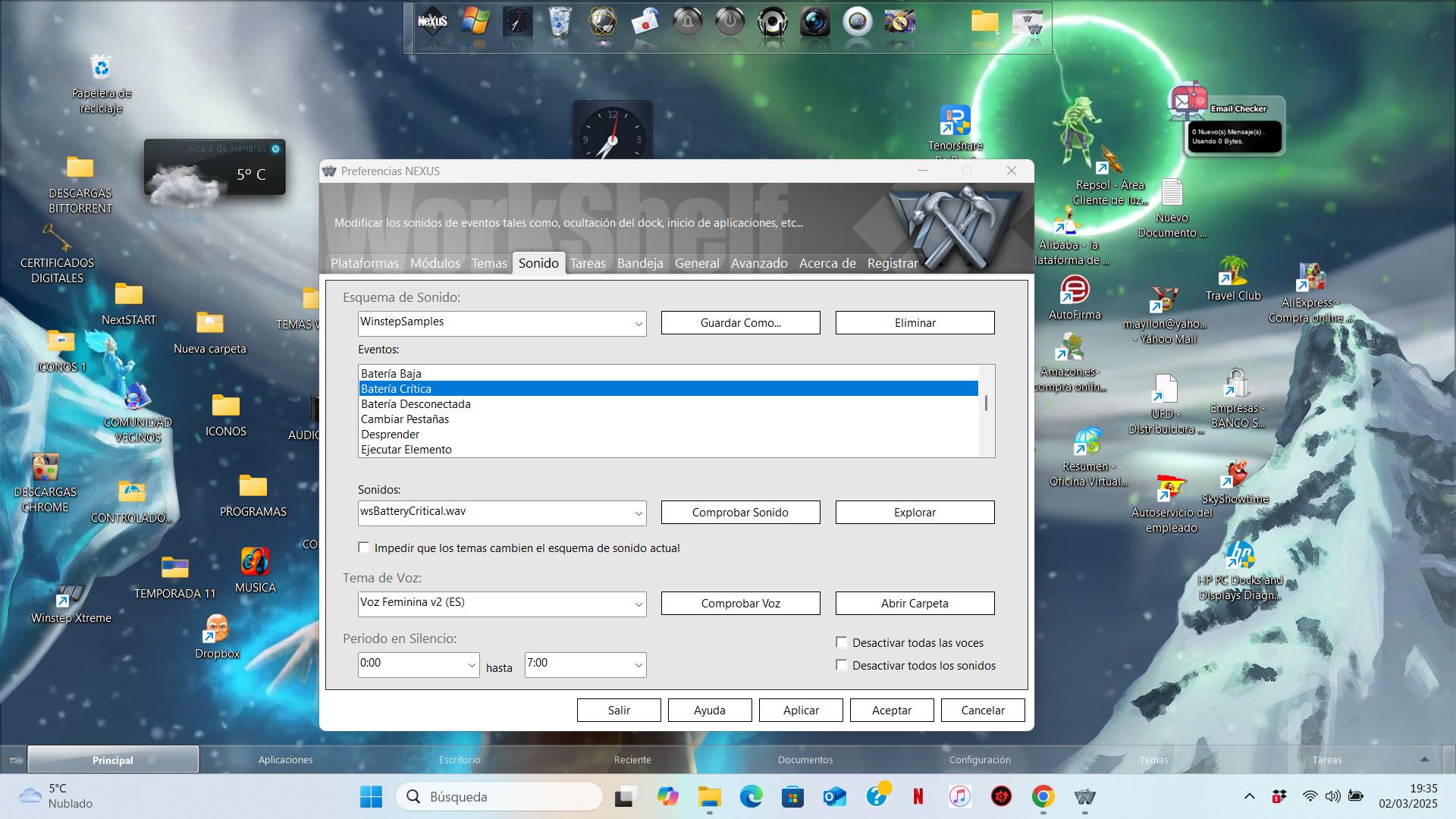

Hello, thanks for the quick response, the tab is unchecked

 Post subject: Re: Problems with voices
PostPosted: Sun Mar 02, 2025 9:17 pm
Posts: 13471
What happens when you click on "Comprobar voz" ?
What happens if you select a voice in a different language and click the same button?
Anyway, if none of the above works, the Sounds are .wav files, while voices are .mp3 files. Maybe that is the issue?

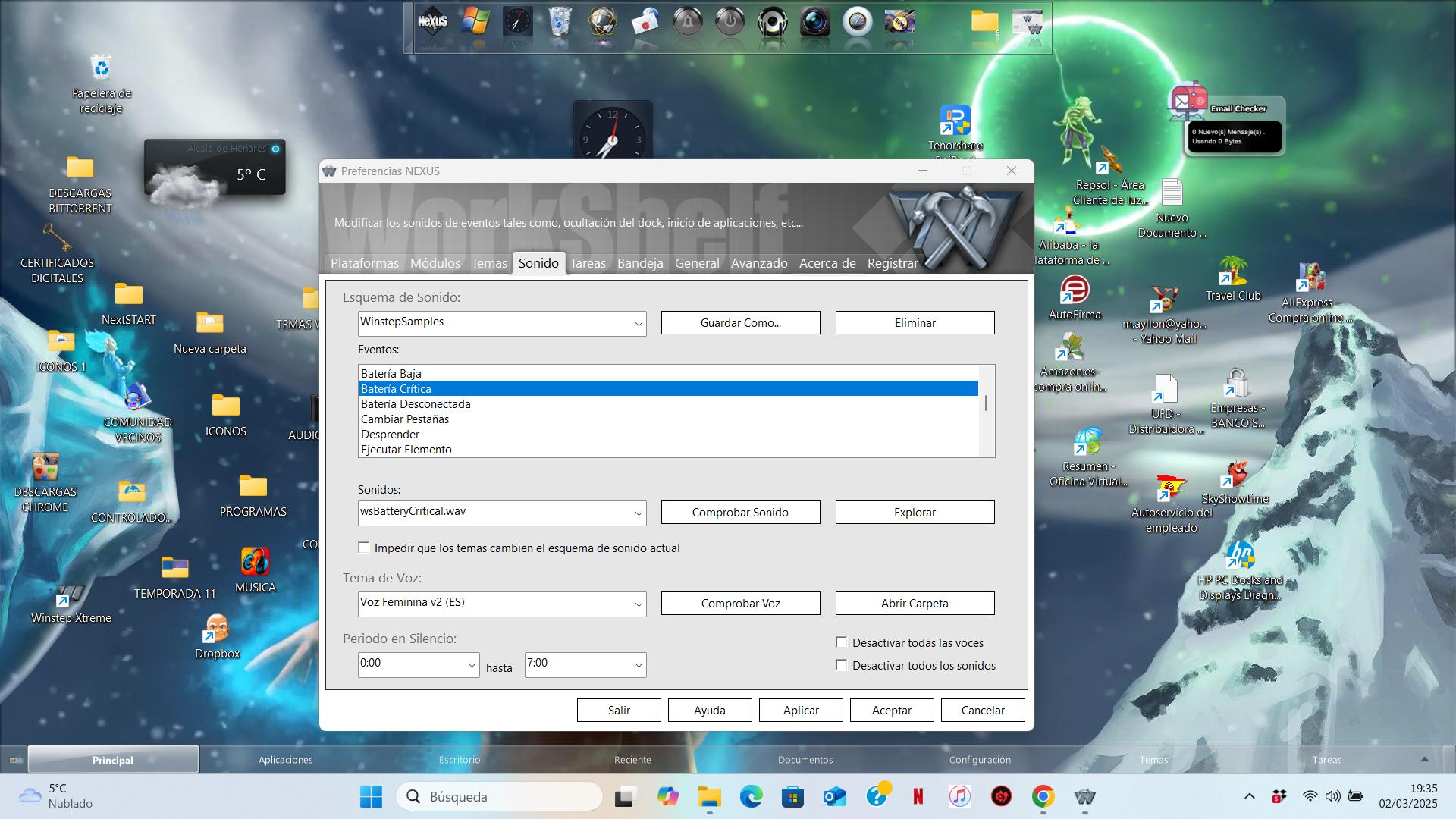

Hi again, I did what you told me, I checked by changing voices and none sounded and the sounds did also I changed to MP3 and it seems that it does not recognize them because when I do the search it does not find them, because when I search for Media Player I cannot find where it says media, I put capture again, thank you very much for the involvement and the speed in solving the problem.

Sorry, I'm sending you the good screenshot

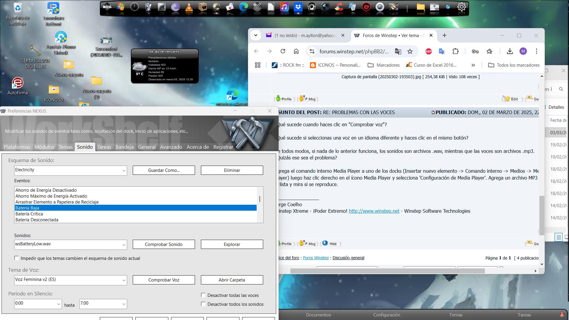

Hello again, I followed your advice and for example I checked the low battery voice and yes I can hear it but when I try to check where the female voice is, I press check and nothing sounds, nothing, I press to show the time on the clock and it still doesn't work, I tried several things and nothing, I can't get it, I don't think it's because I haven't renewed the license, I'm trying to fix it first, anyway, thank you very much for your involvement

Yes, the license expired on October 24th, the only thing I did was change computers and on the new one I installed the program from a backup that I made and the voices stopped playing. I uninstalled it and reinstalled it from scratch but nothing remains the same and regarding the file type of the voices I open the folder and they are mP3
