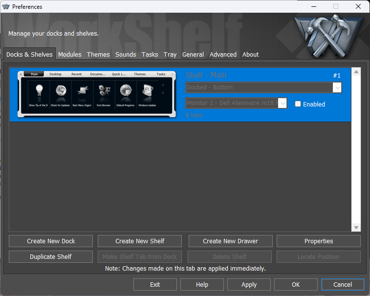

Hello again!
So I purchased this to replace an aging Rocket Dock since rocket dock is no longer supported and hasn't been updated in years. I initially did it with sub-docks as I wanted to mimic the fan function of Rocket Dock and that worked well.
I have a bunch of games installed (like 30+ shortcuts). In Rocket Dock you have a maxium of 12 icons that can be shown in the fan mode, so I had these shortcuts spread out between several items to show all of the shortcuts. This translated into several sub-docks in Nexus.
I wanted to consolidate them into one sub-dock, but then the vertical layout was exceeding the space available to display all of the icons. So I was trying the grid stack item in the dock. As I finished moving items from a sub-dock to the grid stack, I was deleting the sub-docks. This worked for the first 2 sub-docks, but the third one refused to be deleted (the command didn't appear to have any effect). I moved the last few icons out of the 4th sub-dock, and then when I tried to delete it the entire dock just disappeared.
I tried a couple of reboots, but it hasn't come back, although the Winstep taskbar replacement is working just fine. I tried looking in the preferences and the dock isn't even listed (see screenshot). Is there a way to recover the other dock? It took me a few hours to set-up and if there is an easier way I would like to use it instead of having to re-do it. Sorry, I didn't do a backup, I wasn't even aware of that function until I started trying to troubleshoot this.
Thanks,
Simon
File comment: Winstep Preferences
 Post subject: Re: Recovering a crashed dock?
PostPosted: Tue Dec 30, 2025 3:27 pm
No backups? Ouch.
Not sure it isn't too late to recover, but let's try this:
First make sure you are running the latest version, v25.9. Now, in WorkShelf Preferences, go to the Advanced tab and make a Backup. Once it has finished, click on the Troubleshooting Options button and on the dialog that pops click the Check Integrity of Docks and Shelves.
What does it say?

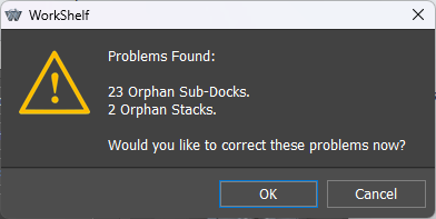

PostPosted: Tue Dec 30, 2025 9:13 pm
Joined: Thu Dec 25, 2025 6:57 pm
Posts: 8
And to be clear, you obviously did nothing wrong, what happened is 100% the program's fault (and I would very much like to be able to reproduce it here so I can fix it, nothing worse than data loss).
A lot of work was put into v25.7 to make sure you could move items between different nested containers at will, delete shelves, docks, sub-docks and grid-stacks without issues, etc, but because this is all very complex stuff the potential for unforeseen issues is always there.
No worries, I appreciate the work. Sorry, I had to run some errands. The recovery found 23 sub-docks and 2 stacks, which really sped up the recovery process. I made sure to back up the results this time. :)
Thanks again!
PostPosted: Tue Dec 30, 2025 9:27 pm
23 orphan sub-docks?! Wow. Did you really had that many or is that the result of other deletions?
Would you mind sending me the first backup you made (before the corrections) to the Winstep support address? Would like to take a look to try and understand what happened, so I can fix it and it does not happen again.
PostPosted: Thu Jan 15, 2026 4:15 pm
Zealott wrote:
I actually had a few more before I started moving things into grid stacks. Probably 5 ish more. Sent the email.
Unfortunately I was unable to reproduce the corruption here after recovering the sub-docks from your backup into the recovery shelf and adding them back to a dock. Was able to then delete all of them one by one without issues.
Perhaps the structure corruption happened while you were originally populating all the sub-docks and only reared its ugly head when you started deleting them.
